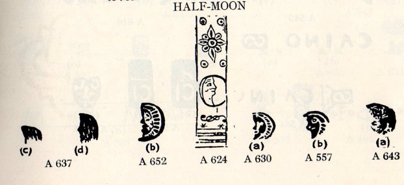

I thought i would give here some food for thought, on what concerns the half moon symbol applied by early Spanish sword smiths in their sword blades.
When researching on this subject in the course of a thread submitted by Lean-Luc (Cerjac) for comments on one of his swords, i came across citations of Spanish Scholars on a early, such as contemporaneous, personality (Jehan Lhermite) whom, along his Castillian Spanish travels made encounter with sources in Toledo, that provided him with a detailed description of early sword smith Masters, their works and their marks.
http://www.vikingsword.com/vb/showpo...1&postcount=32.
What i here pretend to focus on is, the half moon symbol (mark) which the author mentions as having been a mark used by Master Juan Martinez in his blades.
The description reads, in a non sworn translation that, he used to put his name in the blade fuller and, while not in the sides of their ricasso, with a fleur-de-liz mark topped with a crown, which is the oldest one because after, together with this mark he puts a half moon, with a "rostrillo" formed inside it.
We know that the rostrillo is/was an adornment used by Spaniards to embellish the head of images of the Virgin Mary, aledgedly inspired in widow veils which, with not much effort, we can discern its part section inside some half moon variants we see in exhibited or registered blade marks out there.
We are aware that Sir James Mann, in his Wallace Collection catalogue, only points out two of several half moon marks in its contents as been connected with the status of Espadero del Rey, an assumption not subscribed by the Spanish scholars we managed to contact. On the other hand, when we try to figure out why Thomas Mann only selects two of all catalogue cases as been those appointed, we can not find solid consistency in such half moon examples being those with the rostrillo, as to distinguish their differentiation with the countless 'plain' half moons used by blade smiths of many nations.
One wonders the reason why these symbols, eventually in their specific rostrillo design, are forcingly connected (by Thomas Mann) with the espaderos honoured with the Royal appointment and, if so, why this duality is not recognised by other authors, namely those from Spain.

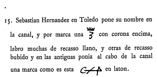

If we have a second to look to the notes of JOSE MARIA PELAEZ VALLE called COMENTARIOS METALÚRGICOS A LA TECNOLOGIA DE PROCESOS DE ELABORACIÓN DEL ACERO DE LAS ESPADAS DE TOLEDO DESCRITAS EN EL DOCUMENTO DE PALOMARES DE 1772, we may catch that, among Palomares dual position in that, in one hand, he rejects the mystic of the Tagus river being the explanation for Toledan swords quality, rather than the competence of their smiths forging techniques, soon after he romantically points out the gold particles in their sand melting to a fine varnish that impeaches the sparks escaping from the steel spirit, we carry on reading the above author's chronicle in that Palomares work is neither definite nor complete in that, for one, he fails to mention that Juan Martinez (el Viejo), used a contrast of a figure looking like a fleur de liz, with examples in the Dresden Museum, inventory numbers bla and bla.

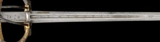

Aun así, el trabajo no es definitivo ni completo; piezas auténticamente inequívocas portan hojas de espaderos famosos referenciados en la tabla con marcas distintas a las que figuran en la misma .
5 - Un simple ejemplo: Juan Martínez (el Viejo) usaba un contraste de figura parecida a una flor de lis que no aparece en la tabla de Palomares. Ejemplares de la colección Dresde HMD VI/306, INV 1606 y HM D INV 1832 I 170/17.
Now, this fits precisely into the description of Jehan Lhermite in his "Passetemps". Once this being the smoke caused by fire, we keep on hammering on this path and, going deeper into the magnificent Met sword already posted in Cerjak's sword thread, we find a set of marks of Juan Martinez that are very elucidatory:

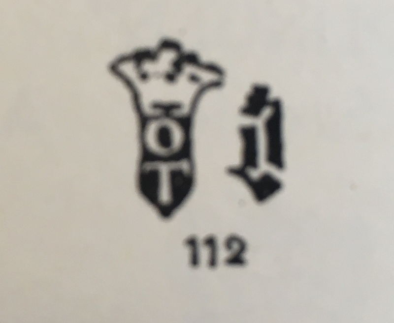

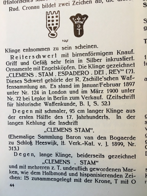

Marking: On the ricasso, the following Toledo marks: a crowned T repeated six times; a half moon repeated four times (and twice again at the end of blade grooves); a crowned fleur-de-lis repeated four times.
. Then we proceed digging into the Master's work spread out there and we find the following article by LECH MAREK, called RAPIERS BY JUAN MARTINEZ THE ELDER – THE ROYAL SWORD-SMITH FROM TOLEDO FOUND IN POLAND, including some the swords forged by the Master, and which presents us with outstanding revelations, such as, the half moon being an individual mark, the To being the Toledan export mark and the fleur-de-liz being the mark of Espadero del Rey. Interestingly the half moon depicted in the illustrations has a slight rostrillo inside it.
So it looks like a fait accomplis that Sir James Mann inference on the half moon's attribution is more of a silogism that lacks foundation. But now we have the fleur-de-liz being the newly appointed star. May this one make more sense ... knowing that this is a symbol of the Royal Bourbon Family, still figuring in the Coat of Arms of Spain.

Returning to the dilemma of the half moons, we look to find what meaning or significance these distinct markings may have had to the Spanish smiths.
We well understand that there are many ecclestiastical symbols, inscriptions and devices incorporated into blade motif and imbuement.

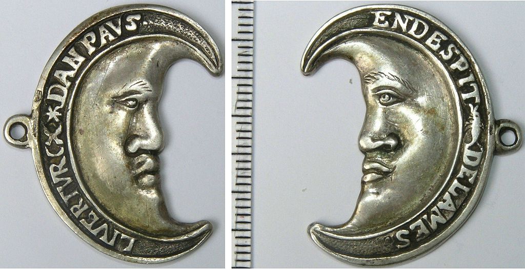

In study of the half moon historically, the face has typically been represented as the 'man in the moon' despite the fact that astrologically it seems that the sun (solar=male) while the moon (luna=female). With that it seems that technically the representation of the Virgin Mary, with the notable and traditional rostrillo, makes good sense (and of course as noted by the Spanish scholars) and has been as far as I know, entirely not known to most scholars on arms outside of Portugal and Spain.
In a most interesting circumstance pertaining to the half moons, some time ago I found reference to its use in Holland as a symbol for the notorious privateers known as the 'sea beggars' or 'waterguezen'. These were primarily associated with Calvinist Dutch nobles who from 1566 onward vehemently opposed Spanish rule in the Netherlands.
They contrived the use of the half moon with face to allegorically suggest it was better to be in league with the clearly contrary Turks than to be under Spanish suzerainty.
At this time the crescent moon was considered representative of the Turk, and in 1570 a medal was designed with the half moon emblazoned with the motto, which is worded essentially 'rather Turkish than Papist, in spite of the Mass'.
It seems odd that the Dutch used this symbol, it would seem almost inadvertently as far as the Turk analogy, while here it seems to have been of key religious significance to the Spanish, who they were opposing.

Here we see the appearance of the crescent moon, or half moon with face, being applied on blades in Germany by the beginning of the 18th century and likely earlier. As we have discussed, the use of the crescent moon seems to have evolved in Spain and used in yet undetermined significance on sword blades at the time of the great Toledo masters.
I recall years ago thinking almost fancifully about the similarities between many of these 'faced' half moons used on blades and in other 'magical' motif including some seen in the unique tarot 'moon' cards. I found that the tarot cards, indeed used in various countries in Europe, did have use as early as the 14th c in Spain. These were soon prohibited however in the well known religious events of the times, though covert use certainly prevailed. While unclear on the 'artistic' nature of the illustrations used, the crescent moon was of course in some manner portrayed on the 'moon' card of the sets.
What seems key here is that the 'man in the moon' portrayal of the crescent moon (paradoxically with the female moon association normally observed) seems to have filtered into the theme at some point. It is known that Jewish mysticism, of course with its mysterious cabala, was profoundly present in Spain, and it may well be that this symbolism had some degree of influence in the character of these half moons .
Although the nature of these suggestions may seem fanciful in their nature it must be remembered that in these times, magic and superstition along with many notions and beliefs were very much in place.

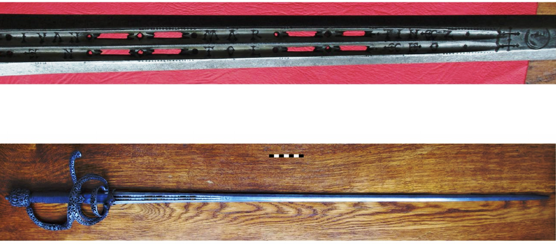

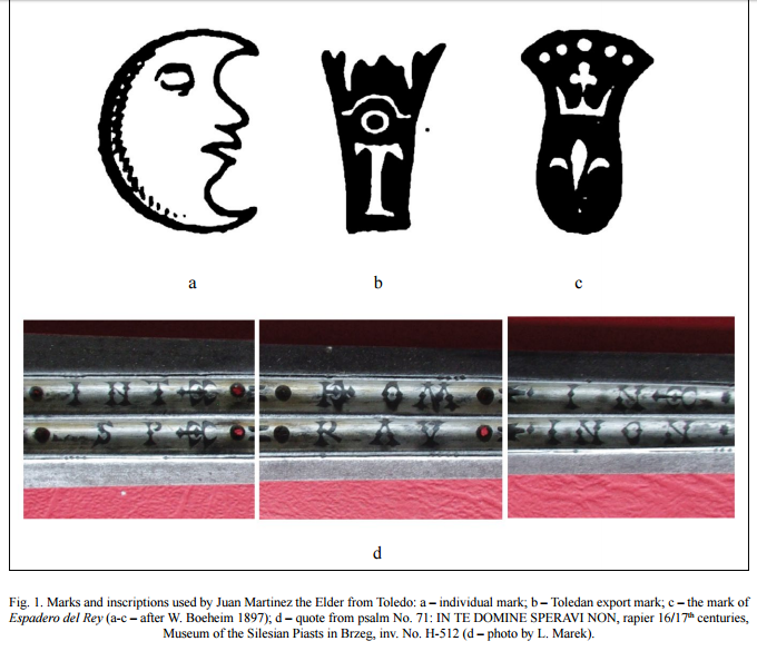

In the study made by Lech Marek we may see that Juan Martinez, certainly as many others, applies religious inscriptions in his blades, apparently not for his introversion but more on the talismanic perspective, as so often this kind of habits is dicussed. In the blade example shown above he quotes psalm No. 71: IN TE DOMINE SPERAVI NON and, as mentioned, when having space available depending on the type of blade he forges, he inscribes the other part CONFUNDAR IN AETERNUM ... if i am correct.
For those no bothering to consult Lech Marek's work, nevertheless a very succinct paper, not so exhaustive as that of del Canto, where you fall asleep before you find what you are looking for, i here upload one of Master Juan Martinez magnificent blades, mounted in a beautiful chiselled iron Dutch renaissance hilt ... and also pictures of where the surviving punzones de espadero are kept, in Military Museum at the Alcazar de Toledo

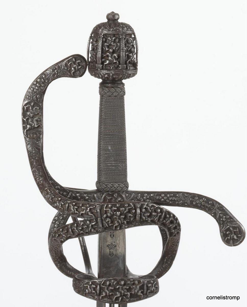

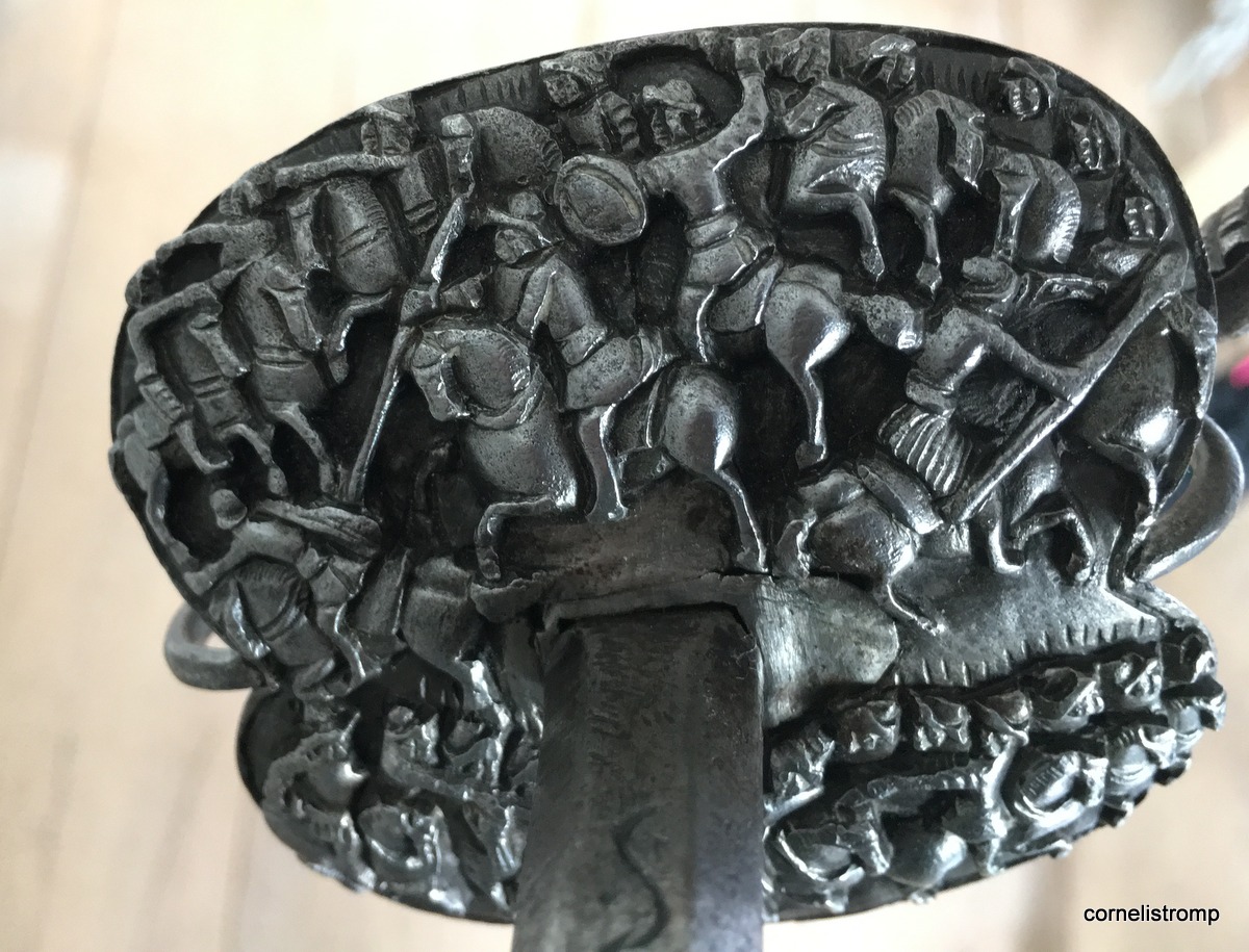

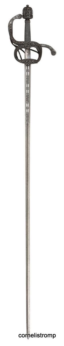

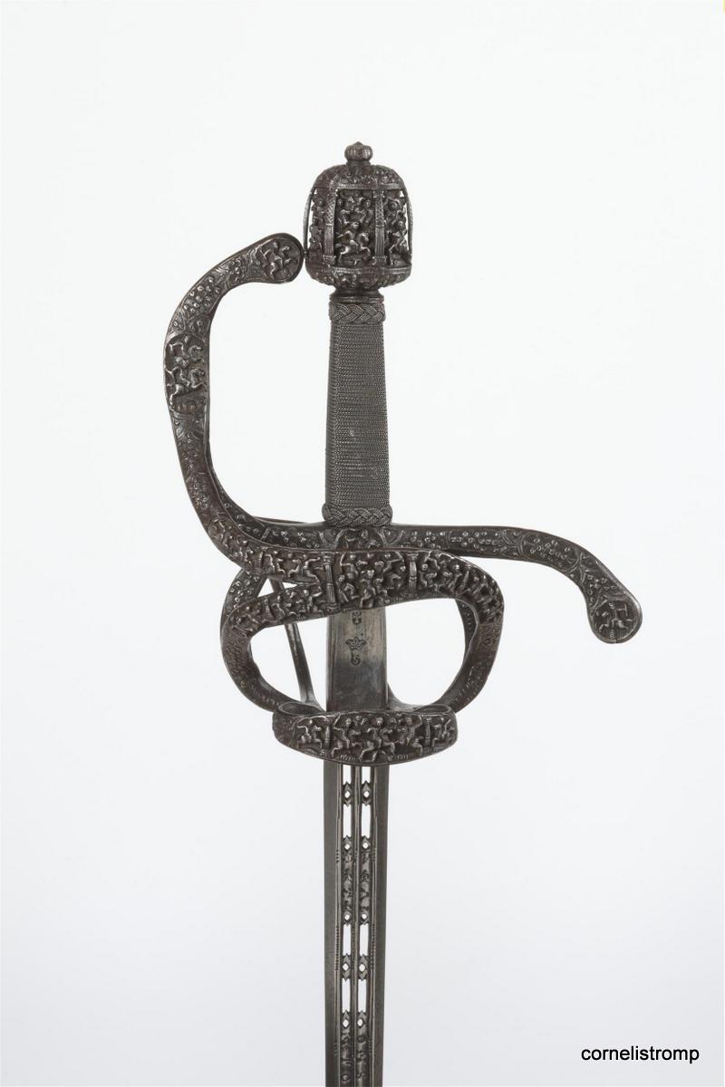

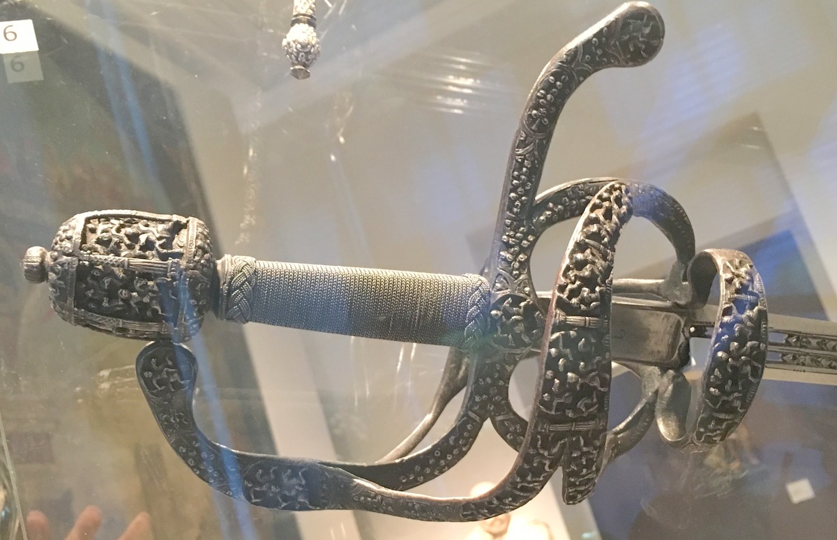

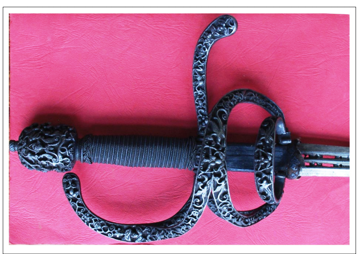

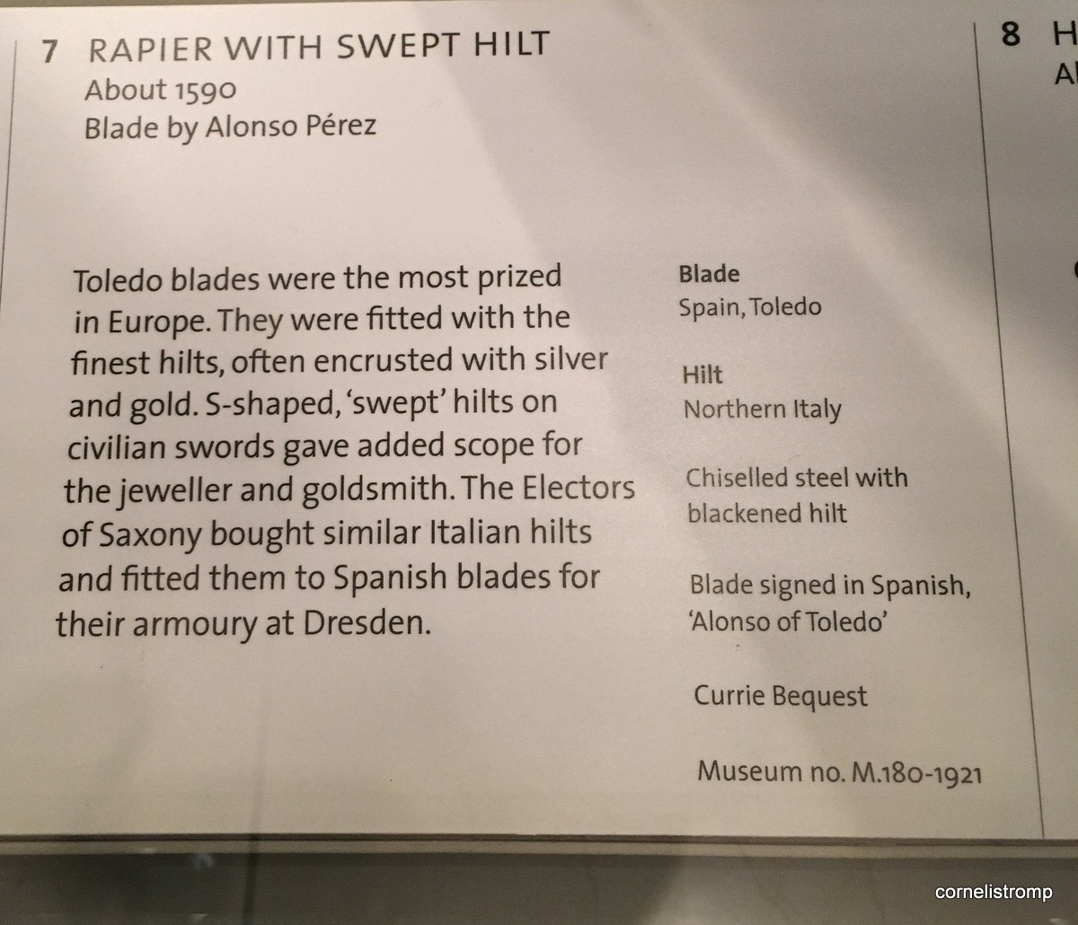

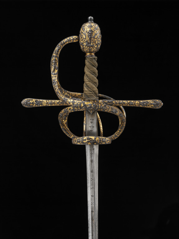

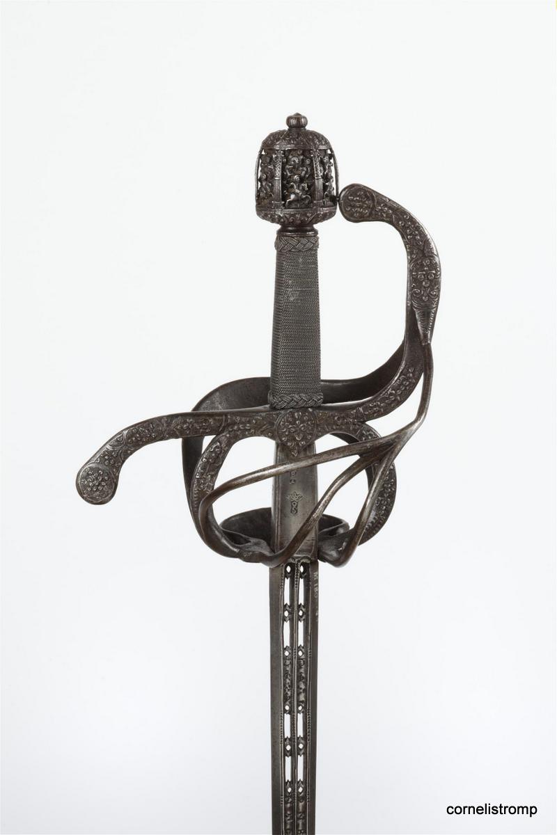

The hilt of post #7 can be Italian I/o Dutch.

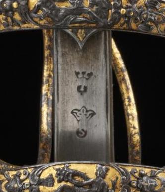

see, for comparison, a rapier at the V & A museum from the armoury of the Electors of Saxony.
The Hilt is probably from Italy and the blade is an export blade from Toledo.
it's hard to say where these type of hilts are made.
from the V&A description:
The blade is a high quality Toledo blade by the prestigious maker Alonso Perez. Perez worked at the shop of the famous swordmaker, Gil de Almau who produced several swords for the Emperor Charles V and his son Philip II of Spain.
Sword blades were articles of international trade, made in a few important centres and shipped all over Europe where they were fitted with hilts in the local fashion. During the 16th and 17th centuries the sword blades of Toledo, Valencia and Milan were the most sought after but the largest centre of production was the German town of Solingen. The finest hilts were usually equipped with a Spanish blade but if not available a German blade (sometimes with a spurious Spanish inscription) was fitted instead.
fe this is probably the case with the German blade? of the Rapier of Jean-Luc
http://www.vikingsword.com/vb/showthread.php?t=22366

Hi Jasper,
It is good to have the top brass entering in this thread, which means this has some interest in arms study.
You have noticed that, the asumption that the hilt shown is Dutch, is one from Lech Marek in his mentioned work; i wouldn't be able to judge it by myself. Mind you, he mentions Dutch style; maybe this makes the difference:
Fig. 5. Chiselled iron hilt of the rapier from Fig. 4. Dutch renaissance
style. Photo by L. Marek.
Yes, the 'Calle de las Armas' and the tests the smiths were submitted, as already approached in the same thread you linked to the Jean-Luc rapier discussion.
http://www.vikingsword.com/vb/showpo...2&postcount=28.
Every 5th March two examiners and two observers would perform such exercise, visiting candidates in their shops ad workshops.
But it is interesting that you show that beautiful sword with an Alonso Perez blade, as we here again face the dilemma of the marks discepancies. If my eyes don't betray me there is a clear difference between the mark engraved in your sword and that recorded by Palomares in his nomina. I wouldn't at all dare pretending that the blade you post was not forged by the illustreous master, but then, we may stand before another of these recurrent riddles.
However if i am wrong, which i am ready to admit, please bother correcting me .

Hi Fernando,
I wish that rapier was mine
it is one of the nicest swords in the Victoria and Albert museum.
and.....believe me, there is very small chance that there is something wrong with the allocation of the blade.
(this description is made by Claude Blair, not the first best.)
please see
http://collections.vam.ac.uk/item/O9...-alonso-perez/
best,
jasper
PS : Lech Marek is from Poland and I'm Dutch

The article by Lech Marek is outstanding, and thank you Fernando for pointing it out. It does seem compelling in noting the character of the markings used by Juan Martinez, a noted and renowned Espadero del Rey.
It shows of course the half moon as his personal mark; the TO (which is an 'O' over 'T') as the Toledo export mark and the fluer de lis as the 'mark of the Espadero del Rey'.

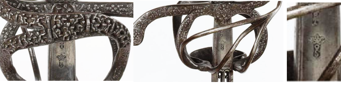

In looking at this rapier from the Victoria & Albert, it does seem curious that the mark for Alonso Perez, an S apparently topped by an 'O' and crowned does not match the punzon shown in the Palomares nomina. Perhaps the reference used by the V&A was from one of these other sources we have discussed?
If the late Claude Blair was the author of the assessment of this sword, I would definitely consider it sound. This man was one of the most resounding authorities in the arms and armour world, and was cited personally as a source in more articles, books and references than I can even list.

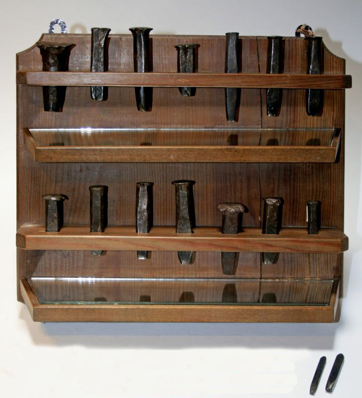

In looking at Palomares chart, it seems there are so many duplicate punzones, for example the shield with crowned S (as noted for Perez) has 6 other similar examples with only subtle variations in crowns.
Ironically 4 of these are for the Sahagun's, another highly purloined name of Toledo, as well as the one for Juan Martinez!
Another thing I am curious about is why the TO always appears as OT (the over the T) and in the Perez example with S, it is topped by an O in the same manner.

the one you posted has the same OS mark but as inscription the full name OF Alonso Perez;
A.L.O.N.S.O. P.E. on one side
R.E.Z. E.N. T.O.L.E.D.O at the other side.
The style of horsemen on V&A rapier came 60 year later on equestrian small swords of around 1650.
they have a similar chiseled style with horsemen cut in high relief and were used extensively in the Netherlands.
however, it is not known where this type was made, perhaps by the medal cutters in Paris because of the very high and detailed quality work or maybe in liege. attached an equestrian hilted small sword from my collection
best,
Jasper

So why OS?
And why is the TO seemingly reversed (if it is to mean Toledo)? on the so called Toledo export mark as shown in Marek.
Old 5th March 2017, 05:09 PM   #16
Jim, i am glad that you stood with me in the Alonso Perez mark enigma, as to comfort me for not having visions, something potential with my pharaonic age.
As for the Toledo punzon, Jose Maria Pelaez Valle questions himself on this issue and takes a guess that the different positions ot the two initials and their shield could indicate the different period (year) in which the blades were produced, like in silver hallmarks of certain countries; as also that the non applying of such TO mark in blades could mean that some masters were so reknown out there that they would see no need for such quality contrast.
It is a fact that, the abundance of the letter S on smith's marks which names appear not to contain such letter, needs some enlightenment; other than the fact that period Latin phonems could cause erroneous situations, besides cultural perceptions. Remember the great master Tomas de Ayala was illiterate. On the other hand and subject to double check, marks being usually correspondent to the initial of the first or family name, were not necessarily so; allegory to the smiths place of origin (toponimic) could also be taken into account. It seems as the S for the Sahagun family was so attributed because they actually were from Sahagun.
Old 5th March 2017, 05:30 PM   #17
cornelistromp
cornelistromp's Avatar
Join Date: Mar 2009
Posts: 1,071
So why OS?
hi Jim,
I do not understand the question, can you explain it please?
Is The question why Alonso Perez used OS ?
best,
Jasper

Originally Posted by cornelistromp
... Now it is clear to me why the first rapier is attributed to Alonso Perez while there is only ALONSO EN TOLEDO as inscription on the blade (no PEREZ)...the one you posted has the same OS mark but as inscription the full name OF Alonso Perez;
R.E.Z. E.N. T.O.L.E.D.O at the other side...
Yes Jasper, the second example having the full name makes it clear that both blades were forged by the same smith. Now we only ignore the reason why he apparently changed his mark... and why in both cases he uses the letter S. If it weren't for the discussed S 'mania' and trying to unveil the criteria used by (Toledan) smiths in their names, the little o over the S in the the Vitoria examples might be that of ALONSO and the vertical line crossing the S in Palomares nomina could be the l of ALONSO. But this only giving wings to imagination.
... attached an equestrian hilted small sword from my collection...
Superb .
I tell you what; next time you come over to the peninsula for kite surfing you bring this one with you for, say, your self defence ... and tell me which hotel you will stay at .

as known, some German blacksmiths from solingen used hispanicized marks.
For example, Clemens Stamm used the toldedo mark and an IS crowned together with the crescent. see nr 45,107 There is even a rapier described with a Spanish inscription
CLEMENS.STAM.ESPADERO.DEI.REY. ( A. Weyersberg solinger schwertschmeide p.44)
Clemens Tesche used crowned S, Peter Tesche a crowned B and Toledo mark, the crowned OT. etc. see nr111,112
It seems that for geographical determination, a mark in itself has subordinate value and should always be considered in conjunction with the inscribed name of the blacksmith.
best,

...Another conundrum is with the number '3', which occurs in a number of them. I have seen no adequate explanation for this one...
And ... is that a (number) 3, Jim ?

as known, some German blacksmiths from solingen used hispanicized marks... It seems that for geographical determination, a mark in itself has subordinate value and should always be considered in conjunction with the inscribed name of the blacksmith...
Absolutely, Jasper.
Actually the inverted stiuation, as you know, is also not reliable. Often we see blade smiths name inscriptions, some times even 'supported' by the To symbol, that are a fake; Ayala, Sahagun and other.

The number 3 seems to appear in a number of the punzones, but indeed, the character may be a letter in the calligraphy of Spanish dialects or geographic and period references. Again, I hope you might set this straight.
Curiously, the numeric three in various symbolic application is believed to represent the Holy Trinity in Christianity as well as the Holy Three in other religions symbolism. I have even seen the number '3' standing alone on some western blades.
Palomares is a good starting point, but it must be remembered that the Toledo blacksmiths use multiple marks while Palomares has only indicated one.
Palomares has made the list in 1762, by then the heydays of blade making in Toledo were over.
Actually there were hardly blades made in Toledo in the 18thC anymore, it was almost all taken over by Solingen. The newly established fabrica de armas in Toledo did not change this.
Furthermore there has no proper investigation done by Palomares. There is no indication when the blacksmiths have worked in Toledo, mentioned By Palomares under the chart list of names .
He has only listed 5 names with a year.
there are 99 marks and only 94 names, multpiple times; el viejo, the elderly, el mojo, the younger, son and brother are used.
A blacksmith who worked outside Toledo is also mentioned, labro tambien en Gordova and the same mark is given to two persons 65 and 66 ??
Pedro Hernandez, Juan Hernandez and Piedro del Monte are missing from the list, as are some German blacksmiths who worked in Toledo. Heinrich Col fe.
nr 13 nr 15 and nr 23 have only the Toledo town mark as their mark, this is probably a mistake ?
TBC
best,
Jasper

Well Fernando, for not being a fan of esotericism.......on the solution for the crowned '3' (as I was seeing it) actually being a calligraphically embellished 'Z' ( as Sir James Mann had specified, 1962)........as they would say here in Texas....'ya done good!!!
The 'Z' as a toponymic for Zaragossa, as noted a key location for these masters outside of Toledo seems very well placed.
With the fluer de lis, it seems that was mentioned in discussion on Juan Martinez as being one of the multiple devices on his blades, along with half moon and crowned T (from Valle and Marek). I believe it was Marek who regarded the fluer de lis as associated with Espadero del Rey as it was of course the roya symbol of the Bourbon family.

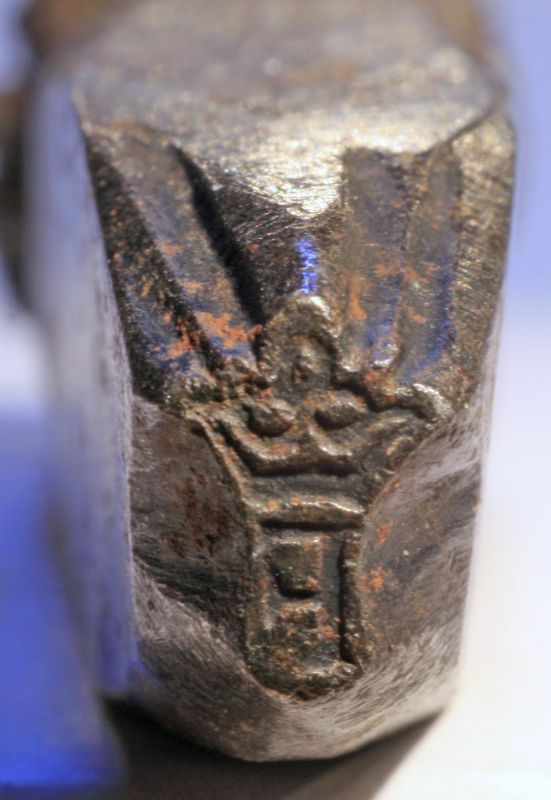

Jasper,
Thank you for the scans of the detail on Clemens Stam and the marks used by them in Toledo.
The one (I think it is for Stam) which is a kind of grated image......would that be a portcullis?
