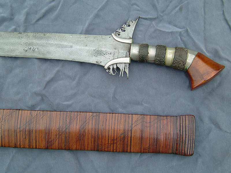

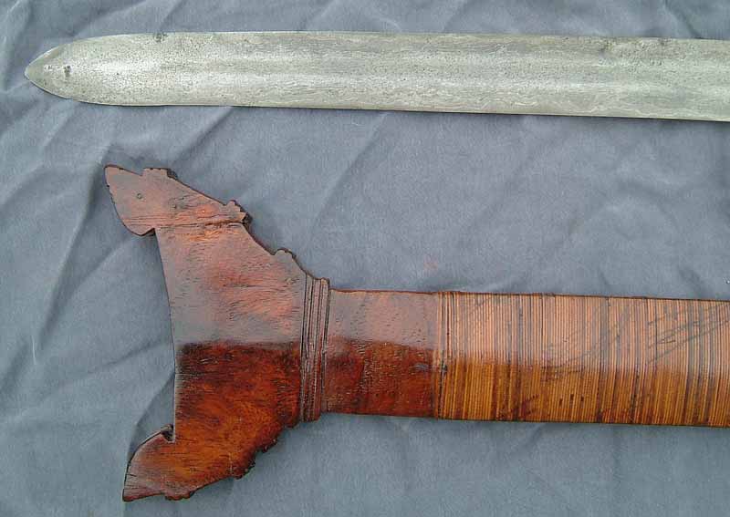

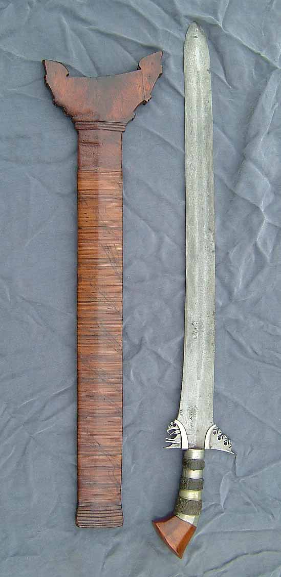

I just received this sundang today. It's not particularly old, having a gangya that is not separate. But the condition is very good. The blade has a blue patina that is beautiful to me, almost like an old firearm. It's not rare, but for a new collector like myself, it's one of my better pieces.
The thing is, I love to etch blades. Finding that pattern welded steel is such a rush, like......well let's just say it's fulfilling! But this one has no rust, and no reason to clean it from a conservation standpoint. It's in fine polish, having been coated in grease, from the looks of it.
The rattan has a few pieces of the old cellophane tape on it. I'll remove that and tack down the loose pieces with a tiny drop of superglue underneath the loose rattan. Cleaning and some rennaisance wax will take care of the scabbard.
The hilt is wrapped with sennet cord that is just a tad loose. Should I put something on it to stabilize it? Pitch maybe? Or again, do nothing?
But the blade. I'm leaving that alone. It just feels wrong to do anything to that lovely blade. She's staying just like she is, oiled and sharp. I know there's beauty underneath, but to find it would be like lifting a ladies skirt. Just wrong.
More pics for anyone interested at http://photobucket.com/albums/v163/s...ublic/Sundang/
Thanks,
Steve
Old 1st June 2005, 01:04 AM   #2
Posts: 6,441
Cool My Opinion ?
I have a very similar piece (straight blade) with the exact style of decoration burned onto the rattan wrap ; looks like seagrass waving in the tide doesn't it ?
I know it's hard to resist but leaving it be is the best decision .
Try a Elmer's type glue rather than a resin glue on the wrap ; wipe off the excess with a damp cloth .
It's a beauty just as it is .

Steve:
Very pretty kris. Are you sure that the gangya is not in two pieces? I know that the distinction can be tricky to detect to determine. This sword is much nicer than the usual 20th C. one-piece constructions. Sulu in style, including the scabbard, but a heavier blade than most Sulu kris.
Where did you find it?
Ian.

Very nice kalis taluseko ! As for the hilt, I'd leave it alone unless you plan on actually swinging it around frequently. Use pitch if that's the case. Nice find!

I thought from the title this would be a much more broadly construed thread....It's certainly hard to tell from a photo a faked ganga line from a real one. It does look like a real one though. In any case, as others have mentioned previously, there is a certain number of 19th c. well made kris sundang without gangas (and same for k(e)ris). AFAIK the reason/explanation behind this is not known. I'm no expert in the matter, but I think that the shape of the waves, etc. can be more telling.
I think that in the close up of the tip I can see a sandwich type lamination, which is usual.
Phillip Tom doesn't seem to be here, so I'll be the one to mention that the groove grinding looks a bit crude/unsteady. AFAIK this is not a sign of moderness (or of oldness).

Rick, Thanks for the tip on the glue. I'll take your advice, and do the minimum.
Ian, the line marking the gangya is chiseled in. It came from Ebay http://cgi.ebay.com/ws/eBayISAPI.dll...MEWN%3AIT&rd=1
The fact that no one I recognized bid on it worried me a little, but it turned out great. It's very similar to another piece that I got a while back. A picuture is here http://photobucket.com/albums/v163/s...isoverall2.jpg. Thanks for your insights.
Zelbone! Thanks for the tip. I'll probably leave the hilt alone, as the wrap is tight enough for casual handling. It's just that one thing I require from any piece in my small collection is that it is functional. Thanks.
Tom, I didn't mean to mislead. Those were just the issues I was thinking of when I wrote. It would be great if this thread would broaden to discuss conservation in general. The gangya is definitely one piece with the blade. But the workmanship as a whole looks very good. The fuller looks like it was ground in with a wheel, then finished with a coarse stone. Thank you for your comments.
One thing I noticed is that it's a differnent "hand" than my 2 other sundang that have scabbards. This one looks "right handed". Made to be carried on the left side of the body, with the decoration facing outward, and drawn with the right hand across the body. The other two are opposite.
Thank you all for your comments and insights.
Steve

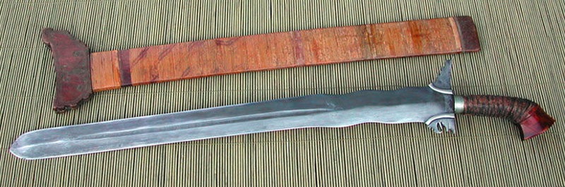

I had to haul out my example of this type .
Note to Steve , fish glue is even better than Elmers as it is water soluble and can be totally removed if needed .
Anyway , you can see the design on the scabbard and the blade pattern ; the forging and file work do not compare to Steve's but I will say that this kris is the sharpest of all that I own . Sometimes just looking at it will cut you !
This blade is evil sharp .
