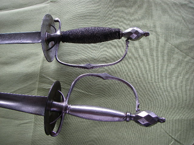

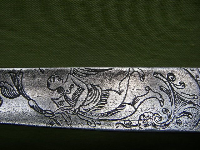

Good Morning/Evening everybody,
I have recently acquired a pair of Smallswords, one of which has engravings which puzzle me. They show a man with shaved head but a coiled pigtail; winged; holding something which may be palm branches; odd trousers; bare feet. Since my enthusiasm exceeds my knowledge I am at a loss to understand this. Can someone enlighten me as to the origin of this Smallsword?

Both are late 18th C., on account of the vestigial pas d'ane. The shape of the knuckle guard on the upper sword suggests is older than the lower.
The figure in question seems to be a winged woman, or a long haired man, probably depicting an angel.
I'm currently auctioning a similar sword, with an identical faceted olive pommel, and with identical scalloped guard as the upper one. This type of triangular-cut blade was known as "hollow".
All of Europe followed the french smallsword designs, so these ones can be english , french, german, dutch etc...
In fact, a very similar sword appears on "Swords and Blades Of the American Revolution", by George C. Neumann, p. 136 #224.

Very nice pieces Iliad! and nicely done on the assessment Manuel!!! Thank you for the insight on these. Smallswords are usually pretty tough, as you note pretty much everybody followed the French styles, as I have understood as well.
The smallsword is a fascinating weapon, and lines up well with the discussion started on the thread on fencing foils. I hope the discussion on these and other examples will continue!

I have been looking into these two smallswords further, I completely agree with Manuels assessment, and was intrigued by those faceted neoclassic pommels. In "The Smallsword in England" (J.Aylward, 1945, pp.59-64) there is interesting discussion concerning the smallsword rather in decline from between 1775-1785, but it is noted that "...an exception, however, must be made in favor of the cut steel hilts of about 1780, for some of them are not only as charming in thier simplicity as the hilts of the Queen Anne period, but the swords themselves are well designed, beautifully balanced, and absolutely efficient weapons".
The reason I looked into the Aylward reference was to discover more on the faceted pommel on these swords, and found discussion on Mathew Boulton, the innovative Birmingham man who promoted mass production of hilts (and was also the associate of James Watt in developing the steam engine). On p.60, it is noted that his "...cut steel, inlaid steel and faceted steel hilts seem to belong mainly to the period of his partnership with John Fothergill (1762-1781)". In Aylward fig. 29, Boulton's pattern book c.1760-80 shows hilts with crosshatched pommels as seen with these faceted examples.
On p.63, the very simple hilts of the latter 18th century are described mentioning again the use of facets in cut steel, and "...the former double shells of butterfly pattern have coalesced and become a single oval plate rather larger in diameter than the older style of shells, the ricassi are meagre, and the pas d'ane now consist of two rudimentary projections or else of two small half rings connected with the quillons by a little bar".
One of the key issues in identifying English smallswords, was the makers "...regrettable reluctance to inscribe his name upon his work", so that with scabbards gone, the makers are unknown. Boulton was a manufacturer of plate and steel articles, not a cutler, and it is well known that most blades were likely imported. He is thought to have made some silver hilts, which would have borne the marks he placed on his silver plate, but none of the hilts so marked are known.
I would suggest that these two interesting smallswords may well be from the 'Boulton parish' (as Aylward terms the Boulton enterprises) and as seems to be the case, unmarked, probably about c.1780, interestly corresponding with the example sword noted by Manuel (Nuemann, 224.S, p.136). This sword with scalloped oval shell and facetted urn type pommel, may be from the same general shops in the same period, which may have extended as noted to about 1790.

With that note, I've been trying to track down what might be behind this rather fanciful motif on one of the blades here. While markings with trademarks, makers and associated cabalistic or talismanic symbols are fairly well represented in documentation concerning many blades in the 18th century, much of the military panoply and in this case neoclassic motif really is not.
With the clear neoclassic styling present in these times, it would seem that this winged figure reflects classical Christian convention as well as possibly any interpretation of the mythological winged deities of antiquity, with the Roman winged Victory seeming most likely on a sword blade.
In the classical designs followed in elements of the decorative motif on these hilts, it is also interesting to note how closely associated shapes often seem to religious and architectural themes.
Weapons and art are truly closely associated in many cases, particularly as shown in many of these hilts and blade decoration.
