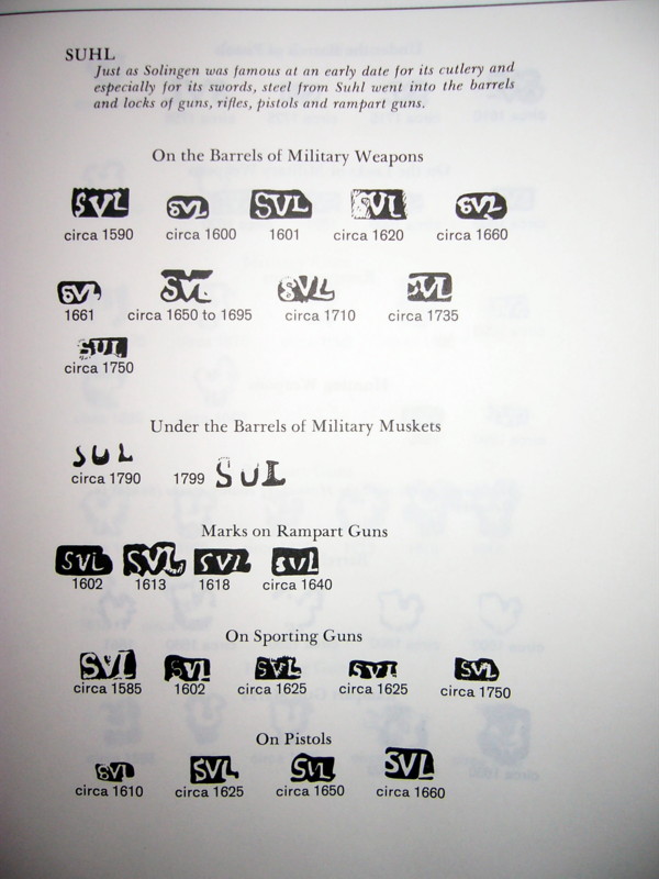

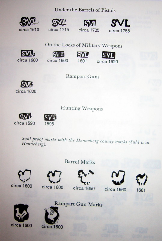

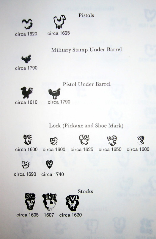

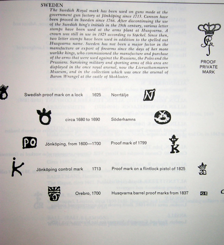

Smile WHAT DO YOU WANT TO KNOW? PROOF/CONTROL MARKS
I HAVE BEEN APPROACHED BY JIM TO START A THREAD ABOUT PROOF/CONTROL MARKS FOUND ON GUNS AND OTHER WEAPONS. I HAVE A REASONABLY EXTENSIVE LIBRARY, AND WOULD BE HAPPY TO TRY TO IDENTIFY ANY MARKS WHICH MEMBERS HAVE FOUND ON OLD WEAPONS. PLEASE POST YOUR REQUESTS ON THE FORUM AND I WILL TRY TO PROVIDE ANSWERS IF I CAN. BE PATIENT AS RESEARCH CAN TAKE TIME!
MEANWHILE TO GET THE BALL ROLLING I HAVE POSTED HERE THE CITY CONTROL MARKS FROM SUHL AND ALSO EARLY SWEDISH MARKS.
INFORMATION SOURCE "ONE HUNDRED GREAT GUNS" BY MERRILL LINDSAY.

Stu , thank you so much for getting this thread started, and for beginning with such a unique subject. In discussing firearms, it seems the focus is usually on British, then French, followed by Spanish then occasionally Portuguese, at least in my perception as an observer. Obviously German guns come in as well, but seldom those from Sweden and North Europe it seems.
I'm sure this order will be challenged, but basically what I am saying is that Swedish guns dont seem to turn up too often.
I very much look forward to this thread developing, and as I have mentioned before, it is great to see responses on our new forum with its scope including and encouraging antique firearms discussion. I hope this thread will present a standing resource for those researching these firearms to find information on the markings which hold valuable clues and detail.
It is interesting to find that Sweden had such an important firearms industry with Suhl, and its comparison to Solingen for sword blades. If I understand correctly, the sword blades used in Sweden were typically Solingen made.
I am hoping someone out there might have a Suhl made weapon to post..it would be great seeing actual examples as we discuss these markings.

Thumbs up A FEW MORE OBSCURE MARKS TO LOOK FOR!!
Thanks Jim for the comments. Just to make things more interesting here are a few more obscure marks from the same source as previous.
I also would be very interested in seeing an actual weapon with ANY of these marks posted here.
