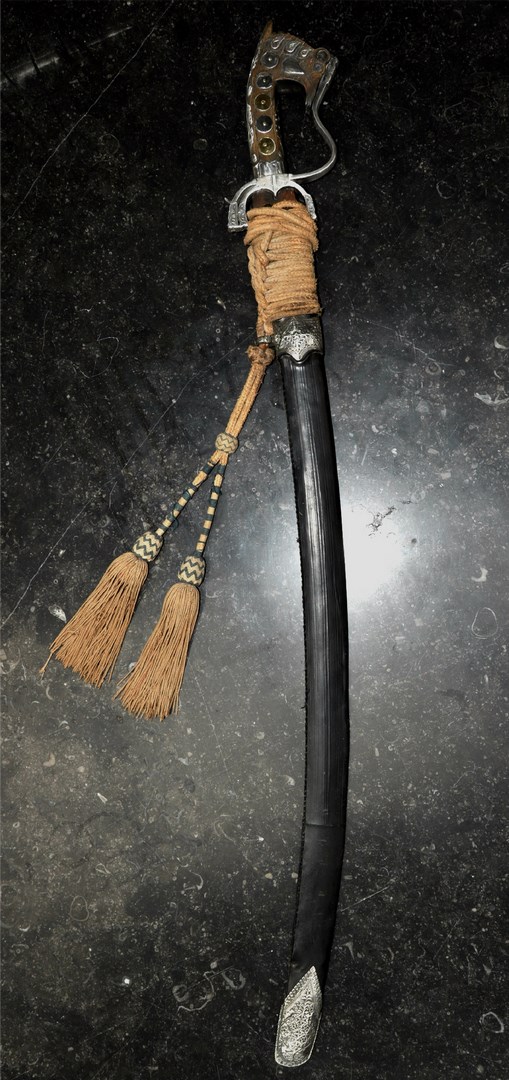

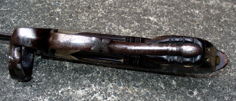

Hello to all members.
Can you help me to learn more about this "nice" saber that i've find 1 month weeks ago in a flea market in " La Louvière / Belgium ".
The flexible blade is marked (European mark may be). The handle appears to be rhino horn and silver. Traces of red lacquer in the etched silver patterns. the scabbard is in wood covered with skin. I seem to be in good condition. The rope is faded but it was red and blue.
93 cm long for all
68,8 cm long for the blade
Thank you for your help and see you soon
Fabrice

Belgian1:
Welcome to the Forum.
That is a nice looking nimcha that you have shown--a nice find at a flea market.
Would you also post a picture of the complete sword outside of the scabbard. That will help the experts on this Forum to better identify its origins and style.
Ian.

Hi Fabrice
It's a very beautiful so-called sword from Zanzibar...
Really cool

Hi Fabrice, and welcome to the Forum.
A VERY nice NIMCHA sword. Not necessarily from Zanzibar. The so called "Zanzibar" Nimcha usually has a D shaped "guard" as shown here.
Stu

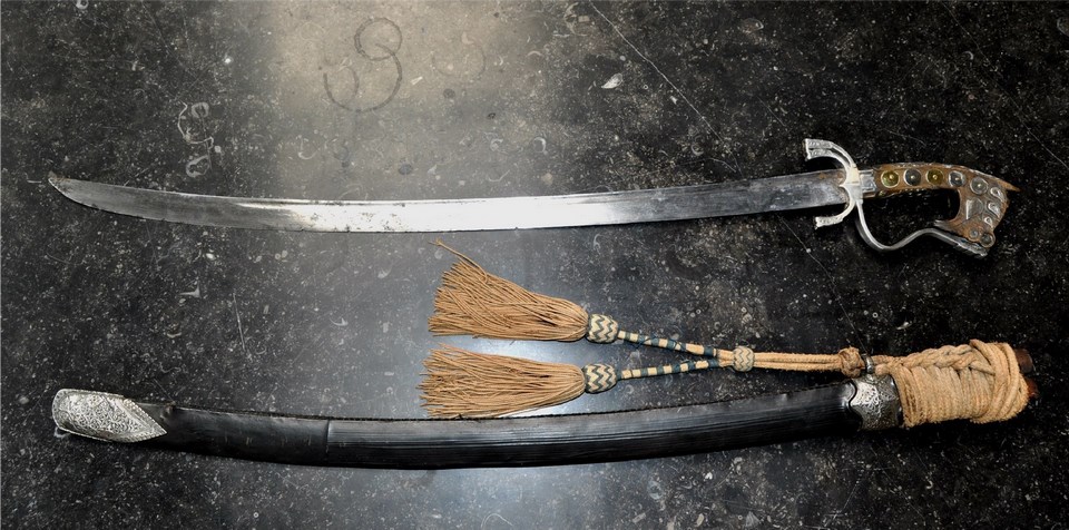

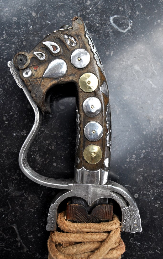

Old 14th August 2015, 08:13 PM   #5
Belgian1
Join Date: Aug 2015
Location: Belgium
Posts: 52
Default Arabo-Ottoman sword
Hello to all, from Belgium :-)
I hope that this pictures can help you
Merci beaucoup Ian and Kubur :-)

Old 14th August 2015, 08:53 PM   #6
Posts: 7,420
I was thinking your wonderful example comes from Morocco.

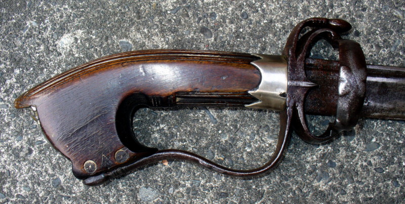

Old 14th August 2015, 09:45 PM   #7
Arab / Zanzibar
You have two kind of guards with ring or the Persian style.
More important are the grip and scabbard...
http://www.vikingsword.com/vb/showth...light=zanzibar

Gavin Nugent
Gavin Nugent's Avatar
I too believe this is from the northern African Coast through to Tunisia.
The variation of the hilt shape, the type of quillons and the presence of coral all point to Tunisia for me.
http://www.vikingsword.com/vb/showpo...23&postcount=1
Gavin
Thank you very much for your comments and link.
Is there a rapprochement with the Zanzibar type swords.
Do you have any idea why this handle rhinoceros horn and silver.
Rhino horn was it not for a fortunate elite?
see you soon
Fabrice

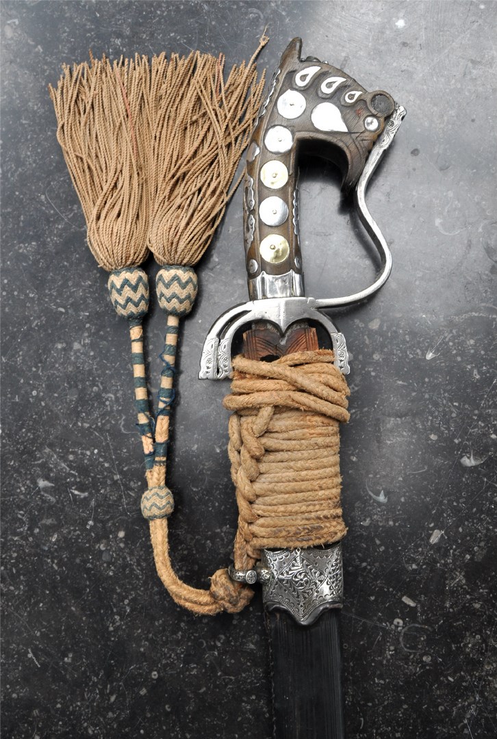

Fabrice:
Can you say a little more about why you think this hilt is made from rhino horn?
see you soon
Fabrice

North African, possibely Algeria or Tunisia. Note a similar one (fitted with an earlier cutlass blade, and a plain guard), from the captured weapon section in the Palace Armoury of Malta.

Originally Posted by Ian
Fabrice:
Hello Ian, Hello to all members and a big thank you for your comments and your interest about this "enigmatic" sword :-)
The handle seems rhinoceros horn because its fiber had the characteristics of this very special material (fortunately the species is protected today).
I'm "almost sure" that it is rhino horn. Do you think it is not possible for this type of sword or have you another suposition ?
Thank you for your interest.
Have a good day and see you soon
Fabrice

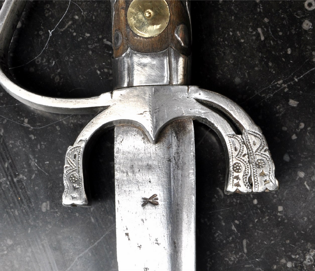

Salaams Belgian 1 The mark on the blade... Oddly enough this is a very similar mark to the Omani Emblem but is in my opinion not related at all...since it is ...I believe ....the fly mark (or twig mark) seen on European blades and seen at http://www.vikingsword.com/vb/showth...=anthony+North
I recall this mark being attributable to Peter Cull... Wheres Jim?.... although a lot of marks were also copied or used by a lot of different craftsmen ..
Ibrahiim al Balooshi.
