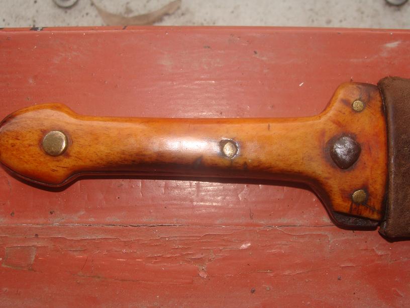

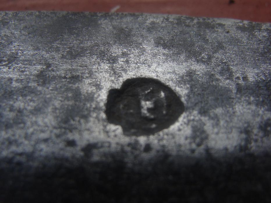

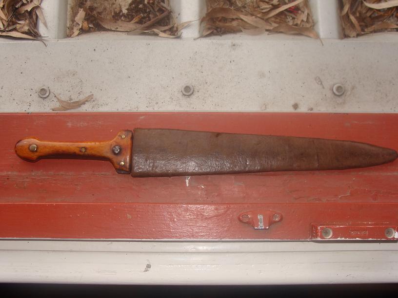

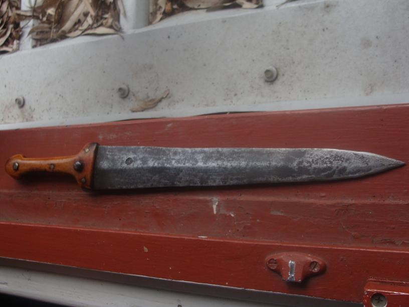

I have recently obtained this piece and several others and wish to know more about this one in particular. The hilt is bone and of an orange colour, would this denote a region/country or ethnic group for origin? The blade is broad, thick and has a nice taper to it in all direction. The blade is clearly stamped both sides, does anyone have any info on this mark in particular? Over all the piece is only 16inches and has a blade of 11inches.

Any one have the the wisdom to make any guesses on this ole piece? The orange bone handle is of particular interest to me as is of course the armourers stamp. I have seen similar pieces from Turkey, early 1800's but I do not know exactly....

I have very little knowledge of Kindjals, but I am intrigued by the proportions of the blade (it seems quite 'heavy' and 'meaty') to the 'smaller' hilt. Whether this is a characteristic denoting age or area, or a re-hilt I do not know, but I would be interested in the comments of a more knowledgeable formite Many Kindjals I have seen (on eBay for instance) seem to have thinner 'weaker' blades.

I've scoured my limited books an resources for you and the Kinjals I've found that resemble yours are all listed as Caucasian. I've snapped a copy of a picture of one in particular that I think is close, especially because of the central ridged blade rather than the asymetric fuller. The handle is also like yours, but apparently horn, not bone. This example is dated as 1866. Note the armourers mark, its position and the general proportions of the weapon compared to the larger ones either side.

Older blade is caucasian but the hilting probably balkans around 1900-1920

David the blade is very meaty and of strong proportions and is all business.
Thanks for the Balkans rehilting hint Ward, is it the small shape, the bone not horn or the orange colour that denoted this? What age is earlier Ward, can a small era be pin pointed with the proportions and armourers stamp?
