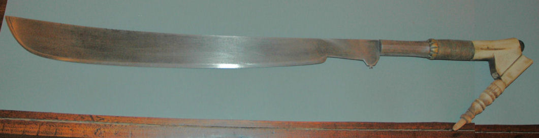

Hi! Everybody,
I'm just looking for the right names.
Thank you for any help.

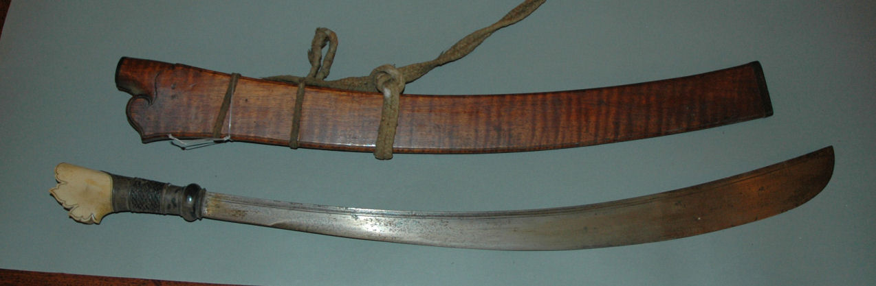

Beautifiul pieces. Lovely wood on the top scabbard.
The middle sword, is the little knife detachable? Thanks for sharing.

3 VERY NICE SWORDS
I WILL HAZZARD A GUESS THEY ARE FROM BORNEO. THE FIRST ONE HAS A HANDLE DESIGN I HAVE SEEN ON SADAP A VARIATION OF THE PRANG LATOK, THE BLADE HOWEVER IS NOT IN THE NORMAL LATOK FORM.
THE SECOND ONE WAS DISCUSSED ON THE FORUM A WHILE BACK BUT I AM NOT SURE IF WE EVER DECIDED WHAT TO CALL IT BUT IT IS A DEFINITE TYPE AS THERE ARE SEVERAL OWNED BY MEMBERS HERE. I WOULD LOOSLY CLASSIFY IT AS A FORM OF PARANG NYABOR.

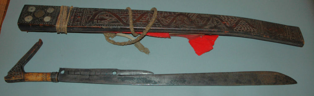

THE THIRD ONE APPEARS TO HAVE A BLADE CUT DOWN FROM A MACHETE WITH A HANDLE ALSO RESEMBELING THE NYABOR SHAPE.

1. Parang Pedang (cp. Shelford, 1901: http://www.jstor.org/pss/2842798)
2. http://www.vikingsword.com/vb/showthread.php?t=5387
3. http://www.vikingsword.com/vb/showthread.php?t=5074

Hello Cedric,
Kai's already answered your question but I would like to add that your Parang Pedang is more like a transition between a PP and a Murut Sangkit.
See http://www.vikingsword.com/vb/showthread.php?t=2149
I am especially thinking about the characteristic Sangkit and Pakayun brass ferrule and also the scabbard.

How old do you estimate the (Iban) Parang #3 is?

Two questions:
1. Sword #1: isn't the blade very similar to the one I showed once
http://www.vikingsword.com/vb/showthread.php?t=3313
The tropical wood handle is quite interesting, and the bolster/handguard smell " Pacific" to me...
Not?
2. Sword #2. Which side is the edge? I.e., is it possible that the handle is upside down?

Hello Ariel,
I don't think there's any relationship: IMHO possible similarities in blade shape are merely incidental (blade construction is very different but that is difficult to see from pics).
I still think the piece from the other thread is most likely from northern Africa.
The whole sword is pictured upside down...
