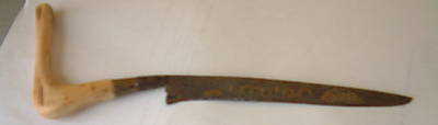

Hi Guys,
I have just bagged this ' unusual paper knife ' on E-Bay. The photos are pretty bad but I think it is a Rencong. I will post better shots when I get it but I am keen to get some feedback from you before that if possible.
Norman.

Yes its a rentcong from Aceh. Grats on a nice "paperknife" I can't wait to see better potos
Old 7th September 2008, 03:34 PM   #3
Posts: 7,418
Looks like a bismallah etched on the blade. Could be a more recent piece. Better pictures would certainly help.

Yes, a rencong. Looks like a good piece. Bone or ivory hilt. Is there a scabbard?
Waiting like the others on better pics, but I think it is a nice one.

I have to admit that I have strong doubts about this rencong: The proportions seem to be all wrong; etched or painted inscriptions on the blade also seem to be a give-away for modern production in these blades.
Let's hope I'll have to eat my words...

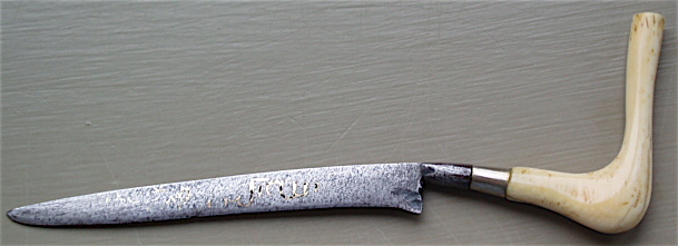

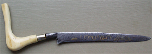

Old 10th September 2008, 04:23 PM   #10
Norman McCormick
Norman McCormick's Avatar
Posts: 1,657

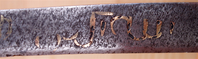

Hi Guys,
Here are some photos of the knife. I'm not sure what to make of it, is it a vintage tourist item, is it a poorer mans knife ???? It is sharp, 8 inches overall with a blade of 5 inches, quite small I would have thought although one site I did find said that blade sizes varied from 3 inches to 20 inches. It would appear to have been sharpened on many occasions whether this conveys anything or not I don't know. The handle might be bone although it may be a tusk/tooth of some description again I'm not sure. Sorry to be so vague but it is outwith my sphere of knowledge coupled with that I seemed to have difficulty getting decent photos for some reason. The inlay looks pretty well done but file marks are evident all over the blade although this may be due in part to numerous sharpenings. As you may gather from David's ( Katana ) post I did not push the boat out with regard to price, to be truthful I paid a little less than one U.S. dollar, less than one Euro, so whatever the outcome I am pleased to have a pretty little knife to keep the others company. Oh a translation of the script would be nice if someone could oblige. Many thanks for your interest.
My Regards,
Norman.

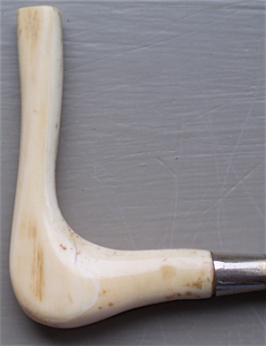

Nice piece, looking forward to hearing more about the blade. Lovely ivory hilt.

Looks like the inlay is gold or souasa. This is not cheap tourist stuff. I wouldn't be surprised if someone told me this little fellow saw some battles. And probably against some dutch soldiers .
The hilt is as far as I can see Ivory. Maybe from a whale.
A pitty you don't have the scabbard.
But congrats, I think you did well, very well.

Old 11th September 2008, 08:39 AM   #14
Hello Norman,
Yes, Henk is referring to the (Dutch-)Aceh war. That's when most of the rencong got - ummh - collected.
Yes, seems like some valuable materials were used for this piece. Would be interesting to test both the inlay as well as the ferrule for gold and silver content; also the hilt material could be narrowed down, I guess: how does the tip of the hilt look, any Schrade lines, really no tiny dots from blood vessels?
However, the piece does look off to me: inlay sloppily done, hilt carved from insufficient material (flattened areas rather than evenly curved), blade shape weird (even for a Gayo blade). Technically, one might even argue that this piece isn't a rencong: no decent duru seuke (blade flaring out at the base) nor taku rungiet (the little "ears" at the front of the iron ferrule) nor any of the other characteristic ferrule features (octagonal cross section, file work).
Obviously, this is supposed to be a rencong though and it was done with far more skill than the tourist crap commonly seen on ebay but IMHO it's equally far from 19th c. craftmanship. My best bet is that this might be a ceremonial dagger for weddings - possibly 2nd half of 20th c.?

Yes Norman, that's probably the collection period of this one. This Rencong is made arround that period for sure. Earlier? Maybe.
I don't think this is an off piece. I cann't say the inlay is sloppily done. The blade suffered, and in my opinion cleaned in a way that did some damage to the inlay.
About the hilt it is very good possible that the ivory used was insufficient, but the shape of the hilt is good and it has the bulb on one side. The side worn on the belly is the flat side. I can imagine that that was more convenient when the weapen was worn in the belt.
The shape of the blade isn't weird in my opnion. It is definitely the shape of a rencong or even a sewar blade and it shows a duru seuke. Not a proper one, I do agree with you, but I think it is due the suffering of the blade. Maybe a good close up of that part couldd tell us something. The missing of the taku rungiet as the ferrule features is in my opinion also not an important direction. True, most rencong do have these features, but a lot don't. Or like we say here in Holland, exceptions do confirm the rules.
I think you should look through the suffering of this weapon.
I only will agree with you to give this rencong the status of a ceremonial dagger for weddings if the inlay is translated with the words: Poor fellow, go back home. If you enter, there is no way of return!

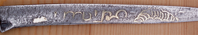

First of all many thanks to you both for your input on this piece, the following is from hands on observation rather than any prior knowledge of Rencong of which sadly I have none. Kai I think there is no doubt that this is not the epitome of the Rencong makers art, but I do think if a piece was made as a wedding object in some respects it would be better executed that this knife. I don't know about Rencong but Dirks and Swords made for weddings here tend to be elaborately made with much attention to detail rather than the well made but more workmanlike needs of a working knife. This piece has without a doubt been sharpened on many occasions not the kind of thing one does to the one and only wedding knife. Although I have not handled any Rencong I have handled many 17th 18th 19th and 20th Century pieces from many cultures and one tends to get a feel if something is more recently made and I don't get this feeling from this piece. Having said all this the finer points of Rencong I will have to leave to others.
Henk, which language is this and where do I get a translation, after all it might say 'Emergency divorce tool'.

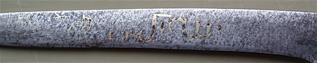

Old 11th September 2008, 07:02 PM   #17
Posts: 7,418
I was thinking the inlay was brass....
Old 11th September 2008, 07:11 PM   #18
Posts: 6,027
I think you are right brass one one side and copper on the other. I wonder if the handle is possibly bone? I have an African Islamised axe with brass inlay on one side and copper on the other. Not wanting to pour cold water but I do not think this is in the gold decoration standard of work.

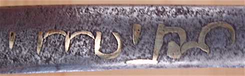

Battara, Tim,
The inlay, whatever it is, is the same on both sides, slightly different colour temperature on the photos. I am trying to find a local jeweller who can test it for me, will post result when I can.
My Regards,

Old 11th September 2008, 07:34 PM   #20
Henk
Henk's Avatar
Posts: 1,209
Norman, If that's the translation, you also know why it is sharpened so many times
In my opinion the language is the very old indonesian language. I'm afraid we have to look for a translation in that direction, but I doubt we can find someone who is able to read and translate it.
Tim, Battara, if the inlay is brass in your opinion it probably is souassa. Souassa is as you know gold with a very high level of brass or copper.
Old 13th September 2008, 12:21 AM   #21
Dom
Dom's Avatar
Join Date: Oct 2005
Posts: 1,142
I found someone but now ... with your stupid ideas
she decided to divorce me ... she found the tools
more seriously
on both side the same common Arabic expression
Allāhu Akbar, الله أكبر.
Usually translated "God is great" or "God is [the] greatest,"
à +
Dom

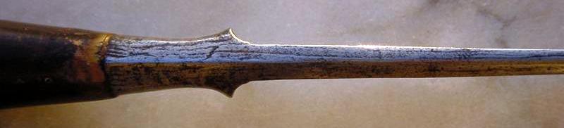

Old 14th September 2008, 01:59 AM   #24
Hello Henk,
The letters are formed quite crudely - compare this to inlaid inscriptions of antique blades!
Seems to me that this slightly flaring base was done by local hammer blows - you can still see marks left on both sides. IMHO this is clearly not 19th c. skill, even for a village smith.
Henk, maybe you could post a few of those exceptions? Of course, some exist but I don't remember any which don't attest to their makers skill!
Old 14th September 2008, 02:13 AM   #25
Hello Norman,
AFAIK, even those ugly tourist rencong (as well as "keris" of similar "quality") are nowadays worn at weddings. Apparently, they are not important enough anymore to most people of the current generation to invest too much thoughts and money into them...
In the old days, people would have been married wearing the best rencong they could afford. My working hypothesis is that this piece was crafted after the rencong had lost its function as a weapon and the bladesmith's skill level had already degenerated.
Most of the scratches I see could also be left from the original shaping of the blade rather than successive sharpening attempts. I'm not sure on this though - any ideas?
Old 14th September 2008, 02:25 AM   #26
Hello Norman,
Please do! Also the
BTW, even silver (coin grade alloy) tarnished with acids can looks almsot like gold...

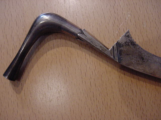

Old 14th September 2008, 08:43 PM   #28
Norman McCormick
Posts: 1,657
Hello Kai,
I see what you mean about the file type marks on the blade, I don't know if it's too clear in the photographs but the edge has been honed with a stone, or something similar, as the facet that makes up the sharp edge is smoother than the rest of the blade. This indication of a different wear pattern led me to the conclusion that the blade had been sharpened a number of times. I hope this makes it clearer as to how I came to my conclusion. If I can be of any further assistance please ask.
My Regards,
Norman.

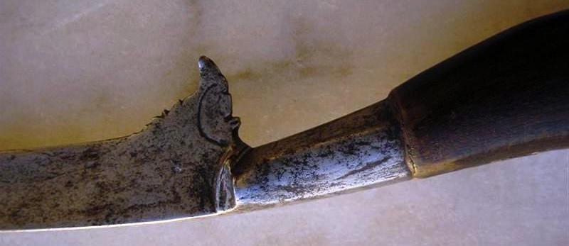

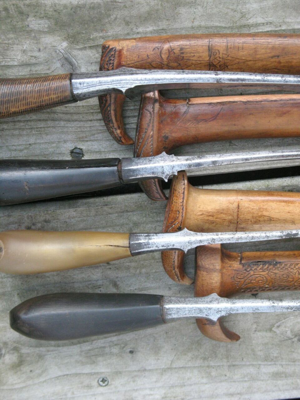

P.S. Can anybody post an example photo of the 'ears' referred to in previous posts.
Old 14th September 2008, 10:22 PM   #29
Henk
Henk's Avatar
Posts: 1,209
Norman,
On your request.

(herte a picture of various 'ears')
This example bought by Norman shows some skill from the maker, but it lacks the elegance and form of early pre 1900 rencong.
