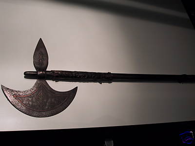

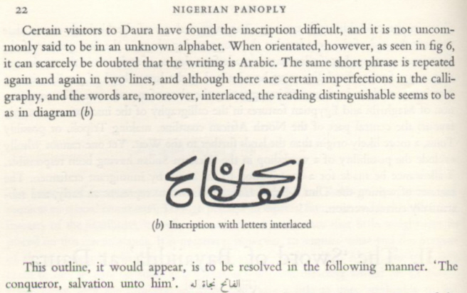

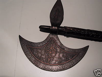

Freddy, I have just gambled on this. I do believe I can see a version of the inscription "The conqueror, salvation unto him" so we both have things to compere. I have a similar axe pretty much the same size 26 inches long but without the copper? inlay.

"...axes were popular among the Mahdist troops, and many were used in the butchery of Khartoum when the city fell"
"...some had elegant crescent shaped blades", further, "...the grips are normally wrapped in crocodile skin".
"Ten Years of Captivity in the Mahdis Camp"
F.R.Wingate, Cairo, 1892
A highly decorative example has its entire surface covered with elaborate acide etched 'thuluth' with additional brass calligraphic inlays.
Kendall, 2001

I think the script is a version of this. I believe the version seen on weapons like this is not the most pure form however when one thinks of its use as decoration freely applied as we see here, some artistic license should be expected. Note the first symbol at the bottom rather like a number 3 round the wrong way. The axe should be with me Tuesday.

Tim, just noticed the reference you're using......thanks again and I hadn't thought of checking that . Actually the 'thuluth' script is indeed actually more decorative than distinctly applied calligraphy, and was used in imitation of the beautiful metalwork on Mamluk weapons of Egypt

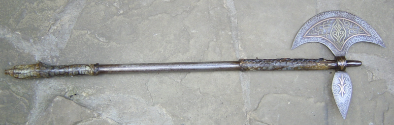

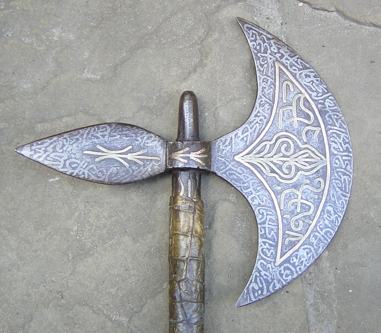

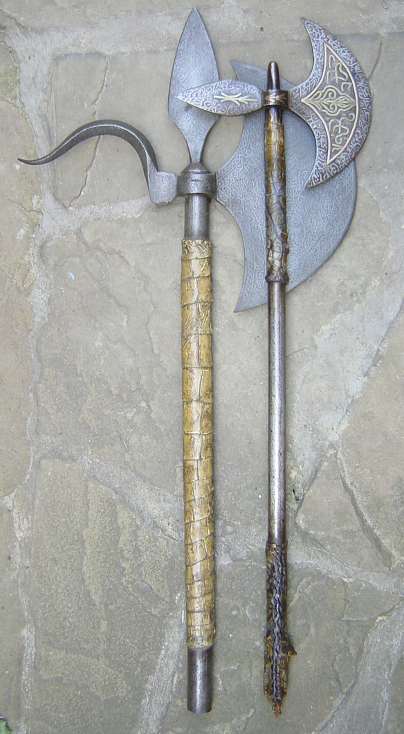

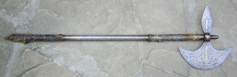

Old 16th June 2008, 03:17 PM   #12
Posts: 5,958
Thumbs up Quite nice
Arrived today. No idea about the inlay script.

The problem with reading many inscriptions on Sudanese pieces is that a lot of it was badly copied from the koran. Often you will see the inscription starting in the middle of a sentence and ending when they ran out of room. Often more talisman and decorative than anything else
Old 16th June 2008, 11:10 PM   #14
Posts: 10,795
Nice axe, of Mahdist style. It appears that the 'thuluth' and brass inlay is representative of the weapons of Mamluk heritage, and was probably favored in a talismanic or amuletic sense.
