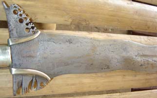

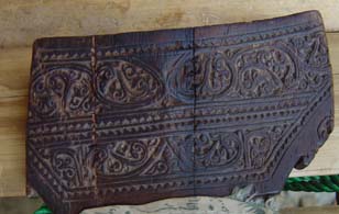

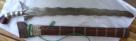

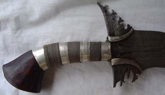

Guys, I'm posting this for another new enthusiast here who has picked up these two blades. Neither has a seperate gangya. The carving on the broken scabbard is of the type that the few locals who seems to know anything said was of an old variety, not as old the carving on the one I posted previously but old enough that they said there is no one around who could reproduce it (questionable). He also would like any and all info you can give him reference his new blades.
First one follows
Dan

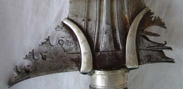

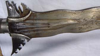

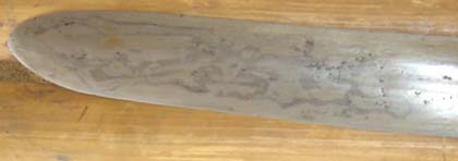

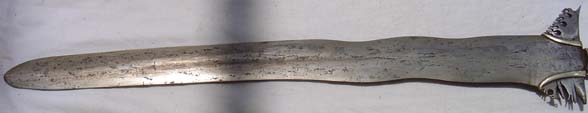

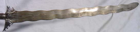

Here's the second. Incredible amount of grain in this one.

excellent kalis, IMO. if we have to go by cato's book (btw, we do that a lot here since it's the only book ever written dedicated to the moro swords), those are indeed a more recent, as in post 1930 and later, blade. it's really hard to tell whether the outfit itself are redressed or not, but nevertheless, they are IMHO, are "true" krisses, and not made for stalls in Aldevinco.
both have the classic horse hoof pommel, with either nickel or silver asang-asang. the first one, known as kalis seko, has 17 waves, luks, whatever. again, based on the book this symbolizes a snake in motion (also, the more waves, the more potent it is).
the second one, known as kalis taluseko looks like a no nonsense battle sword. the lamination is indeed incredible. handle looks to be made out of banati.
nothing much i can add here. again, like ian said, go with what the locals think it is. we're just a bunch of book nerds here basing most of what we know from books and each other. kinda like learning brazilian jiujitsu from the books, lol...

Hi,
I thought the first kris had an obviously separate ganja?

Originally Posted by BluErf
Hi,
Both are very nice sundang James!
A couple of mine have a chiseled line that makes them look like they have a separate gangya. This one is similar in style to the second one.
Thanks for sharing these with us.
Steve Ferguson
Old 15th May 2006, 08:11 PM   #8
Posts: 7,401
I second Spunger's observations. These are newer post 1930s, when separable gangas disappeared. As Ferguson has demonstrated, lines were added later on some pieces to make it look like a separable ganga.

The first blade everyone is looking at is in fact one piece. The locals say that the two piece blade is usually older than one hundred years old. Wilke explained that there have been one piece blades found here that did date back to a hundred years ago, but were not very common. Hard to tell. Dan wanted me to thank you all for your input. He is heading home for a while but may return soon. I also appreciate the information I'm getting for you guys. Thank you.
