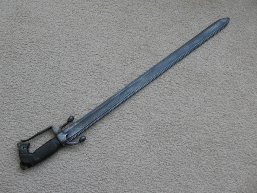

Quoting Elgood, nimcha means "half" and so should be applied to swords half the size of a normal sword.
My latest purchase falls within this category. Whether the blade was shortened on purpose to make it more suitable for fighting on board or was broken and the tip redone, it certainly is half the size. I think the markings indicate a Solingen trade blade, but Jim, Jeff and others are much more knowledgeable on the subject and I would appreciate comments.
Teodor

Is it Moroccan with one quillon broken off or Algirean ( 2 quillons to start with)?
The third quillion is broken off, so I guess Moroccan.

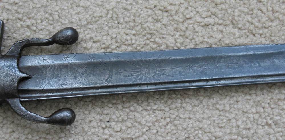

Hi Teodor,
A really interesting and unusual example of the Moroccan sa'if typically termed by collectors 'nimcha'. This example is unusual as it is mounted with a heavy straight blade, which is most likely a Solingen product and of the end of the 18th century. The blade seems to be of its original length as the center point fuller meets the tip as is typical for this particular cross section blade known as 'Montmorency' for the French officer who designed it in that period.
The cabalistic symbol panoply is of typical Solingen application. It seems that this type blade was more common on longer cavalry blades, but wonder if this might have been designed for shorter weapons such as those on artillery swords, and auxiliary units.
Interesting note on the quillon system, I was not aware that these hilts had variation between Morocco and Algeria. While these are typically regarded as Moroccan, it is well known they were used as far as Algeria, and interestingly there are portraits of English nobles wearing them in the 17th century.

Hi Teodor,
As stated by Jim this is a Solingen product, late 18th to early 19th century. The sun, moon and star motifs are typical and often confused with the much more elaborate etchings of Peter Munich. The only maker's mark that I have seen on the same blade as these etchings is J.J. Runkle (1750-1808). I don't know if he is associated with all of these symbols or if a separate engraver made them for a number of manufactures?
Now here is where I get sweaty palms, by not completely agreeing with Jim . I think this is a shortened blade, from most likely a heavy cavalry backsword. Do you have the measurements? Sweet piece!

Jim and Jeff,
Thank you for your comments. The overall length of the entire sword is 31 inches. My feeling is also that it has been shortened. I will try to get a picture of the tip and more detailed measurements tomorrow.

In taking a closer look at the blade tip here, it does not appear 'center point' and with that does appear shortened, and I concur with Teodor and Jeff
This makes a great deal more sense, as horsemans sword blades of the 1770's to 1780's were straight and commonly of this section.

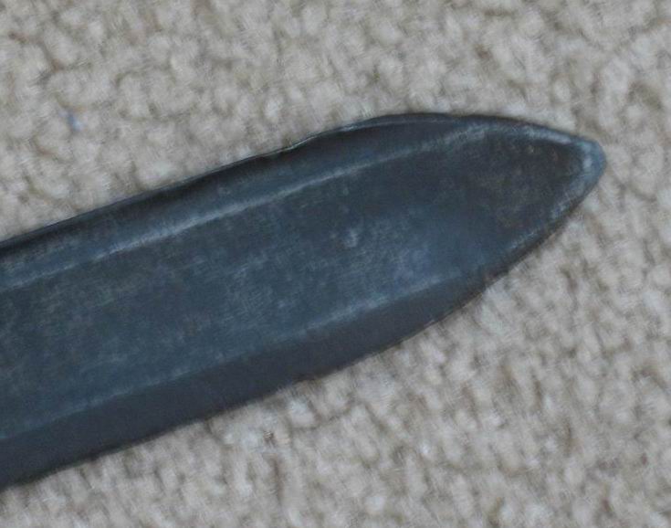

Here is a picture of the tip .
Old 21st April 2008, 12:06 AM   #9
Posts: 10,867
Thank you Teodor! The modification is clearly seen...and I need my glasses checked!

In this case we agree that the blade is shortened. Is there any chance this may have been done on purpose, to adapt the blade for naval use?

Thank you for the kind words Teodor!
These sa'if typically regarded as distinctly Moroccan, are actually originally an Arabian form which is why the nimcha term became associated. They became well known in the 17th century as I have noted, and commonly linked with the broadly defined maritime marauders known as the Barbary pirates.
With this it has often been presumed that these familiar swords would have had shorter cutlass length blades, but in actuality it seems that they were often mounted with straight blades of considerable length. This was because most of the blades, like commonly the case, were trade or captured blades. I often had thought it unusual for a sabre type hilt to be mounted with straight blade, but it seems to have been common than realized, as I discovered in studying early Mexican cavalry sabres mounted with straight dragoon blades.
With all of this considered, we can only speculate why the blade would have been shortened, perhaps damage to the original tip? Personal preference would indeed come into play as well, but as noted, many of these retained the long cavalry type blades. It is worthy of note as well that these Barbary pirates' action was not always confined to on board melees, but often included raids into locations on land, where a full length sword was of course more in place.
Whatever the case, it is an intriguing piece with great blade and markings, and would ,by type, be quite at home on our pirates thread!!
