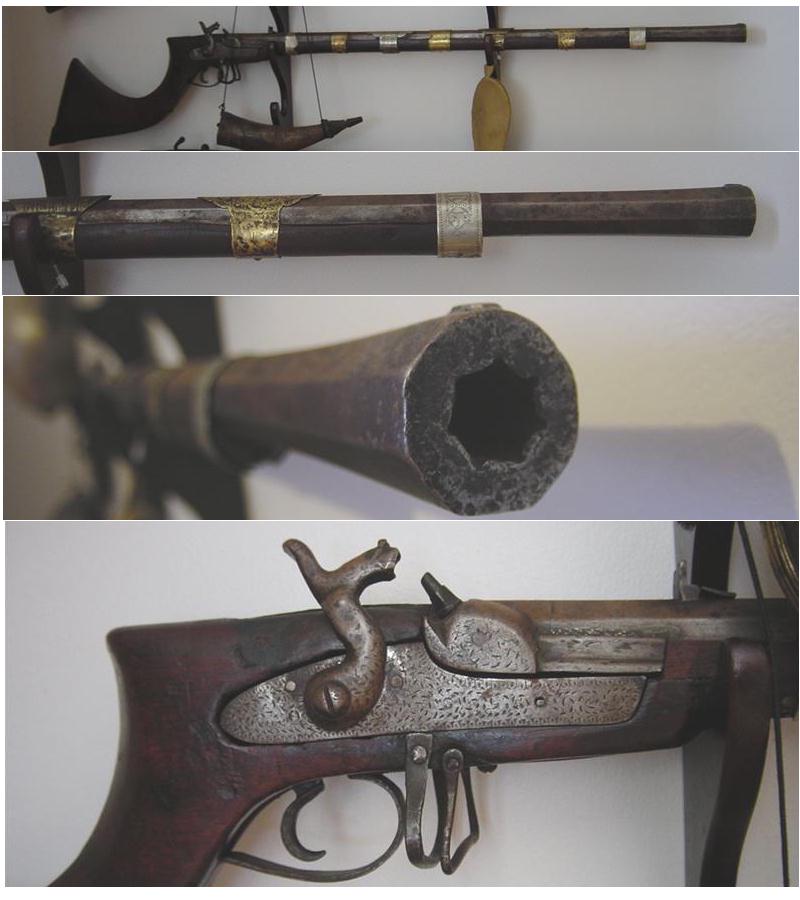

Hello, please help.
I have this piece for quite some time. What intrigues me in it, is the octogonal flared barrel, impressively thick, and with a deep 7 groove rifled bore. Was this technique currently used in Jezail muskets ?
Another detail i can't explain, is the two suspension rings close from eachother, near the trigger guard. Some peculiar belt hanging system ?
Thanks for your coments.

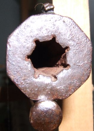

I'd like to se a square on shot of the muzzle, but from this angle, this looks like ratchet rifling.

Old 26th November 2006, 07:16 PM   #6
Thanks Double D
Will these do ?
Would this be some kind of ratchet system ?

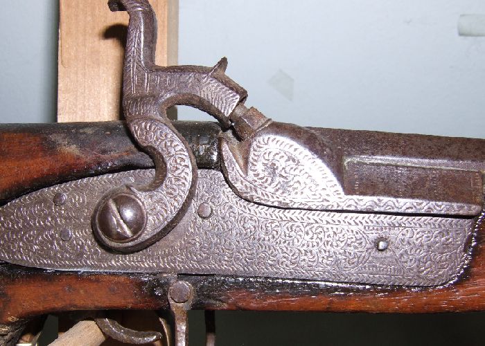

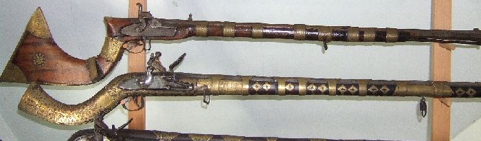

Old 26th November 2006, 07:19 PM   #7
ward
Join Date: Feb 2006
Posts: 637
here is pics obviously the top one notice the distinct hook but and the immediate drop of the stock after the tang screw. afghan jezail tend to be more of a gentle slope. compare it to to the afghan jezail below it

Thank you ever so much, Ward.
These pictures are an excelent point of reference for me.
Very nice pieces.

The slightly angled pictures do appear to be rachet rifling, but the straight on picture makes it very clear it's not. Each corner is more a trough than a groove.

The barrel of my sind rifle is not watered and it sounds like fernando's rifle is not. I believe both barrels are from the same workshop. I beleive both locks are locally made. I do not think they are retrofits. but originally percusion.

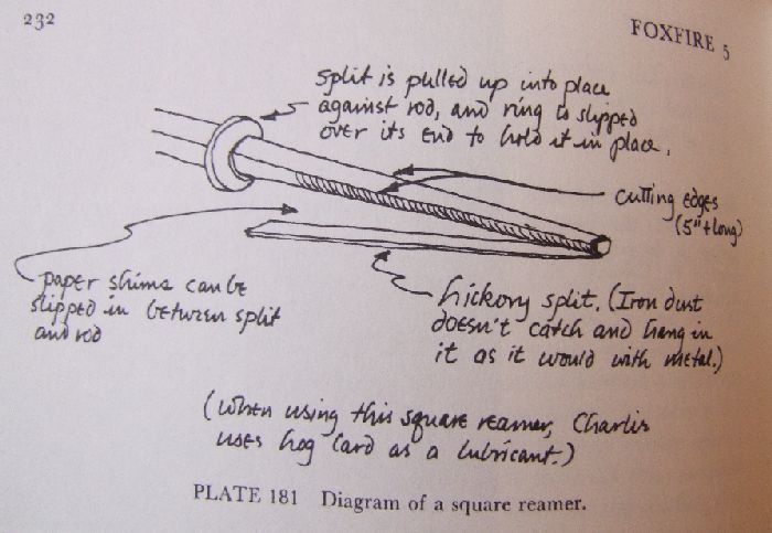

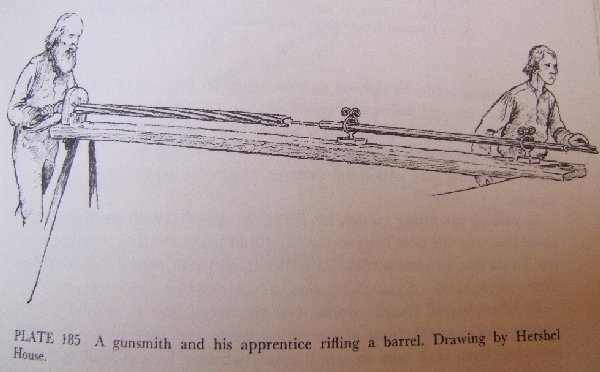

Here is one blacksmith's way of making barrells. Not saying all methods were used on this rifle but just gives a very basic idea of how a barrell could be constructed.

Thanks for posting the pics of the rifling process used in pre-industrial America. One would suspect that similar methods were used in the Ottoman Empire (the majority of Turkish "shishhane" guns are rifled) since both the Turks and the rifle-makers of colonial Pennsylvania looked to the same ancestral source for the rifle concept: the German-speaking world.

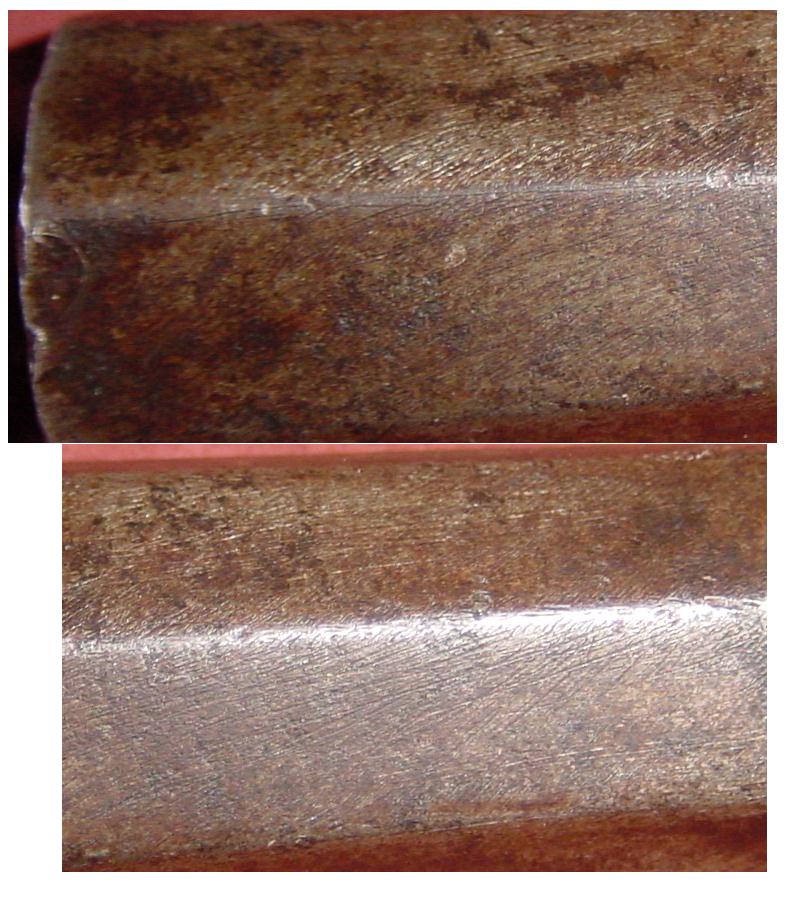

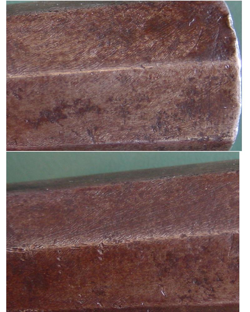

Old 8th December 2006, 08:10 PM   #30
Gentlemen, i am "swamped" with so much information.
Philip, i am glad that you have ( another ) Portuguese book, Espingarda Perfeyta, an unique gun treatise from the early XVIII century. It looks like the drawing of the "square reamer" shown here by Ward, corresponds to the description of chapter XXI, for the barrel drilling, in that Portuguese work.
I still think both Ward's barrel and mine were made with the same technique, only mine went through a certain endurance and the lands were much worn with the intense shooting of whatever projectile material. Besides it could be that these barrels were a little flared at the muzzle section originally, which seems to be a rule on barrel making, according to Espingarda Pefeyta.
After inumerous tryals, i managed to get a couple pictures on the barrel exterior finishing. It sure looks like filing ... or doesn't it ?
