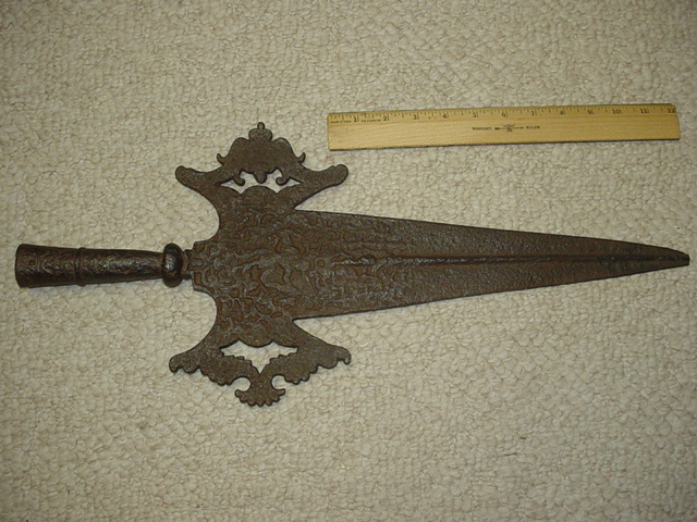

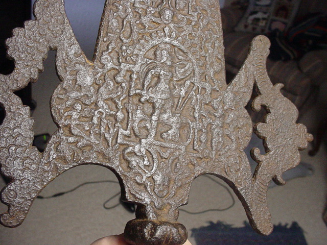

Helllo again fellows. You guys have been a tremendous source of good info. and I really appreciate all of your help. Here is another one of my recently purchased items. I know absoulutely nothing about this. Can anyone help with identifying this and what period in history if it is an authentic ancient weapon? Is this the real deal or fake? Measures approx. 22" long and is made of heavy iron. Thanks in advance.

It something between spear and sponton, 19th century. We have here in Museum few halberds, spontons etc. like this - very rude, very heavy, unhandy. After the cleaning it could be nice decorative object.

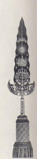

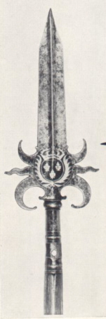

Hello Drzzzzz. Looks like the real thing to me but alas only in decorative condition.It is really out of my field but may be late 17-late18 cent and known as a Partizan.Here are some pictures.Tim

If it seems excessively heavy, especially in the thickness of the flanges, that may more point to a late 19th decorative piece; I think old partizans and spontoons were usually fairly light affairs; on the other hand, most I've seen were somewhat vestigial 18th century rank-marker military standards, or others similarly ceremonial, so say it was a 17th c. piece; a greater weight and solidity might be "right" for all I know. If it seems cast, it's likely 1850-1930. What about the decorative theme; the man or boy; I know there's not much detail left, but it seems like a "stock" image; perhaps a datable one?

Personally, I can't help wondering if it's a decorative piece made of cast iron. For what it's worth, I was thinking partizan as well.

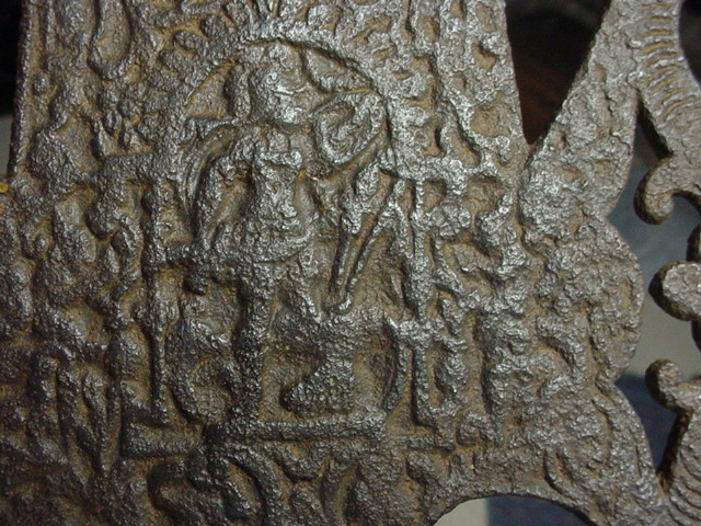

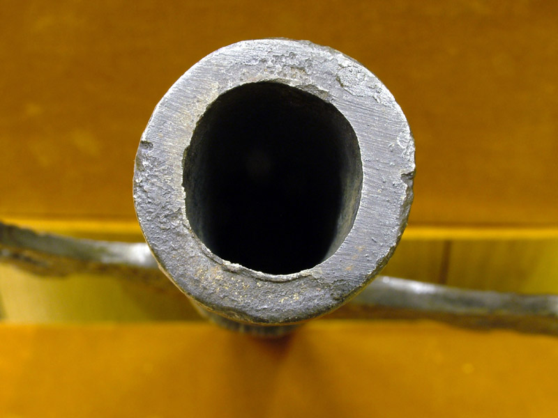

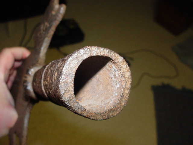

The pictures take a while; I never saw the end of the socket before. It seems thicker than proper; is it flanged from being beaten upon? Is it folded-over to the in side? Or is it straight-up just that thick? Anyway, the socket, especially the inside, is where you'll either likely see casting lines, or a forging line where it was rolled up, and maybe a tanglike nub from the blade-base. I personally think I may see a casting line disapearing into that shadow. I, too, suspect a casting, late 19th/early 20th, and moreso with that thick socket end, but I'm not sure. How old is the break at the tip? it does not look sharpened? Is there crystalize "grain" visible? Ie pebbly surface? Is there delamination/layers visible here or anywhere?

Posts: 2,718
For a partizan it looks more heavy than normally seen, so I agree that it is cast.

Doesn't the socket seem a bit too short to be functional?

Even if it is too short, it doesn't matter because it is decorative not functional

There's nothing short about the socket, unless it's not hollow its full length.

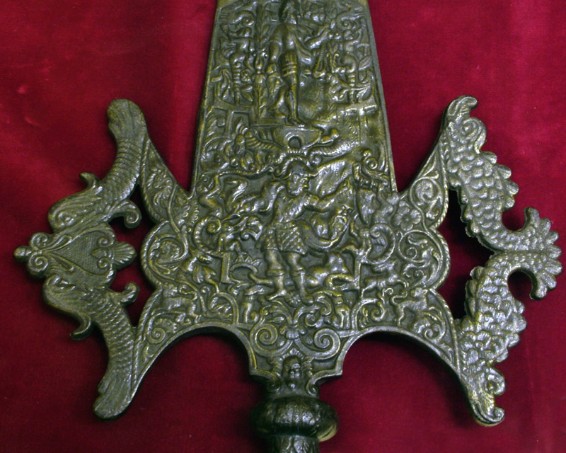

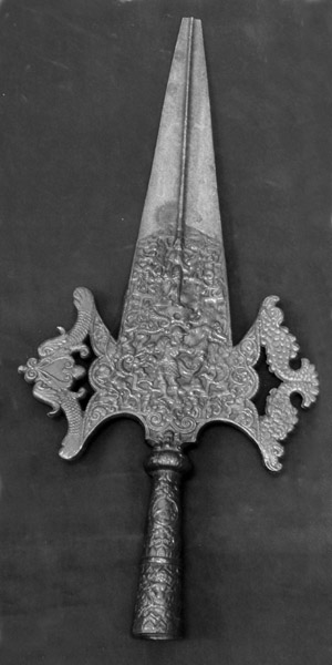

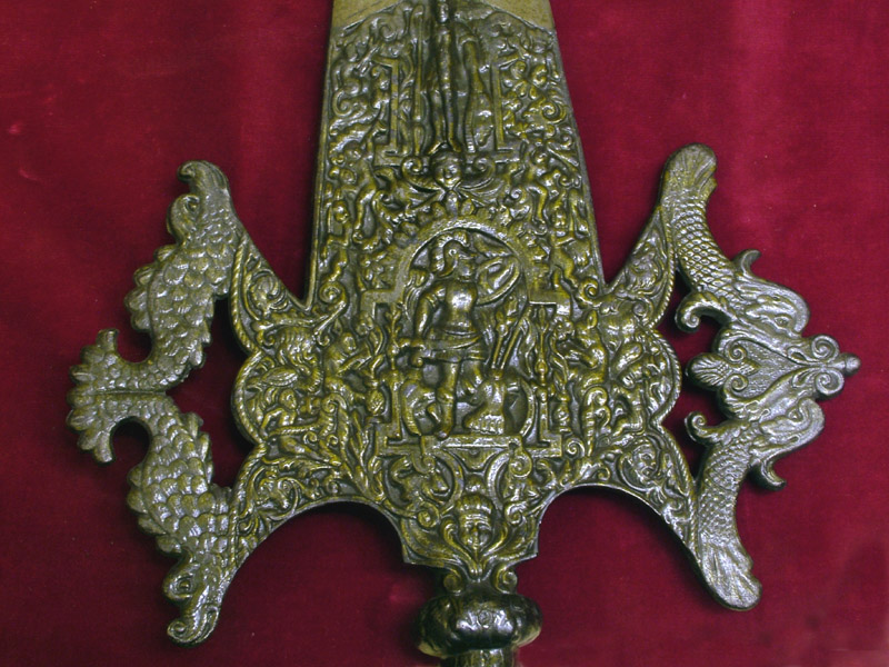

As I wrote it before, we've got something similiar in museum. To be exact - it is almost identical, the same shape, same pattern, but in a bit better condition. I would like to agree with Allan words, quoted by Andrew, but one thing is bothering me: saying Victorian, do we mean English or just European from the 19th century (sometimes called Historical Period) - ANDREW: this would be great if Allan could explain this further . And this is of course partizan - I would even call it spontoon (sponton) which is a type of partizan BTW.
And the photos of museal piece:
Regards!

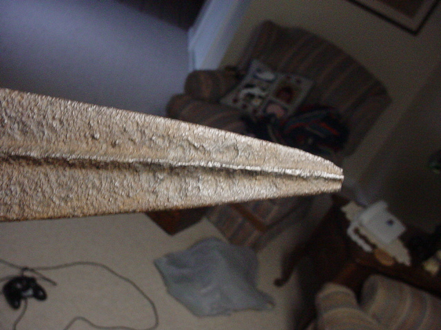

I'm still sticking with my trash dump theory for the one in poor condition .

But I would like to calm down our forum friend drzzzz...zzzz - of course there is no doubt that his sponton is in need of restoration, and the pattern isn't well visible - but such objects, 19th century "fakes" from so-called Historical period or Victorian era, are sometimes quite expensive. Even if they are only decorative, theatratical or anything else - today they are antiques. On some internet Auction Houses in Europe you can find such objects - some of them realy ugly, rusty and rude - but with prices over 200 Euros. Some of them (but real nice) are even of 2500 Euros price! So cheer up, anyway (between us I realy don't know how much it could be worth, and even if I knew, we can't talk about it here.... )

Those two examples are remarkably similar.
Wolviex -- is your example a cast specimen? Seems I can see the "flash" at the join marks, especially in the center of the curlicues next to the socket.
Ian.
Old 20th April 2005, 08:29 PM   #26
wolviex
wolviex's Avatar
Location: Poland, Krakow
Posts: 421
Ian: it seems to be cast. Especially the ornaments, in my opinion, couldn't be made by artist hand personally - it seems to be only a pattern (let's call it this way) from the cast form.
