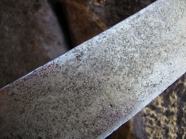

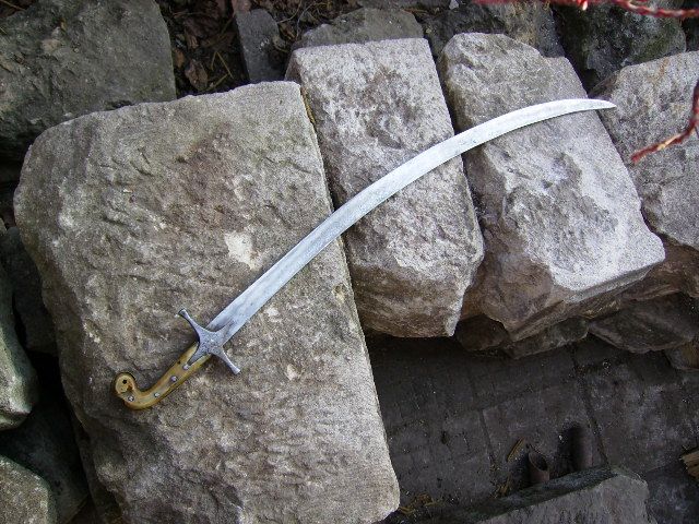

A friend of mine in Bulgaria recently acquired this sword, with a Turkish style hilt and what appears to be an Indian blade, based on the existing ricasso. He cleaned and etched the blade and was pleasantly surprised to discover a nice pattern. The question is, is this wootz or not?
I personally am inclined to think that it is pattern welded, but I am interested in your opinion. Also, any comments on the origin of the sword and its dating are more than welcome.

Looks Like wootz to me Kirk Nirban if I am spelling it correctly?

I vote mechanical damascus. With that activity (tight swirls) most likely Indian made.

Teodor, I understand your inclanation to think of this as mechanical. It does show well formed, bold and prominent pattern. Jeff also has a good point about the mechanical "swirls".
However, as pointed out by Lew, it displays some planar distortions, and what clearly appears to be a "ladder" formation, aka "Kirk Narduban" wootz pattern (and very attractive one So, I am with Lew.
Let's see what others think...
My guess on age, and very distant one, would be late 18/early 19th Cent.

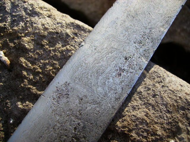

I also vote for a mechanical damascus and would love to see it polished up properly as the blades current state doesn't allow the full appreciation of the pattern. While you do see a vertical distortion it doesn't appear to be regularly appearing at least from the pics we can see. Also, a ladder pattern is a mechanical manipulation of wootz and this can also be done in a pattern weld. Another note is the lack of a pattern at all along the edge. This would suggest the blade has a high carbon inserted edge plate with the mechanical damascus "cheeks". An inserted edge along with the active pattern does seem to point to India as a possible origin of the blade.

Thank you for your quick replies. I chose the photos, on which the pattern resembled wootz the most on purpose. Now here are some additional photos, which I think will support Rick's excellent observations.

There are plenty of "ladder-like" mechanical examples in Manfred Sachse's book. Rick is unquestionably correct: ladder is an artificial embellishment and can be applied to either variety of damascus-type blades. And, of course, the inserted edge is a dead giveaway.

Yes now that better pics are posted I must change my opinion mechanical it is.

+1 Mechanical. +1 Indian.
