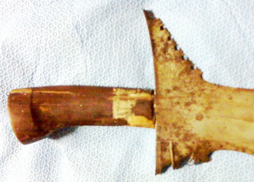

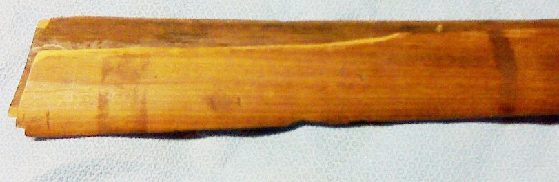

Since some have asked me in the past to share process, I thought I would here. The first pictures are of a kris as it came to me. It needed hilt restoration, a baka-baka clamp, and a large part of the scabbard was missing along with the wranga (top part).

I based the silver restorations on imprints I found on the hilt as well as the baka-baka.
The bigger process was the wranga. I had to cut a chunk of burled walnut from a log and carve it out. Then I stained it to better match the hue of the scabbard patina.
