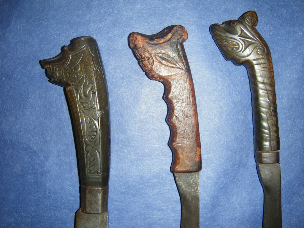

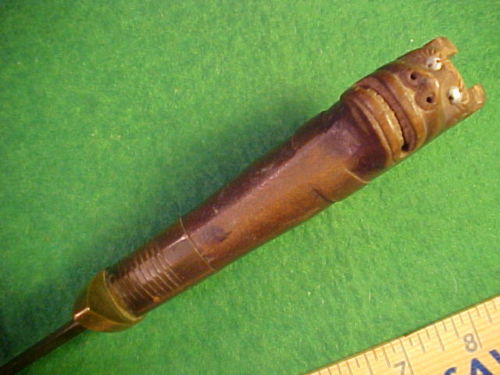

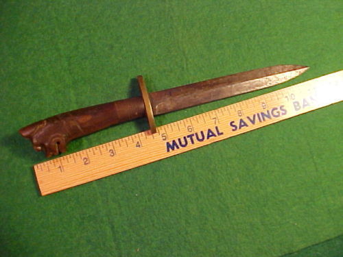

You know my interest in Bicolano blades, see here: http://www.vikingsword.com/vb/showth...ighlight=bicol

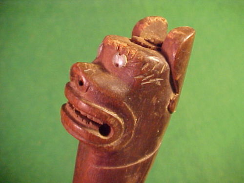

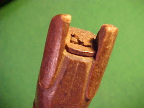

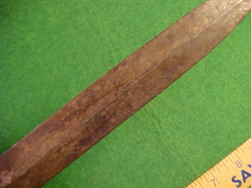

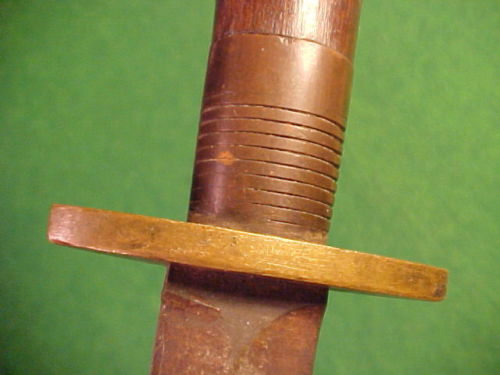

So I was glad to add today a Bicol dagger (at least I think it is) to my collection. The dagger is 11,5 " long with a blade from 6 5/8". Sadly it's missing the scabbard.
Like usual all comments are welcome.

Hi Detlef:
Apart from the carved dog (arso ?) head on the hilt there is little else to suggest a Bicol origin to me. The blade actually looks of European or US manufacture rather than Philippines, and the hilt (apart from dog's head) does not remind me of other bicolano knives.
Your example does not seem like a typical itak from Bicol. Perhaps a composite from a number of unrelated pieces?

Hi Ian,
thank you for comment. I based my attribution by the inaso hilt from horn. But agree with you that the blade seems to be a recycled US blade. Also the unusual eyes from screws (?) of Western manufacture let me think that this dagger seems to date from 1900-1945, maybe WWII area? For sure you are correct that it is not a typical Bicol dagger (BTW, how look a typical Bicol dagger? ). But again, would like to see more Bicol blades, sadly there is not much written/documented about Bicol blades. Think about how long it was needed to pin down the origin of the so called Minasbad, see here: http://www.vikingsword.com/vb/showth...batangas+sword

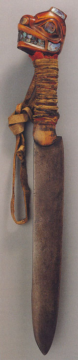

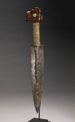

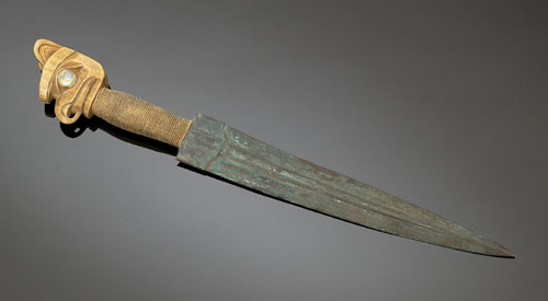

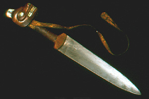

The carved head is a bit like that to be found on some North West Coast USA/Canada daggers (Tlingit).
Old 28th December 2014, 03:27 PM   #5
Hello Colin,
are you able to show examples?
Old 28th December 2014, 04:17 PM   #6
Posts: 7,300
Interesting idea Colin, though i believe stylistically the Tlingit pommels are carved a bit differently. The rest of the hilt doesn't really look Tlingit and you very rarely see a cross guard on such daggers, especially one like this. Sorry that these images are so small Detlef, but they are all i could find on line. I think these my more likely represent bear, than dog in the Tlingit culture, which genetically are really just much larger dogs (canines).

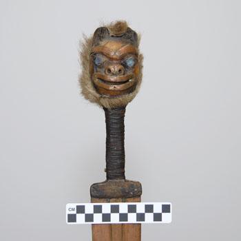

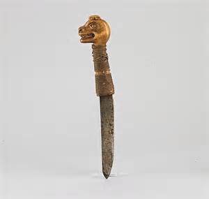

Old 28th December 2014, 04:34 PM   #7
colin henshaw
Join Date: Jan 2008
Posts: 1,432

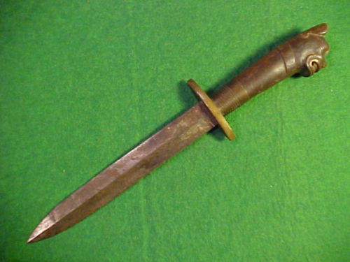

A few more...
Old 28th December 2014, 05:51 PM   #8
Hello David and Colin,
indeed a very interesting resemblance! Thank you both for posting the pictures but agree with David that the hilt of the dagger in question is different and have a more Bicol appearance, see this picture taken from the thread given in post #1. Attached also the handles from my Bicol sinampalok and the dinahong-palay from Barry.

I have to agree with Detlef on this piece being from Bicol. Whether or not it was made for a serviceman or a local who either acquired an American made blade and had it fitted with a local hilt or just had a dagger made with this style of blade the piece as a whole I believe is from Bicol. There are many transitional edged weapons from the Philippines that do not follow the style of the more traditional pieces that everyone tries to reference back to when looking to identify them. Many Luzon pieces are a perfect example of this. Some of the daggers show so much Spanish influence in their overall appearance that they can be hard to distinguish from true Spanish pieces. Then add in the fact that the Philippine people of the time would often use items salvaged from different sources in producing edged weapons. I have a dagger where the ferules were made from Chinese thimbles and the blade was either made from a tri-cornered bayonet blade or just made to look like one. Another is a gunong with a blade shaped like one from a talibong. One more has a blade in the shape of a minisbad, but a clenched fist hilt and a blind tang. I do not believe Detlefs piece to be traditional one (other than the hilt), but more of a transitional or one off piece. One of the biggest problems is one that Detlef has tried to point out. What do the different types of traditional Bicol edged weapons look like, how many styles are there and where do you find references to them?

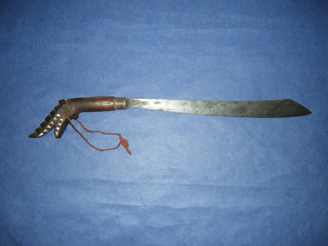

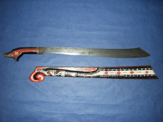

The type you have is I believed called a sinampalok....I don't have my notes with me right now. Sinampalok is term also used elsewhere in Luzon, but I've heard referred to this blade type in Bicol. I wouldn't get too hung up with the exact name of the blade type. There are hundreds of different blade types in the Philippines and the same blade can have different names even in the same region. What's important is that it's from Bicol...but it's not a minasbad.
Now, when you have a look to the shown sword in post #16, same thread, it has the same blade shape like from two of my swords from my other thread regarding Bicol blades/swords.
Now you will understand maybe better why I believe that my swords from Bicol as well.

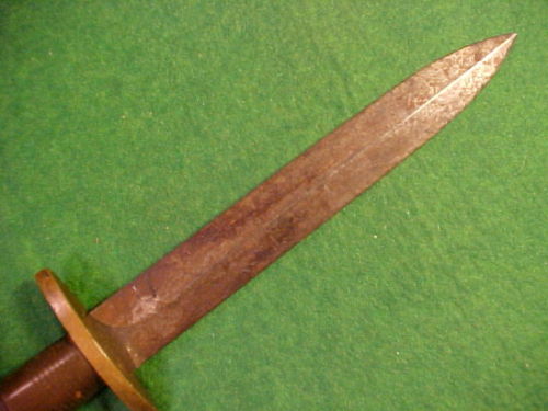

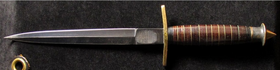

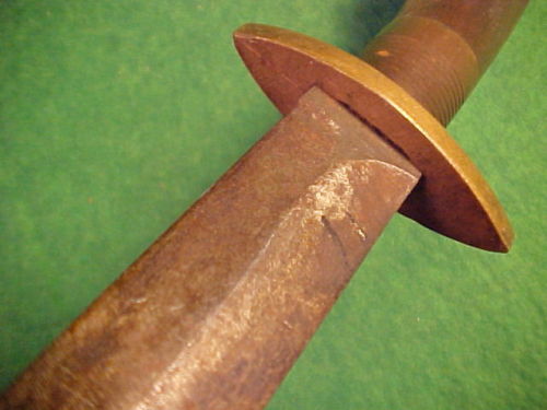

The blade on Sajen's knife looks like it could be from a US/European fighting knife (see image), or a re-worked bayonet ??
Regards.
Hello Colin,
this assumption seems to be a good one. The other alternative would be that a local blacksmith had copied such a blade.

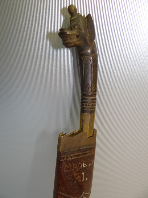

Just looking through some older threads and came across post #5 by steeldust on this thread http://www.vikingsword.com/vb/showthread.php?t=15388
"These photos are of a Dahong Palay (rice leaf) from the town of Tabaco, in Bicol, Philippines. The blade is 17" and the "tabak" was made this year. The scabbard is tied with mono filament fishing line instead of cordage. Thickness of the spine at the handle is 4.5 mm. The short sword weighs 16 oz."
The pictures are here:
http://www.vikingsword.com/vb/attach...chmentid=86499
http://www.vikingsword.com/vb/attach...chmentid=86500
Without the clear attribution from steeldust, I would not have identified this as coming from Bicol. The knife itself looks all Tagalog to me. BTW, I think the classification of this knife as a dahong palay strays quite a long way from the literal meaning of the term, and again points to the frustration (and futility?) of trying to be precise with our terminology.
Ian.

Originally Posted by Ian
Just looking through some older threads and came across post #5 by steeldust on this thread http://www.vikingsword.com/vb/showthread.php?t=15388[indent]"These photos are of a Dahong Palay (rice leaf) from the town of Tabaco, in Bicol, Philippines. The blade is 17" and the "tabak" was made this year. The scabbard is tied with mono filament fishing line instead of cordage. Thickness of the spine at the handle is 4.5 mm. The short sword weighs 16 oz."
Ian.
Agree, nothing would let me think that this blade coming from Bicol, the scabbard maybe a little bit. Vexing is also that steeldust used two different terms for one sword. Would be interesting if both terms was given to him from the seller. Here we have again the "name game". But it would be great already when we would be able to tell from where a blade has it's origin.
