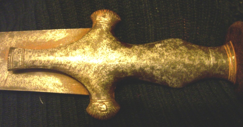

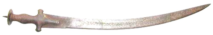

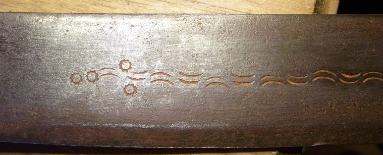

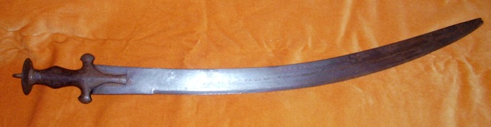

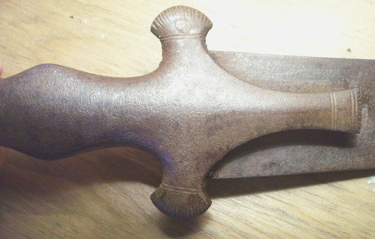

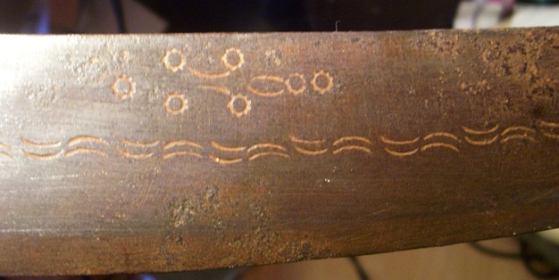

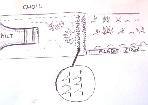

Would anyone have any ideas as to the origin of this Tulwar?

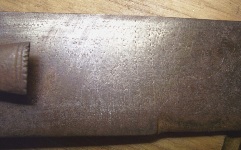

Heavily rusted, I have removed the 'live' rust' to discover a faint/ worn engraved design in the Choil area, difficult to see in the photos, so I have included a 'rough sketch' to show some of the detail. Look like sun symbols ?? The blade has deeply stamped 'cresents and round star like circles', which I have seen on some other Indian weapons (and African......and Afghani.... and ...)
Heavy blade, little distal taper and no false edge, a definate melee 'hacker' or possibly a Naval sword.
The hilt has 'scallop' detailing.
OAL 30.5" (approx 77 cms)
Blade 26" (66cms) following curve of blade, width at choil 40mm
All comments, suggestions etc gratefully received, thank you
Kind Regards David

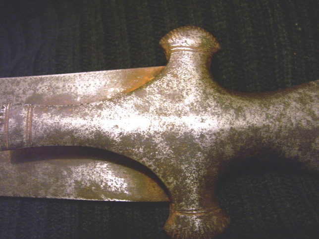

Very unusual quillons, too!

Hi Ariel,
I haven't seen this type of quillion before, or this type of decoration to the blade (the faint engraving). But because of the 'scallop' looking quillion ends and the shortish blade, I wondered whether this could be some sort of 'Naval Issue'.
The patina of the blade suggests 18thC to early 19thC and seems well made, not certain (due to patination) but looks to have laminations.
Regards David

Hi David,
Most unusual! and as always you have great observations. The scalloped shell is something I cannot say I've seen, and though I dont know of specifically instituted navy in India that would have issued weapons as such, it surely seems plausible (maybe this should be on the pirate weapons thread
I agree with your thoughts on probable period though, it does seem late 18th c.
More research !!!

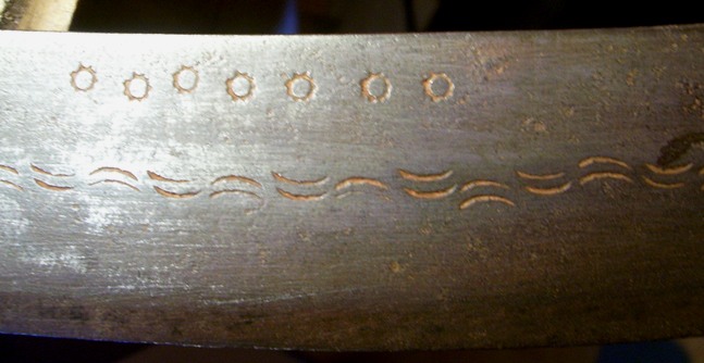

The eyelah mark looks very weak.The semicircles remind me of Thai Dhas.
Even the contour of the handle does not look Indian.
I have a strange feeling that it was not made in India. SE Asia?????
I know, I know, it DOES sound silly...

Actually Ariel, your thoughts might not be so silly. There is something very unusual about this hilt, the quillons and langet notwithstanding. The hilt seems heavy and disproportionate, and those circles with small prongs around do seem like markings like this on Cham (I believe) dhas and weapons. the arrangement of opposed semicircles and strategically placed 'solar' symbols at either end recall the often seen 'sickle' marks.
While this weapon is of the period suggested and of tulwar form, it does seem atypical overall.
The shell motif David mentioned was indeed a good suggestion, but I am wondering if there might be some auspicious Buddhist symbolism here rather than maritime use? Would the scallop shell be symbolically significant much as the conch shell is as one of the auspicious symbols?

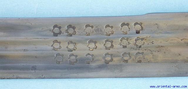

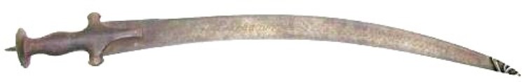

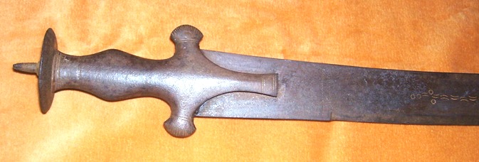

Searching on the internet I found these two images of the same sword....looks very similar to mine. Unfortunately there were no references or information about it. So ...at least there is more than one.

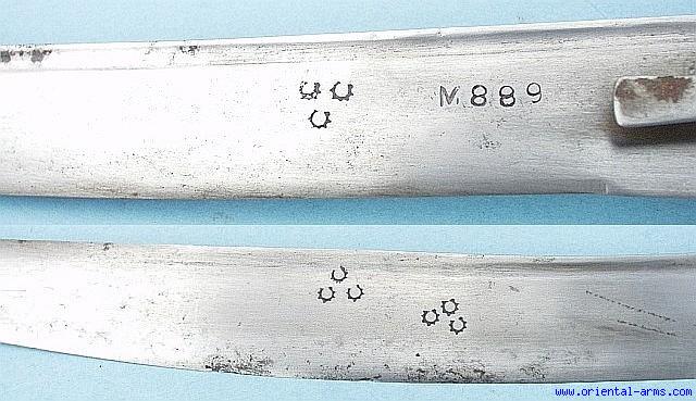

Below are two pictures from Artzi's site the first are markings on an Afghani Poulwar , the second (which has identical 'circle' markings as my own) is Indian and on the blade of a Tulwar.
As the Piso Podang has Indian influences I've been looking for a possible link with Tulwars and SEA......so far ...nothing
Regards David

Excellent note on the piso podang David! That indeed is an example of the tulwar in SEA regions, but this one is so profoundly different. As always, it seems I have seen something like this before, and as you have shown there are obviously more of them.
The toothed circle markings in the other examples you posted seem to be grouped in arrangements approximating markings seen on many European blades.. the grid of these are like some seen on 'firangi' blades, the others seem to reflect again the key numeric three.
While this toothed circle does of course appear on dhas as I have noted, this by no means suggests the mark is exclusive there as we know simple geometric marks appear in many cultural spheres with different meanings.
All the best,

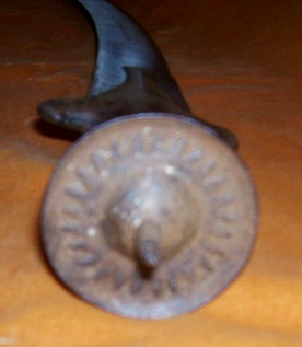

The disc pommel displays the Ashoka's dharma chakra, with 24 spokes (after Ashoka, the Great). Each spoke depicts one hour of the day, portraying the prevalence of righteousness all the 24 hour of it. It is displayed in the Indian Flag. So at least, I think, this sword started life as a Hindu weapon.

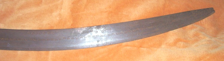

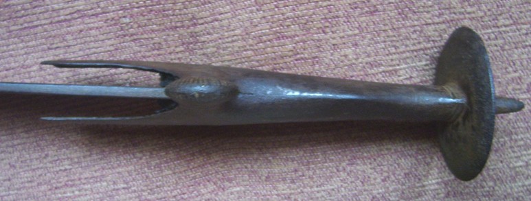

Interesting piece, The faint zig zag etc markings were identical on the ricasso of this peace I had at one time. It is now in an established private Sikh collection.
I presumed it was Sikh or Afghani from either, Punjab or NWF Border area or maybe even into Khyber or some such perhaps?
it was about 22 inches long , all wootz crystaline steel. Strangly found bricked up in an old English famhouse wall during re building. Bit of wicca/earth magic I suppose.
I thought it seemed a very old piece.

nice functional piece, unusual to have such a quality blade with a plain-ish hilt, 'bricked up in an old farm house' ..... strange but
I fairly certain that this Tulwar is Indian, the blade is fixed in the traditional
way (resin) and the hilt, although slightly unusual, is 'within' the range of normal size. When viewed from the top the 'width' widens as it reaches the langets, a feature I have not seen before.

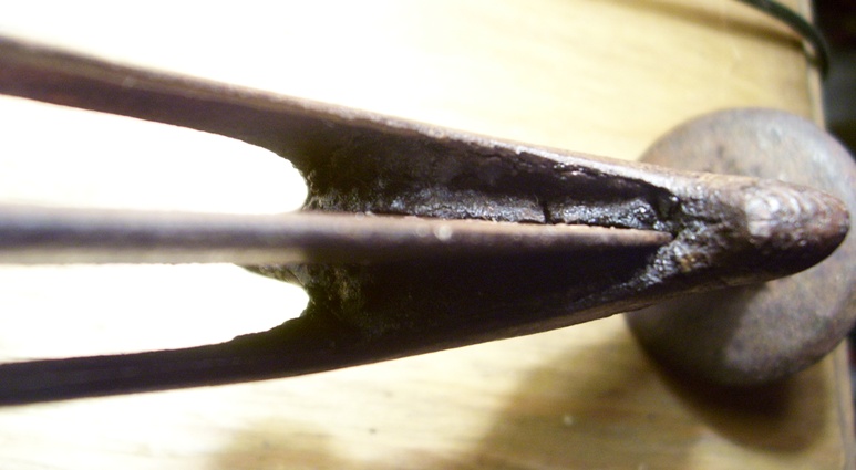

A gentle cleaning of the hilt ...to further remove some active (red) rust has revealed ...what appears to be silver plating.... approx. 60 % remains but is lightly pitted, there is evidence of some dark patterning on some of the remaining silver but is very faint / worn. I'll try and add pictures later.
Would the plating help ID the Region of India that this Tulwar may have originated ?

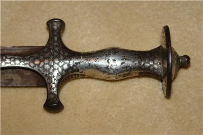

Some pics of the nearly cleaned hilt, certainly seems to be silver with faint remains of a 'fish scale' pattern (snake ? Naga ?) which does not show up clearly. I have found a picture of a similarly decorated hilt but mine is more 'scale-like'.
Seems that another decorative feature of the hilt ie the scales, could indicate associations with the sea
Please, has anyone any ideas as to origin ?
Kind Regards David
