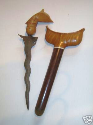

Hi All
Just won this little gem today. Can you let me know if you think it's a good one? I think it may need a mendak?

Lew, it looks like a peninsula piece to me so i'm sure that Shahrial or Kai Wee can put a better ID on it for you. The pics aren't too good, but it looks well crafted to me. Certainly worth more than you paid for it.
And what i think you need is a pendokok, not a mendak. Whatever is there in between the hilt and blade looks inappropriate to me.

Thanks Dave.
I just think there is some material coming up through the hilt and there is no metal there at all. Will post better pics when it arrives.

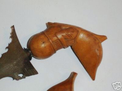

Here are some better pics of this small gem. It is going to need a nice pendokok to top it off.
Lew

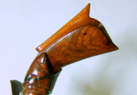

Just wanted too post an updated photo.
Lew
Old 20th January 2008, 03:29 AM   #6
Posts: 7,300
The pendokok still looks a wee bit too large, but i would imagine that it would be really hard to get a good fit with such a small keris unless you had one custom made.

Yes, it looks very much Peninsula (northern) or Pattani patrem. Blade looks like pandai saras type, not sure about the pamor though.....

Lew, sorry to see a gap for the pendokok...
Based on the carving style and blade material, the ensemble could probably be a souvenir piece from the northern peninsular, no pamor. Blade probably formed from a single piece of metal, without hardening. Lovely greneng and sheath, though.

Hi Alam Shah
Correct me if I am wrong but I have several patrems in my collection and one or two old ones have no pamor and are of one piece construction. As you noted the greneng work is very well done so why go through all that work for a souvenir piece? Most if not all tourist keris I have seen are of very poor quality when compared to this one.

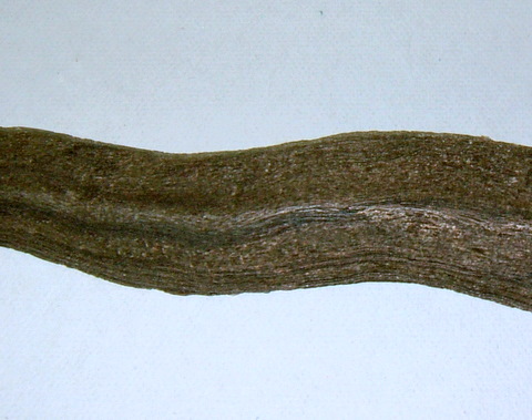

Lew,
The greneng works perhap to reflect the artistic nature of this piece. Compare the other 'keris pendek', (short keris) with this. Btw, what I meant by 'hardening' is actually 'tempering'. Can you take a closer shot of the base of the blade (sor-soran) area, the whole blade and a close-up of the blade tip. Souvenir pieces do have varying quality levels.
David,
True, there are many pamorless blades in the peninsular. I didn't mean that no pamor equals to a tourist blade, by default. There are many excellent pieces out there which are pamorless. Let see the close-up before I comment further... I've been wrong before.
What is your opinion on the piece that I've attached?
