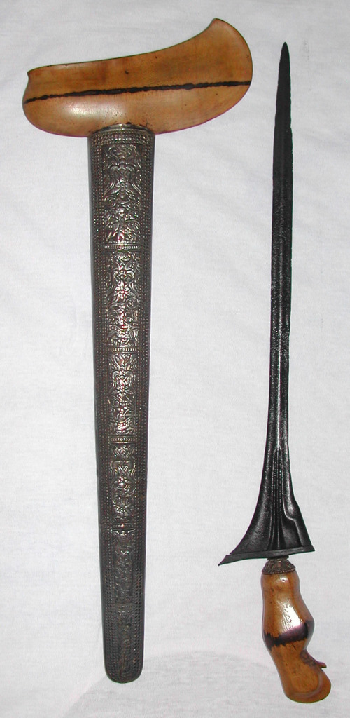

Here I have attached a shared photograph for discussion. The dapur is Jalak Sangu Tumpeng, probably the keris was made in Majapahit period (Mpu Sendang Sedayu made?). I am looking forward your opinion.

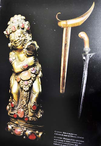

This Jalak Sangutumpeng in the picture, reminds me to the best jalak sangutumpeng picture I've seen in Musee de l'homme's book (Paris) some couple years ago. Picture below, the Musee de l'homme's jalak sangu tumpeng. I took reproduction from the museum's book some years ago...
Not so many jalak sangu tumpeng -- which has good 'garap' I've seen. Mostly, comes from supposed to be Mataram Senopaten (without pamor, but some with only very minimal pamor or "wulan-wulan" type pamor), and some of them supposed to be Majapahit tangguh, with very smooth, greyish-black blade...

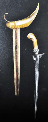

Here is the example for comparison, Karttikeya...

Karttikeya, based upon what I can see in the image you have posted, I feel that many people would be prepared to classify this keris as Tangguh Majapahit.
It possesses many of the features of form that align with a Majapahit classification, but the ganja is too straight and thin to conform to that which is expected in a Majapahit keris. The other indicators that I can see do echo Majapahit, but as is usually the case with questions of tangguh, I am reluctant to commit myself to an opinion based upon an image on a computer screen. When I say that the features "echo Majapahit", to my eye, these features appear to have been executed by a maker who had knowledge of the form of the indicators in a Majapahit keris, but who perhaps had never seen one.
In respect of the concept of tangguh.
This is a system of classification that was developed for a specific purpose. In the case of keris classified as a tangguh of the recent past, say within the last 300 to 400 years, it is possible that there could be a high level of agreement between the designated tangguh, and the era from which the tangguh name is taken. In the case of keris from the distant past this agreement between designated tangguh and era of the same name, is very, very dubious.
However, as with most things to do with the keris, we are dealing with a belief system, so for anybody who believes that a keris that is classifiable as a particular tangguh, was made during the era of the same name, so be it. For that person, it was.

With respect to Karttikeya's Jalak Sangu Tumpeng, I would opine it is a Mataram piece, most probably of Senopaten era, but with very significant Padjajaran outlook especially at the gandik...very slanting feature there (mboto rubuh)

Mr. Alan, thank you for your such explanantions..by the way, based on its design this keris comes from later period of Majapahit or probably older than Majapahit? If you do not mind, kindly give an opinion about this keris..thank you

What i see is a nice old keris with a certain presence in not quite as old nice dress. It is a keris i would welcome in my own collection. Does the sheath appear to have been made specifically for this keris?

Hi David, thanks for your appreciation..Yes, you are correct, I changed its original sheath because the original one has been damaged and bad appearance, heavily coated in thick oil and incense. Previously, this keris was claimed by the owner as Tumenggung (regent) Jogonegoro heirloom, that's why he treated this keris by offering incense and fragnance oil intensively, and actually hardly to remove it. After I got this keris, I think I need to change the sheath and more over to protect this keris from new rust.

I'm sorry Penangsang, but that keris cannot be classified as any of the Mataram sub-divisions.Mataram Senopaten does not look even vaguely like this keris. Not in the smallest degree.
A dominant feature of a keris that may be classified as tangguh Mataram is that the blumbangan is square.
The blumbangan in the keris under discussion is bata adeg.
It cannot be classified as Mataram of any type.
