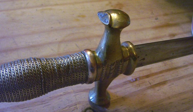

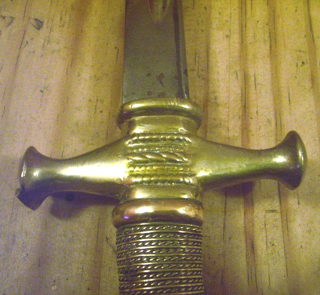

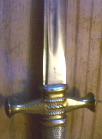

The crossguard with its Indo Persian style shows there once was a knucklebow. The blade is well tempered, twin fullered (thin one just below spine and a wider one below that. Evidence that the sword was shortened at some time (fullers extend to the tip) I assume due to damage.

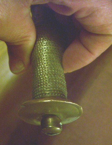

A threaded pommel nut is there but the tang has been 'peened over', handle is brass wire over wood.

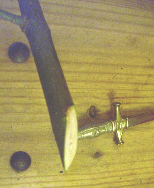

In fact, to pre-empt the cries of ceremonial, I did a spot of gardening ...or more acurately 'tree pruning'. The result of a single handed diagonal down strike is shown in one of the photos below ( not quite Tameshigiri ......branch diameter 1"/ 2.5 cms) Fortunately my neighbours are used to my 'gardening' with 'unusual' implements.

I should have included details of the blade....it has a slight curve..( not straight as the pics suggested.) Fullers seem forged (slight deformation of part of the narrower fuller caused by the wider one suggests this)

Despite the given resemblance in the quillon form and overall appearance of the hilt, I don't believe this sword has any connection to the Indian tulwar. It seems to be, as has been noted, a military regulation type sword of uncertain nationality, somewhat of forms used for non commissioned officers about mid 19th c. The brass hilts on these are in numerous variants as production companies industrialized and many outfitters catered to officers of specialized units and later military fraternal organizations.

The crossguard is puzzling, compared to a number of Tulwars I own, it is dimensionally 'accurate', and the way the original knucklebow connected to the crossguard (ie the cast shape at the 'junction' where 'bow' and guard meet) is identical. I still have been unable to find similar swords (with or without the knucklebow) ... the 'cable' design is probably a clue...but I have no idea as to the significance, if any .
I do feel that late 19th C is likely for this sword, and, finding info on 'WHITES'
has been fruit-less so I cannot be certain.

The 'Whites' marking may well suggest one of the many outfitters that existed in both England and in India providing such weapons to both British officers, and in some cases, British gentry in India. Possibly this sword may have been intended for such instance. The decoration at the center of the crosspiece is quite interesting, and may offer some clues as you suggest.
