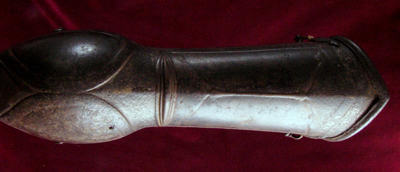

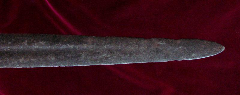

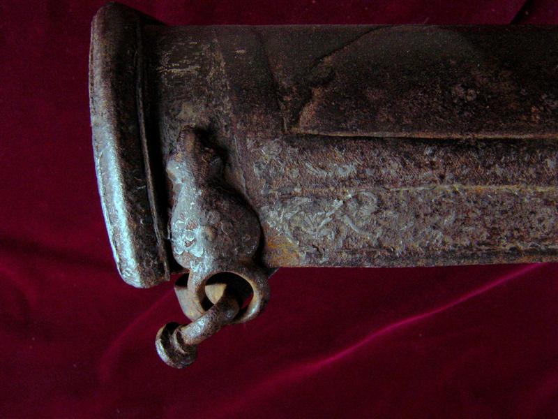

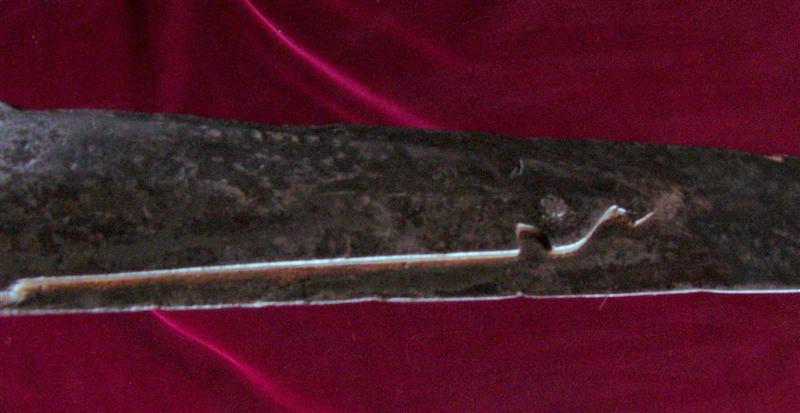

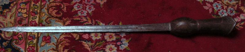

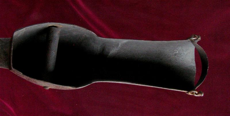

Just got my first Pata. It has a feel of really being used, more than abused. Seems like a real battle weapon. I am taken aback by the sheer size of this at almost 50" long. It has a very flexible blade. Is this common to Patas?
I belive 18th/19th c.
I have heard that these are cousins to katars. Any comments on this or the flexible blade?

Bill's example shown here seems to be quite battleworthy and from the photos appears quite likely 18th c. Highly flexible broadsword blades were favored for the slashing cuts, and seem to contradict the presumption that the pata was used as a lance type thrusting weapon.
Nice fighting example Bill !!
