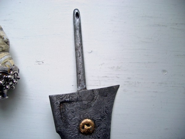

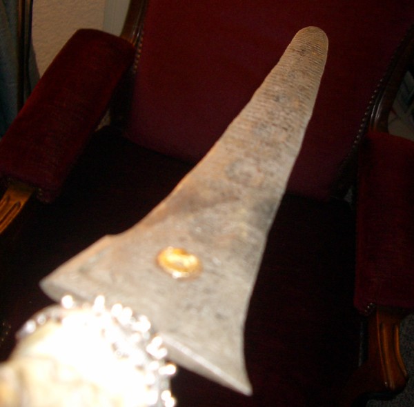

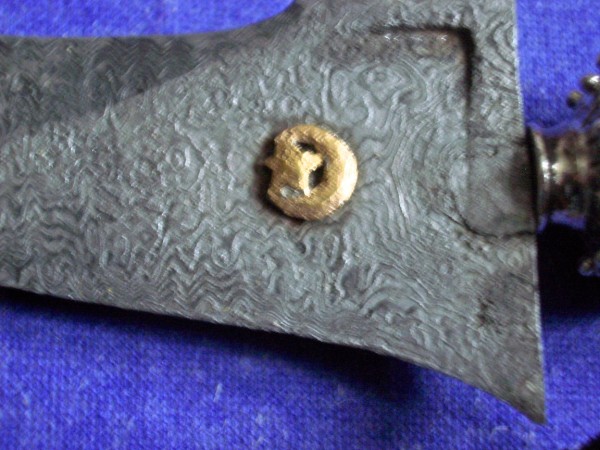

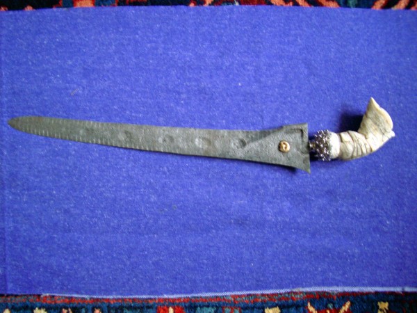

Question How would you define this kris

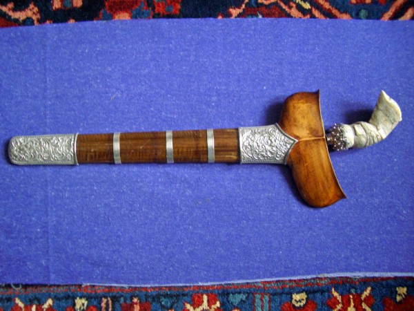

A kris sepukal, berpamur, ganja iras
Decorated with a star and a crescent.
Is it a paror beras wutah-gedhagan ? Does it has the attribute "picit", because of the finger marks ?

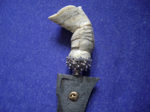

The hulu (grip) is in fossilized elephant molar
The sampir is in light wood and unfortunately painted but the silver decoration is well done.
The selut is modern, a Melacca cup and is from Kota Bahru
Can anyone guess or analyse :
The origin ?
The name of the pamor ?
The reason for the change of colour in the blade (close to the crescent/star)?
Possibly an age ? (<50 years ?)
Thanks a lot.
Michel

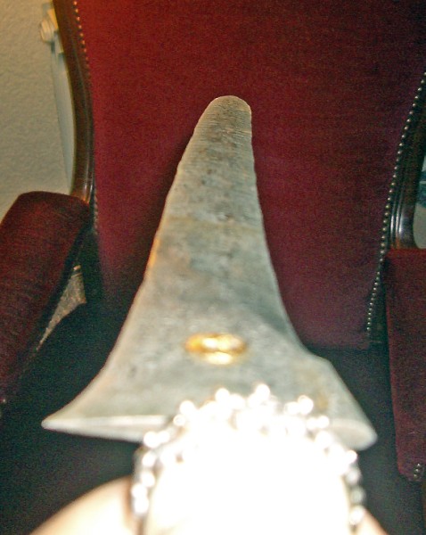

Hi Michel, interesting blade! I've had a change in colour similar to your blade and it's generally the border between hard and soft metal when the blade has been heat treated to harden and temper it, almost like a "hamon"

Default Heat treatment ?http://www.vikingsword.com/vb/newreply.php?do=newreply&noquote=1&p=51
Hi lemmythesmith,
A bit difficult to understand the strange position of this heat treatment ! No ?
Basically, I think you are right, the difference of colour is due to heat, but was it really a treatment to harden the metal or is it just an error ?
The forging is well done, look at the peksi, with its little hole and the heatwelding to the blade and the pamor, is not a simple one. I would love to be able to forge such a pamor .
I just do not understand that colour change.

I think it probably is the border between hard and soft metal, from what I've read on the forums(and it seems logical) the heat treatment is kept well away from the peksi which would be a weak point if made too hard. That pamor certainly is a nice one-grooves are cut with a file across the blade then the whole blade is flattened to bring the "veins" of metal in the bottom of the grooves to the surface. I'm currently building a patrem at the moment and thats how I got a similar pamor to your blade, the "stripes" look almost 3D in the right light. Cool!!!

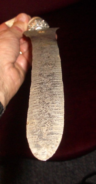

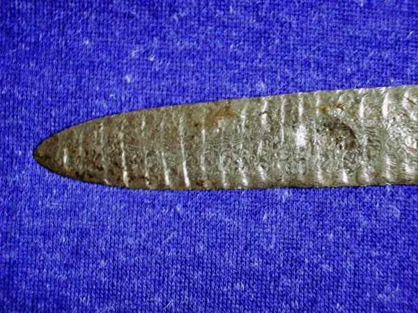

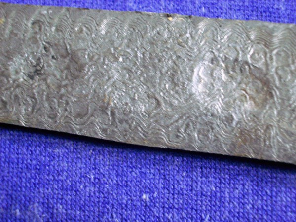

" This 'reflection' pattern, also a by product, precisely follows laddered grooves originally filed across the blade and reforged flat to create a pamor pattern with a series of adjacent concentric ellipses "
source :The world of the Javanese keris / Garret and Bronwen Solyom
The Javanese call this Nginden
* beautiful to look at,... for over and over again; play with the light in the sun or candle

When looking closely to my blade, I can see that the finger marks where hammered on a very hot blade, the opposite side of each finger marks being leveled on the anvil.
Lemmythesmith,
congratulation if you have forged such a pattern, you must master the heat welding fairly well. I understand the ladder filing, but what is the shape of the ingot and how are the metal layers ?

"nginden" means "chatoyant"---like a cat's eye. It looks different depending on the angle of the light---you can see this clearly demonstrated in photo # 55,56.
Yes, Solyom names the pamor in photo #57 as a mlumah pamor, which means it has been constructed with the pamor layers in the same plane as the core, that is, laying down on the core, rather than standing up on the core. Your blade, Michel, has had the basic pamor constructed by a "miring" technique, whereby the pamor layers have been manipulated in the forging process so that they are standing at (more or less) right angles to the core of the blade.
Both the blade shown by Solyom as #57, and your blade have then had the grooves cut in the face of the forging before the forging has been forged out to shape.

I reckon that this keris is called keris Beko by the Peninsular Malaysians and the Southern Thai, since this keris originated from those areas.
Sepukal in Malaysian / Thai context is actually a generic term for straight kerises, and it can be divided into several categories, i.e. the claw like Bugis Sepukal, the slim Pandai Saras Sepukal, the Tok Chu Sepukal, Charita Sepukal, Beko Sepukal etc.

If I understand you correctly, the pamor Mlumah is built parallel to the core and the pamor Miring is built perpendicular to the core. The miring technique requires a sizable pile of layers (as wide as the kris blade), sandwiching the core of the blade and that before being filed to give the waving aspect. Difficult to explain but I think that I get it.

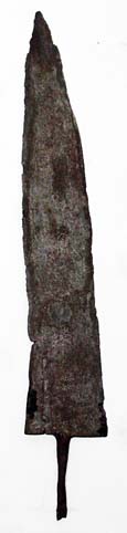

Default Pamor

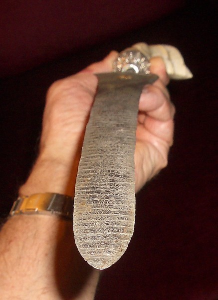

You may find a this type of reflection pamor on a kris from Pattani on the Krisdisk chapter10 fig 194 and a kris with a rather similar type of blade with pichit markings in the Krisdisk chapter 8 Fig 118.

Yes, your understanding of the difference between pamor mlumah and pamor miring is correct. The work involved in creating any pamor miring is multiples of that needed to create any pamor mlumah. Not only is the time and effort much greater to create pamor miring than it is to create pamor mlumah, but the level of skill required is also much greater.

Given this description i am confused as to why this blade would definitely be called keris beko. It certainly wasn't made to be a fighting blade, it definitely has a contrasting pamor and i am not so sure that the blade is particularly wide. Dimensions of the blade would be helpful.
Given the finger imprints (picit, pecetan), the hole in the pesi and the gold crescent and star i would venture that this is a purely talismanic blade. The hole might imply that it was never meant to have such dress, but was instead meant to hang in an auspicious place in the home.

the blade is 4 cm wide at the star/crescent decoration level and 2 cm before the the end of the blade.
The length is 31.5 cm, blade only without peksi.
A partial analysis:
1) A fighting keris ? The blade is 5mm thick in its center under the ganja iras. does it qualify for a description of a fighting keris ? A little thin for me.
I have 2 fighting keris (at least I consider them as such) their blades are 7.5 mm just below the ganja and their length is 31 and 31.5 cm but sturdy blades.
2)Dapur Jalak . There again my ignorance is a problem. Fom Keris Jawa antara Mistic dans Nalar, page 116, the dapur Jalak seems to describe a strait blade with a clear center edge. I do not understand exactly what PenangsangII meant, I had the intention to dig a bit in my books to learn.
3) the hole in the peksi was not meant to hang the blade. What was explained to me was that these holes were rare and were for royal family only and were generally on short keris pajang (< 45 cm), the ultimate finish was to have the hole at the end of a twisted peksi !
4) the others points of PenangsangII, are more or less respected:
short ganja, rounded tip, Wide mata not respected, witout contrasting pamor, (very interesting and correct. I do not see two metals),Jawa demam Patani style, the sheath saribulan or tebeng , (I do not know because again I do not know these Malay words and their meaning.)

hmmm....you don't? I see more than one metal here. I believe that if you stained this keris with warangan that it might become clearer to you.

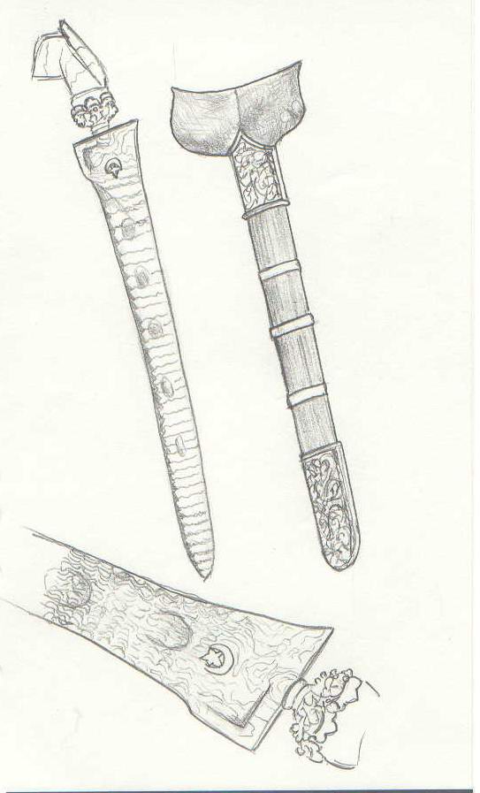

BTW, very nice sketch. You have some artistic talent.

Simply, the uploaded image is very good and rare keris. It is like a high class sombro in Jawa. Ganja iras, seven tumbs, twisted with a hole at the end of pesi. Two things I still wanna know:
Firstly, may I see the pictures of this keris taken not from right or left side but from front and rear sides (from the shape sides). I would like to know whether this keris has 7 curves (luks). Some keris, even it is a straight keris, uniquely having luks (curves) if it is watched from front and rear of the shape sides.
Secondly, after stained with warangan, I hope this keris shows chatoyant and "pamor udan mas wengkon nguntu walang tumpuk". Excellent!!!

Usmen, do you think that in spite of the dress that this keris is of Jawa origin?
I agree that is a beautifully crafted keris.
Old 23rd August 2007, 12:24 AM   #22
Posts: 7,255
Michel, I understand that as a French speaker you would prefer an Indonesian/French/Indonesian dictionary, however, the best dictionary for you would be, I believe, the two volume Echolls and Shadilly. Your English is more than adequate, and this dictionary is far and away the best in the marketplace. A new Indonesian/English dictionary appeared only a few months back, which has been promoted as the best ever, but it is expensive and I really don't think it is any better for practical use than Echolls and Shadilly.
I'm sorry, but this keris is not a Sombro. A hole at the end of the pesi does not a Sombro make. I'm with Michel on this one, that this hole can have a different meaning depending on where the keris is from.
One very well known keris writer of the recent past wanted this little hole to be for the fixing of a pin to hold the handle in place.
A good story about these holes in Sombros is that Mpu Sombro would produce a heap of blades, and then walk from village to village selling them. To allow her to carry them easily, she made the hole in the end of the tang so they could be strung on a cord for carrying. Ever seen one with a hole broken through? OK, according to the story that happened when a buyer wanted a keris that was in the middle of the string---rather than take off all the blades and restring them, Mpu Sombro just broke the eye.
Since these blades were and are talismanic, the hole was for suspension as a talisman.

Incidentally, Michel, this keris has had its pesi added after the forging of the blade, hasn't it?

The keris definitely has more than one metal composition, but the pamor metal is not contrasting type or in keris term pamor sanak. Sometimes only one type of metal used to forge a beko type keris.
I am not sure how you can tell this from pictures of a blade that is obvious out of stain. I have my doubts that this would turn out to be pamor sanak after a warangan treatment.
As for whether this keris would be "worthy enough for fighting", that simply is not the issue. Any semi-sharp and pointy piece of metal could be a useful martial aid in a pinch. But this "weapon" was obviously designed to be talismanic, not martial as can be seen by it's picit (pejetan) features.
Michel, i have been wondering, does the blade have a tight fit in the sheath or has it been adapted for this blade?
David,
It is hard to say whether this keris is Jawa origin or not. Perhaps, I still need to have a look from front and rear and if possible after stained.
Alan said that this keris is not a sombro. However, I think if it is finally not a sombro, the influence of sombro type is obvious. I hope this is not either sombro or Jawa origin. Why? Because it will be very interesting then, at least, now it can be used as an evidence of inter-relation amongst empu in south-east asia.
As Alan said, I also have a curiousity that the kind of steel of its pesi and its blade are different. It will be easier to know it after stained with arsenicum.
warm salam,
Usmen
I agree with Alan, this is not "sombro type keris",
Sombro type kerises are iras (one piece) type. And this is not. Things that people called "sombro type kerises" are usually very old and primitive. Almost no pamor or just "sanak" (not glitter). Please see these "sombro type" kerises (pictures) -- even they are probably made in different era. (Sorry, a little bit rusty. But someday, I'll clean them for you...). You may see the "spin" in the end of the pesi (tang) and also a hole or trace of hole in it.
The dhapur? Surely, this is a "brojol". The most simple dhapur in keris, with only one detail that shows the "gandhik" or front base of keris blade... The one with a hole in the gandhik, called "semar getak" or "semar betak" dhapur...
I agree with Alan too, about the stories on hole in sombro type kerises. In addition for the stories, some people in Java believed, that such "sombro type of kerises" were sold by Ni Mbok Sombro during the wandering (adventure) before becoming a well-known Pajajaran kingdom (West Java) empu. Ni Mbok Sombro, believed to sell these types of kerises in "pasar" (traditional markets, village market) as kitchen knives... This is just a peanut opinion, based on my simple knowledge on such kerises..
Ganjawulung
