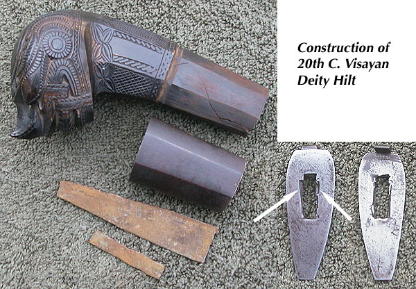

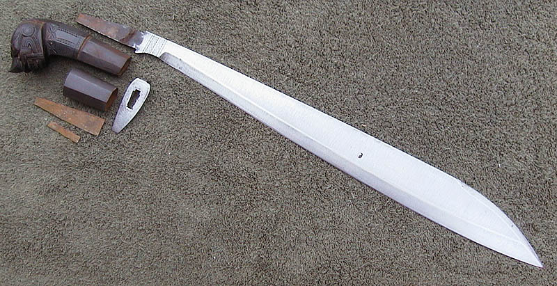

Thought I would post these pictures of a repair I did recently on a Visayan hilt because the original construction of the hilt was a little different from what I have seen previously.
The hilt was very loose and pulled off with little effort. What came from the cavity in the hilt was a mixture of rusty dust and small fragments of fibrous material. Adhering to the rectangular tang were further remnants of fabric of some type which bound two thin pieces of metal to either side of the tang. These thin strips seem to have been metal "shims" and the whole attachment of the hilt to the tang appears to have been largely a press fit over a padded and expanded tang. There may have been an adhesive in the mix originally, but when I removed the hilt the wooden cavity was devoid of any residual pitch or other adhesive.

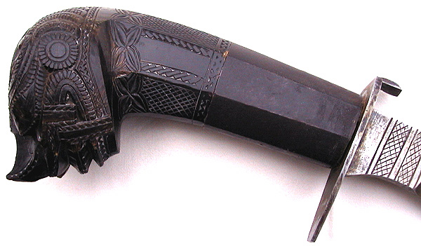

The first two pictures show the hilt disassembled. It is a large deity hilt that is associated with the island of Panay in the central Philippines (Visayas). There is a large octagonal ferrule and a small cross guard.
Closer inspection (second picture) shows notches in the top of the guard into which the metal "shims" may have fitted originally.

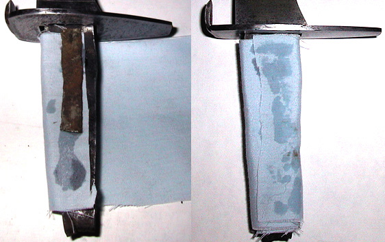

Well, I tried to repeat the original arrangment of the hilt. An old, well worn, cotton shirt was sacrificed for the fabric (my wife was more than happy to select the sacrificial garment from my "work" clothes). The thin metal strips were wrapped with the material and Super Glue held the arrangement in place. I was not entirely comfortable with a simple press fit, so used a little water soluble glue in the cavity to add some adhesion.
Here are pictures of the wrapping of the tang.

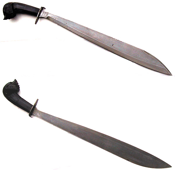

The fixing of the hilt is very stable and it all came together nicely.

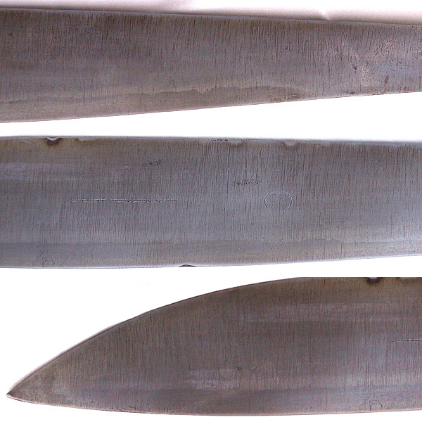

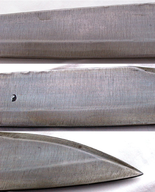

I also etched the blade (before putting on the handle) and found a very active pattern along the edge with a line of demarcation between the sharpened edge and the rest of the blade.
This has turned out a very nice Visayan sword, probably made in the early 20th C.

Excellent description of the work! That is a beautiful sword. Thanks Ian.

Great job on that binangon, Ian! Looks like a good solid fighting piece with a very nice blade. The repair looks great. There's only one thing I would have also done while you had the sword apart and that would have been to clean the ferrule. What material is the ferrule? It looks like it is heavily oxidized iron. When I have one of these swords apart with an iron ferrule, I usually soak the ferrule in a cup of straight vinegar for several hours or overnight to loosen the oxidation. Then with an old toothbrush, brass brush, or steel wool, I just brush off the rust. This leaves the ferrule in a raw metal state which is how it originally looked like. It just gives a nice contrast with the darker wood/carabao horn deity hilt. Here's a couple of tenegre hilts that originally had rusty/oxidized ferrules that I soaked in vinegar and cleaned off during restoration. This gives you an idea of what the ferrule looked like originally.

Thanks Zel. I will remember to do that next time. Actually my plan was to polish it back to bright. When I rubbed the ferrule with oil and 0000 steel wool, to remove some surface rust, I kinda liked the dark dull patina -- seemed to go with the dark wood.
Knowing now that these ferrules were usually kept polished and bright, I will certainly do that next time. Thanks for the tip about the vinegar!

BTW, note that the main direction of visible grind-lines is across the blade. We're often advised to always sand/grind/polish along blades, but this is by no means historically warranted. It is more after the nature of an aspect of modern Western Industrial culture, and is closely associated with the concept of invisible craftsmanship.
The oceanic SE Asian cutting sword tang is not, as it is sometimes called, flat. It is a rectangular-section wedge, tapered for width and often for thickness. Certainly the tightness of fit in the hilt does affect the solidity of the joint, and the degree to which the wedge effect is taken advantage of; some blades fit so tightly and well as to almost not require adhesive, while others are so loose there is no real wedge affect. Wood and iron are stronger than pitch and cloth; a tight fit is best if you ask me. On the other hand, there are those who praise the shock absorbtion of softer materials.
