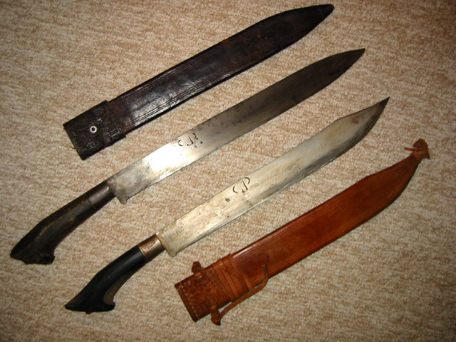

These are two of mine and I consider them working bolos the one on top is similar to yours.
Lew
