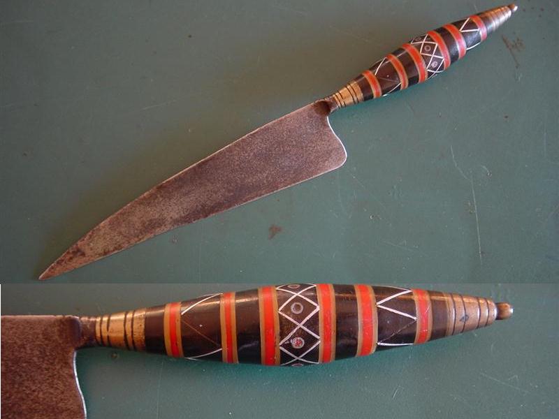

I don't have any knowledge on this type of knives.
The seller said is relative to the Canary Islands, from the XIX century.
Would the connoisseurs care to coment on this piece ?
Thanks a lot in advance

Not a typical Canary Islands blade but certainly similar. The back of this blade is more down curved than usual and it has a less pronounced "finger notch" adjacent to the hilt.
The hilt is consistent.
Ian.

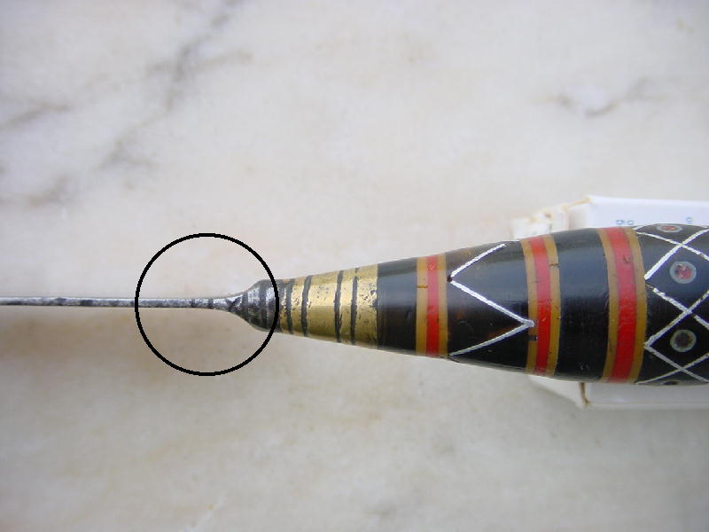

For the finding of its maker and age, eventual file marks on the blade back would be a track. I am posting here and there this new picture, to dig into such possibility.
I am also e-mailing an expert i found on these knives, to see whether the blade notch ( muesca ) was reduced by its owner for practical reasons, as the blade back being so curved due to double edge sharpening, or both these characteristics be simple variations of these knives model.
Thank you again ands best regards.
