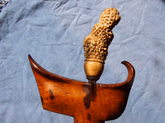

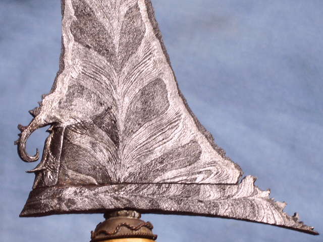

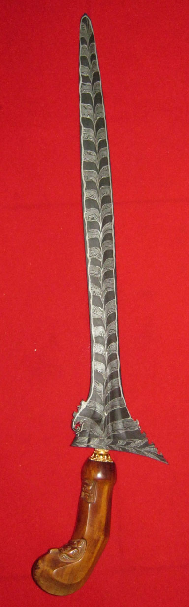

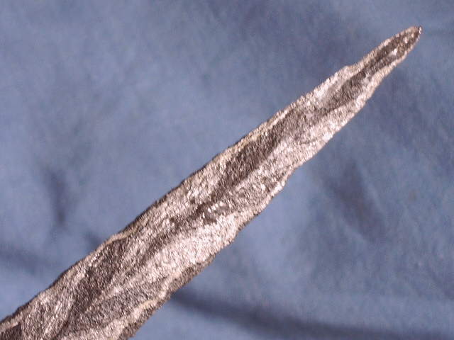

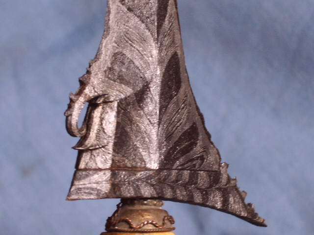

Dear All,
I wanted to share some bad pictures of this keris. It is a huge one, blade mesures 40 cm. It is becoming pretty impossible for less informed people like me to guess if a keris with such more elaborate pamor is old or aged, yet this one perhaps could have some age. The visible (inappropriate) staining is what stays visible after getting down the rust in a pinaple juice bath.
There is an interesting feature in the blumbangan on one side, a circle like these we discussed a while ago, yet in this case it could be something incidental.

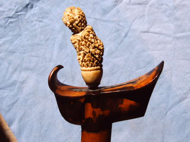

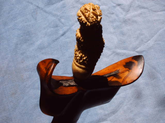

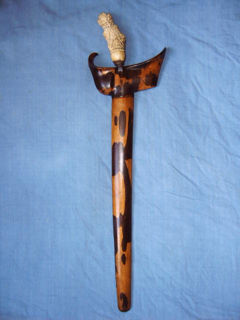

Wrongko is of pretty poor quality, on gambar most of the pelet is painted, on gandar all. Probably not the original one, yet for some time already together - buntut of gonjo of this keris is leaving a patinated impression.
Hilt is made from antler, with somewhat unusual shape and ornamentation for this type.

IMHO recent Madura (or Yogyia) manufacture..
I find the painted scabbard really fascinating...

What I said before refers to the blade. The hilt is Cirebon

I am unable to say if this is an old or artificially aged blade from the pictures but it is a nice blade. Also when the wrongko is partially painted it is in my eyes a nice typical East Java/Madura wrongko and I can't see why you think that it is from poor quality. The hilt isn't a Cirebon one but from the North-East coast or Madura IMHO. But the bulge at the right side is irritating, never seen something like this. I am curious what others with more knowledge than I am will say about this keris.

Gio and Sajen, thank you for your comments.
As I mentioned, I were not able to say, if this blade is old or recent. I just thought, I see here some features I never have noticed on blades of recent production, yet I am more or less familiar only with some things appearing on internet - a big handicap.
Yet I doubt, this blade could be made in Yogya.
I said "poor quality"regarding wrongko, becouse of the painted pelet, yet moreover the worn, thick edges of gambar.

I think the blade is in too good conditions to be considered old, moreover the nickel alloy is too bright. The uncommon bulge on the hilt could be due to the wish of the manufacturer to employ all the material available without discarding one part.
In my opinion the ensemble is very nice, the pamor is rather well controlled, and also the scabbard is not to throw away
Yes, I doubt as well that this blade could be made in Yogya; it's a typical East Java/Madura blade in a fitting dress.
Of course are wrongkos of this type ( I can't remeber the name for) not so graceful carved as ladrang wrongko's from Central Java but they have it's own flair. And like we say in german: "the beauty is in the eyes of the beholder".
I have in my collection only one keris of this type and I put much energy into it to restore the wrongko (Mendak not fitting). But most ones of this type I have seen were worked from pellet wood and some from this were painted what seems to be usual.

I think, Gio is wright regarding the bulge on hilt, it is simply the place of ramification, under the bulge the core of antler is visible. In any case, it is one of the most comfortable hilts I have had in my hand.

Pamor seems an opposite Ron Genduru (the same of a negative photo)
Old 25th June 2011, 01:41 PM   #12
Yes, so far you can see it on the pictures seems the blade "natural worn" and seems to have age. Pamor ron kendhuru, agree with Marco.

I calculated of course myself the possibility the blade could be new, actually about 75%. As Alan wrote, old blades with an elaborate pamor are very, very rare. I grumbled very long, if I could take this risk. I decided to do it, becouse I wanted to see and to study such pamor "live".

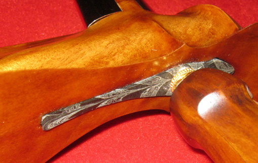

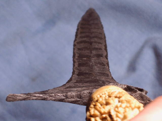

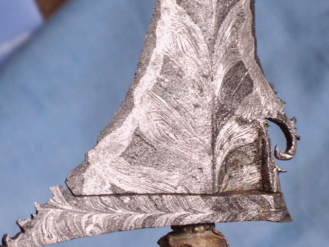

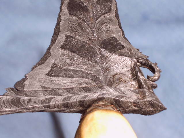

Here the somewhat better pictures I managed to take, for reference.

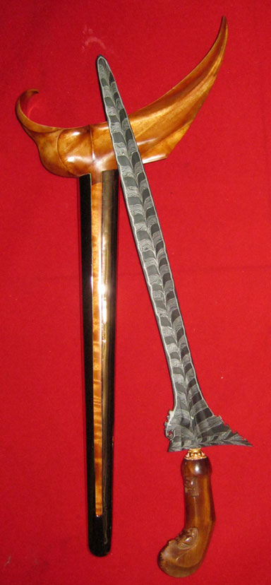

Old 12th July 2011, 06:32 PM   #16
dewaruci
dewaruci's Avatar
Join Date: Dec 2010
Location: Central Java
Posts: 13

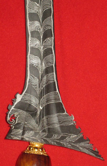

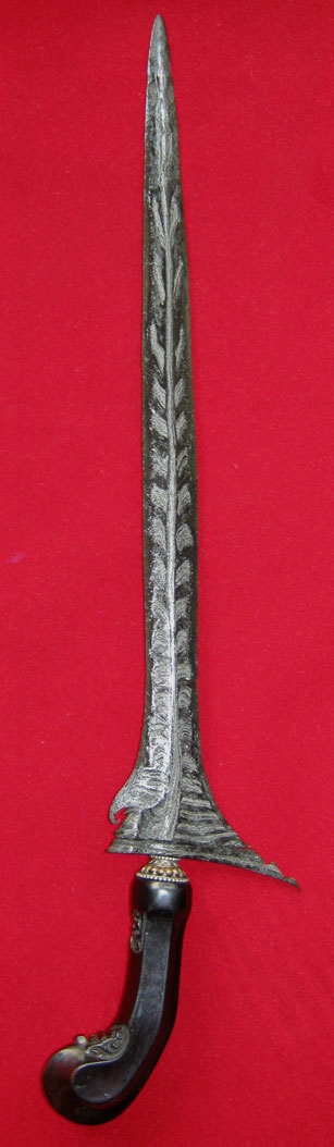

I thought the full name pamor 'ron kenduru wengkon", and I have one new keris in my colection, the blade from madura ( i ordered through my friend from madura), and one old keris pamor 'ron kenduru'
dewaruci is offline   Reply With Quote

Thank you, Dewaruci, for posting these keris. The new keris has remarkably good pamor control at the tip, such perfection probably wasn't achievable with old pamor forging methods.

I think I've seen perfection like this with the integrity of 95%. a keris from the era Pakubuwono (PB) belongs to my friend. In my knowledge, perfection like that also exist in old kris, but I've seen, not maintained, severe corrosion, many iron pamor are apart or lost, so that we can not see anymore the perfection.

I just want briefly to bring in focus the several ways to design the "white" parts of this pamor. There seem to be very different solutions, from classical parallel lines till a twisted pamor. On my keris there is a loop in each "palm leaf", interesting feature is, the layers inside this loop become there strongly diagonal, one almost get a feel of pamor mlumah there.
How is this done?
