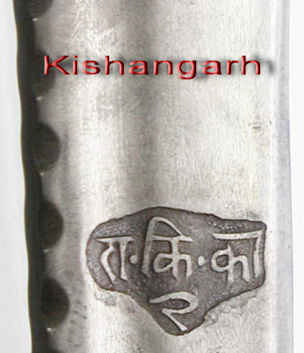

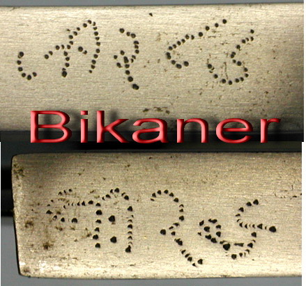

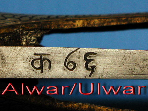

It is an interesting turn the discussion on Alex’s thread about the stamps has taken, but in order not to confuse the matters, I have decided to start a new thread on armoury marks. Anyone who has any armoury marks on their weapons, or who have any comments, please show the mark and comment on them.

You should also notice that not all armouries marked their weapons. I think it is fairly safe to say that the bigger armouries did, but it seems as if not even all of the bigger armouries did. Swords were more often marked than daggers, but the marks can also be seen on daggers.

This is excellent Jens, and thank you so much for not only taking this topic to another thread, but for the beautifully done illustrations and labeling them. This will give us a core of known markings that I hope we can add to as more examples and evidence become known.
Regarding the umbrella marking, what is the alam, significance? Sorry I keep forgetting these things but cannot locate in resources at hand. I think you are right that these umbrella stamped markings were used by rulers or extremely high rank court officials possibly, but still wonder if they might have significance as quality marking, i.e. of the quality of a blade made for a king etc.
