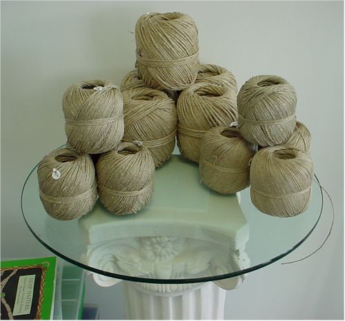

I once received the advise to put some wax (furniture-wax/bees-wax) on the wrapping, in order to avoid it taking up moisture and thus expanding.
That was advised in combination with hemp - wire.
The hemp wire adsorbs the wax, but still has a rough texture.
Good luck !
Old 22nd May 2007, 04:17 PM   #6
asomotif
asomotif's Avatar
Join Date: Nov 2006
Posts: 2,238
hemp wire
