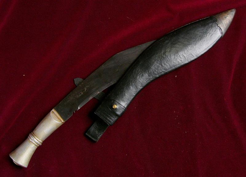

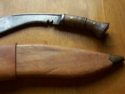

Yesterday a fake MK2 was sold on Ebay for $400+!! So I thought I would post mine with correct markings, grip, and scabbard.
Cheers
bbjw

Thanks BBJW good idea. Mine are also WWI (John Powell provenance). Scabbards are recent, but should be faithful copies.

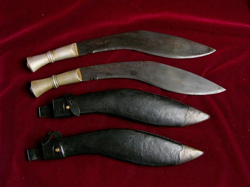

Here 3 mk. 2s a typical Co. made 1917 , at top, a Queeta Bros. mk.2 in the middle, and a m.43 at the bottom.
