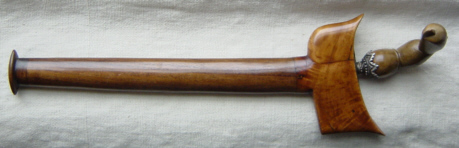

Have I been a mug?

Hmmm, let's see better pictures of the piece when it comes, please.
Judging from the available pictures, looks like a composite keris...
but subject to confirmation from better pictures.
A close-up of the base area of the blade and bigger full-length of the blade, would help.

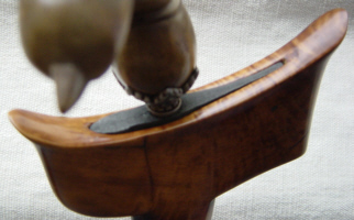

Hi Tim, the small eBay pictures were misleading.
I was expecting to see two properly formed grooves (sogokan depan and sogokan belakang) at the bottom centre of the blade, not two lines of what seems to be formed by a grinder and looked unfinished.
The nice part of this ensemble is, the hilt ring (pendokok). A Malay Straits model. Although it looks new, it's well-formed.

I am not trying to pull this back from the abyss but this side of the blade shows some signs of forging and folding so I am not sure it has been wholly ground to shape. It is still brand new though.

What I can see in the pics you have provided is a village quality blade, a fairly decent old wrongko, a fair average quality handle, and a pendongkok that I believe will test as silver.
I can also see the price you paid.
In my opinion you recieved very good value for what you paid.
It is a fact of life that in this world we pretty much get what we pay for. High quality, old is going to cost good money, no matter where it comes from, including ebay. Yes, we all know of the exceptions to this, but those exceptions , to my knowledge, have been achieved by very, very knowledgeable people who are prepared to gamble on something that looks like it might be good, and then get rid of it if it is not.
Sleep easy Tim. You did OK.

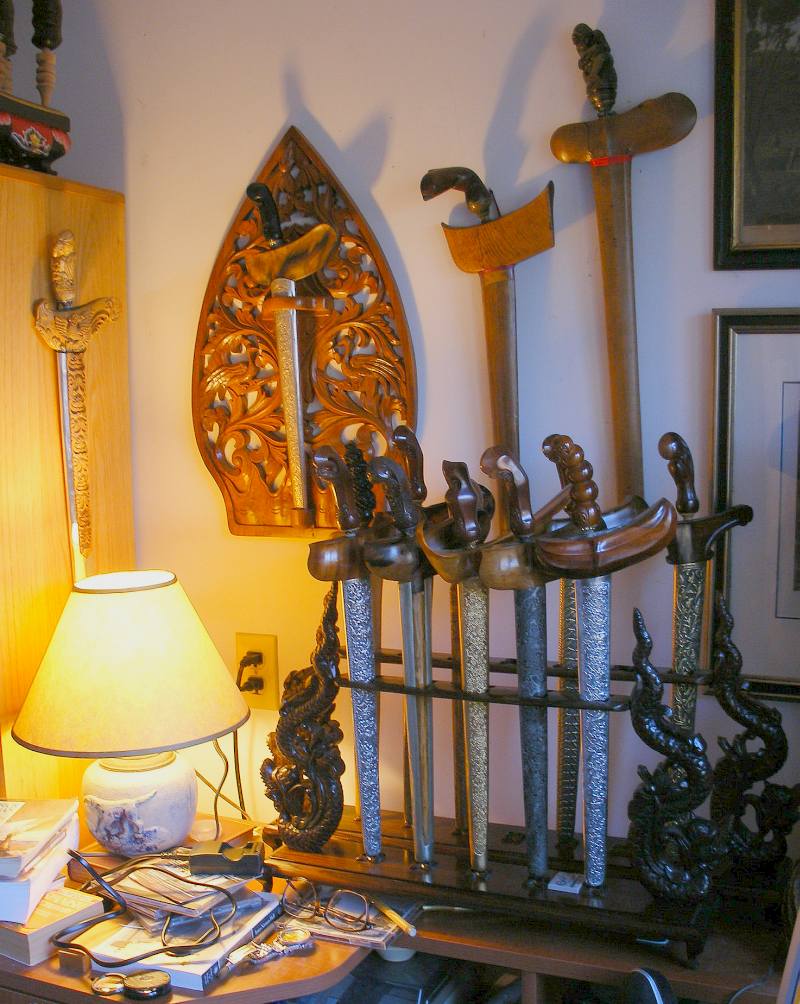

Then the inevitable result; the Addict's hovel...
Old 3rd December 2006, 03:42 PM   #27
Posts: 7,303
hhhmmmm....if i am not mistaken there appears to be room for a couple of more on that back rack...
