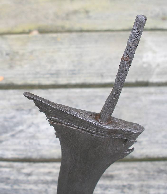

Hi Michel, I'm not too sure what you mean by angle in this case .
This first example I've posted seems to be pretty much at a 90 degree angle to the ganja.
Or do you mean the attitude or angle the keris blade assumes when dressed as shown in the second picture ?

Thanks for your answer. There are two angles to consider:
The first that you mentioned with your first picture: is not 90°. It is systematically slightly off 90°.
The second is the clearly seen on your second picture : If you prolonged the Axe of the ganja you have clear angle with the Axe of the blade.

There are actually a couple of angles involved here.
There is the angle that is formed by the base of the blade with the pesi, without the gonjo, and there is the form of the top of the gonjo.
Where the thickness of the gonjo stays the same on each side of the pesi, the angle of gonjo to pesi will remain the same as the angle of blade base to pesi.
The angle of pesi to the blade base in a modern keris varies from the angle of pesi to blade base in the keris buda. I proposed the idea some time ago that this variation occurred because of a basic difference in the way in which the keris buda, and its forebears, was held, and the way in which a modern keris was held. The keris buda was held in a way that allowed a strong downwards stabbing action to be used; the modern keris is held in a fencing grip that favours a thrust.
I think that you will find the angles of pesi to blade axis set out in my "Origin" paper.
The related angle, or perhaps more correctly, "form" is the form of the top of the gonjo. This form dictates the form of the top of the wrongko, and the form of the top of the wrongko is probably dictated by stylistic convention from era to era.This stylistic convention flows on to the desired appearance of the keris when worn.Maybe this becomes a "chicken & egg" question. Did the court stylists first determine thay wanted a larger curve and a more flamboyant wrongko, or did the court empus first decide that a more highly curved gonjo looked sexier?Or did they all work together to decide this direction?
In the making of a keris, this angle of the pesi to the blade axis is determined by measuring the keris bakalan against a grid and setting the place on the bakalan for the point, and the place on the bakalan for the centre of the pesi; once these two points are set, the line for the base of the blade can be established. It is not a haphazard thing done by measuring with the eye, it is really done with a great deal of precision.

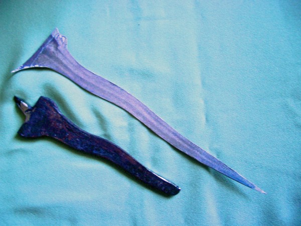

I have a few problems to follow exactly your methodology for forging a keris, as I started making an exercise of heat welding that we transformed at a later stage into a blade and a blade not big enough to make a normal keris but only a patrem.
I than had to find a good example of a patrem. I found it on Alam Shah site where he had one nice patrem with not too many luk and a thin and elegant blade, but no way to establish the angle between the pesi and the blade and a very special kerdas hilt.
As you have seen on the photo, I do not have enough metal for the ganja and I will be iconoclastic again and forge it from a separate layered piece with no nickel. I will do my best to have this ganja as esthetically acceptable as possible. The example of Alam Shah, looks fine for me.
I will have some difficulties with the selection of the hilt and sheath shapes. My inclination would be to make a hilt Jogjakarta or Surakarta style with a sheath ladrang, but I may be completely heretical with such a combination.
