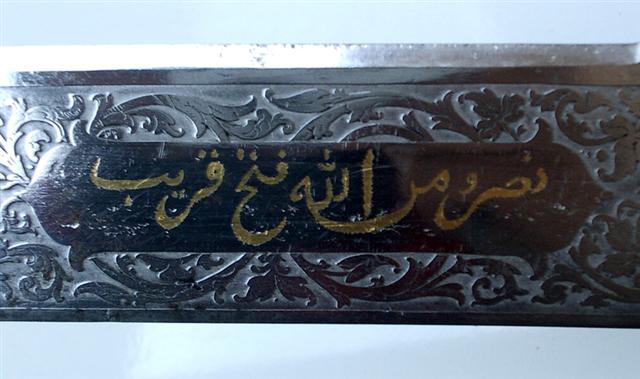

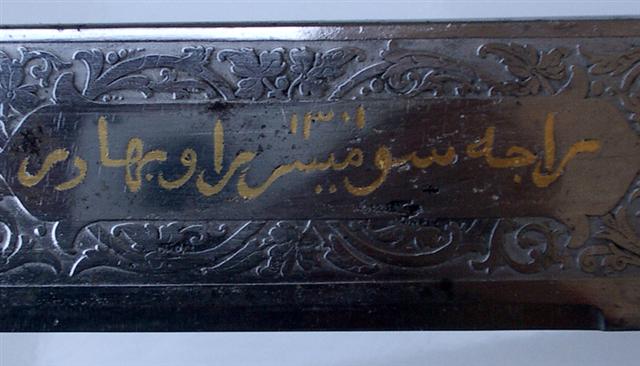

One side is Arabic and the other Urdu?

The inscription in the upper (first) image in this thread reads:
"Help from God and victory near"
It is part of a verse from the Qur'an, the rest of it (not illustrated here so I do not know if actually appears on the object in question) is:
"Bring the glad tidings to the believers".
I don't recognize the language of the lower inscription, although it uses the Arabic alphabet. Above it is a date.

The date that appears above the inscription in the lower image is AH (anno hegirae) 1301, which is the equivalent to AD 1884.
To do the calculation, take the AH year, multiply by 0.97, and then add 622 to the result. In this case, you get 1883.97 which can be rounded to the next whole number.
The bases of the conversion are:
1. Muslims measure their era from the date of the Hegira (the Prophet's flight from Mecca to Medina in the year AD 622.
2. The factor of 0.97 is, for common purposes, an accurate and convenient way of adjusting from the Islamic lunar to the Gregorian solar year.

Hello Tabarzin,
The Urdu side reads....
Rājē Sūmiser Rāv Bāharī
This should be name meaning The ruler/ a noble Sūmiser Rāv Bāharī
Translation complements of Manouchehr
Can you get a clearer photo of the rest of the inscription under the langets?
rand
