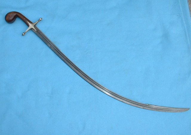

Though not mine, I would be grateful for any comments on Ottoman shamshir below. I am thinking it is mid-late 19th Century, and perhaps a Turkish version of the "revival" swords of Qajar Persia, in this case a classical kilij. The blade is not wootz, or damas, though seems of quite good quality. There is script thoughout, and some rather common markings...but a lot of them! The brass knobs have been removed form the pommel, and replaced with some sort of beads. Thanks for any input.

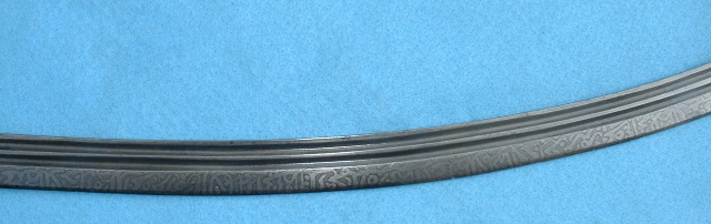

The blade form, with its raised "yelman" or back-edge, would indicate a kilij, not a shamshir. Blades with yelmans and radiused tip contours are associated with the Ottoman Empire. Although on rather rare occasions one sees a Persian saber whose blade has a back-edge, such examples still exhibit the markedly tapering profile and acute point that are characteristic of a shamshir.
On the specimen illustrated in this post, the style of the hilt is typically Ottoman. Based upon this characteristic, and the shape of the blade, there does not seem to be any connection with Qajar saber types, either original or revival.

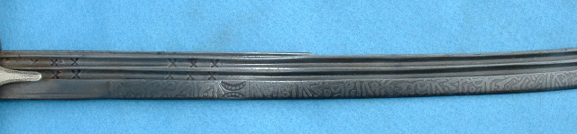

The blade on this piece is decorated with etched calligraphic motifs. There are two die-struck "eyelash" marks, and X stamps in the fullers, which are common on European blades made for the Eastern market. One can also see that a long central section of the spine is "sunken", i.e. at a level below that of the forte and the yelman. This latter characteristic is seen on a number of Eastern European sabers. A remarkably similar blade, minus the markings, is seen on a Polish "karabela" saber (Historisches Museum der Stadt Wien, inv. no. 126244) published in W. Zablocki, CIECIA PRAWDZIWA SZABLA (Warsaw: Wydanictwo Sport i Turystika, 1988), pp 208-9. A closely-related specimen is on pp 206-7 (same collection, inv. no. 127454). That one is interesting for a dorsal fuller on the sunken central section, which parallels a Chinese example (Metropolitan Museum of Art, acc. no. 36.25.1473a,b); I discussed this and their Polish counterparts in my article "Some Notable Sabers of the Qing Dynasty at the Met. Mus. of Art", MET. MUS. JOURNAL, Vol 36/2001.
The position of the "eyelash" markings on the blade posted by Charles is rather close to the edge, which suggests that the edge may have been considerably ground down during its working life.
Over the years I have seen a fair number of European saber blades, mostly of the broad, multifullered hussar type, mounted in Ottoman hilts. It is possible that these were hilted up for issue to units in the Balkans, considering the proximity of that region to those parts of Europe in which those blades were so widely used.

Very accurate remarks Philip! I liked specially this about the proximity of the “eyelash” to the edge. The etched Damascus (or calligraphy) is also in strange place by the edge. Any work for sharpening this blade would destroy it. So I agree that it could be wider when it was made. Or this blade was made from the beginning for dress, not for fighting.

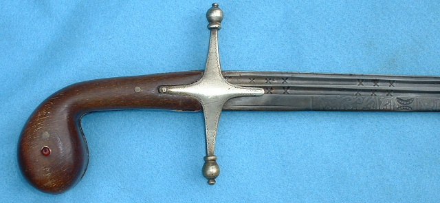

Blade and guard are very clean for the age. Very interesting hilt, with big bubble. It looks like rhino!
Charles, is it possible a close photo of hilt and another one under the guard, where hilt connects to blade? Is there any scabbard?

This is an interesting sword, and Philip’s comments and references very good. I do however have one ‘but’, if the blade has been sharpened down to the width it has to day, would it not have been broader close to the hilt – the first 2-3 cm?
If this is so, and the fact that it cant take more sharpening, it looks like a dress sword to me.

To call it a dress sword doesn't neccessarily mean it lacks any of the capabilities of a simpler piece (there is, as I've said before, no readable or consistant inclination either way on this issue of falsely equating fance with either quality or its lack). Is the blade sharp? I think it's original width, and I don't think that placing either the struck or etched marks where resharpenings would potentially eface them is all that unusual. In addition to the no untoward uneveness in the edge issue, the general lack of wear, and the handle matching the blade width, there is the front groove at the forte, whose placement seems original.

I'm struck by the red necklace-type bead in the center of the hilt, which seems very uncharacteristic for a sword of this type, more inclined to be found in a Moroccan or N African sword than in an Ottoman sword.

Sharp eye! I watched it as close as I could. My idea is that the “eye” is a replacement. I think it used to be another ornament there. Possibly a small silver plaque of a “tear” design. The color around this small hole is little different than the rest of the hilt. Also I am more pro of a rhino horn hilt.

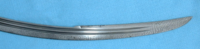

Based upon the position of the eyelash markings at present, and comparison of its general proportions (including fuller width and spacing vis-a-vis the spine and edge) to other blades of its ilk which I have personally examined and/or seen in photos over many years, I still believe that the blade of this one has been ground down, most likely PRIOR to being mounted in its present hilt.
It is very likely that the narrowing of the blade (skilfully executed, to harmonize with the spine) was done at the same time the calligraphy was etched into the surface.
Kilij and shamshir blades have relatively diminutive tangs (generally no more than 3 1/2 in. long and about 2/3 the width of the blade) which are rivetted to an iron plate which has the contours of the hilt itself. A peripheral band or strap is brazed or soldered around the plate, and the gripscales rest upon the band, being held in place by rivets running through matching holes in the iron plate. The plate is invariably wider than the blade tang, and thus a tang can be attached a bit "off center", or even filed down on one side, to compensate for the loss of some width at the edge and thus end up being centered on the finished hilt.
There are also cases which I have seen in which the tang itself has been replaced; the old one (originally forged as an extension of the blade billet) replaced with a separate unit, whose forward end is cleft to accept the blade and perhaps just a nub of the original tang, to provide enough contact surface for a good forge-weld. In this way, the new tang can be made to be centered on whatever width the altered blade may happen to be.
The small short groove in the area corresponding to the ricasso may well have been cut after the blade was narrowed. On blades which I have studied which have this feature and all/most of their original width, this groove tends to be somewhat wider and deeper.

In looking at this beautiful parabolic shamshir type blade, with pronounced yelman which as Philip has noted more categorizes this in the 'kilic' group, I am with Mike in thinking of North Africa.
As has also been noted by Philip, the triple X marking derives from European trade blades, particularly German. It seems that this symbolism had certain parallels in early occult/cabalistic devices and that three crosses were in apothecary connotation cautionary for deadly substances. Whether or not this application is relevant, it seems interesting to note. As often occurs on trade or native blades, multiplication of symbols presumably were thought to increase potency.
Also, this kilic blade seems much more a horsemans blade than the much shorter and clearly heavier and less parabolic blade of the Turkish kilic most commonly seen. This brings to mind the Mamluk sabres of the end of the 18th c. which of course were from Egypt. It is interesting that the etching on the blade resembles 'thuluth' which was commonly applied to edged weapons in Sudanese regions in the last quarter of the 19th century. Since these regions closest to Egypt were under Ottoman suzerainty at that time, it would seem plausible that a Mamluk type blade could have been remounted or joined with this hilt. The 'thuluth' motif might have then been applied, including the 'dukari' or opposed crescent moons marking that although commonly associated with the Saharan 'takouba', is also known to occur of Sudanese kaskaras with the thuluth application.
The fact that this marking is applied close to the cutting edge, as well as the application of 'thuluth' motif would suggest that this was done as addition to an existing blade and around the fullering. The central location of the 'moons' also concurs with location on thuluth covered kaskaras attributed in Briggs article to the Hausa's.
These suppositions are presuming that this etched decorative motif is in fact 'thuluth' as described, and not other similar motif. Since it is noted this has no inclinations toward Persian revival type pieces, it would seem unlikely that the calligraphy would be 'naskh' , a Persian form of this motif .

Although a little unusual, it looks like this bead is made of cornelian (better closeups can show more) and this semi-precious stone is not unheard of in Ottoman jewelry or other pieces (archer's rings for example made of cornelian). I'm with Phillip with Ottoman origins.
