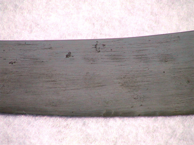

i posted this pira a couple weeks ago and i finally got to etched it this past weekend. well, i found out that it is indeed laminated and i believe it is what you folks refer to as sandwich type lamination (due to the edge erosion)? what i don't get are the horizontal lines that's running parallel to the blade. what are those and could someone tell what type of metal was used for the blade? is this an older or newer blade? thanks in advance...

Spunger , I would suggest that the lines you see are tool marks left from smoothing and shaping the blade .

Rick's right; those are grind marks original to the production of the item; when the surface was patinaed they were not as readily visible, and now that it is clean they become more noticeable.

BTW, I can't tell in the photo, but that may be a welded edge or it may be a hardening line. If it is a sandwich/"san mai" type constuction, the edge steel (an antiquitous term is the "bit") will be visible running down the center of the spine as well. On the other hand, it could be an inlaid (dogged-in, pinch-welded, qiangong) edge that was welded into a slit in the blade. It seems like a fairly light etch (?) and while I could probably tell you if I examined the sword, I just can't be sure from the photo. Moro swords I've seen the temper lines on tend to be hardened in a wider zone than that line, and to be fairly straight lines formed by the blade being only quenched to that depth. If this is a temper line it would have pretty much had to be made with the clay method, but very similar temper lines are seen on Visayan swords, and things have a way of getting around the neighborhood. Is this a very old sword? It doesn't look like most of the old ones I've seen, and I don't see any folding, which is what I was expecting before your photos came up, but that's something that, if fairly homogenous, often only becomes clear on a deeper etch.

It is hard to tell for sure. What makes it look sandwiched to me are the lines of lighter color running to the edge just to the right of center. The first from the left looks like it might be a crack, but the second and third look like they are threads of the outer layer continuing to the edge, which would happen if there was a crease or other depression in the middle layer at that point that was filled with metal from the outer layer during forging.

I'm glad you addressed those lines; I wondered about them, but couldn't decide if they were cracks, layers like you said, places where the etch got resisted by something on the surface of the blade, or flaws (although gaps and waves can be deliberate) in a temper line. As you can see, I can fit what I see of them into any theory with equal realism, so while I found them interesting, I had nothing useful to say about them.....

I can say with certaintly they are scratches from surface removal (grinding/polishing). They have nothing to do with lamination. Nice piece.

thank you for everyone's responses. i guess i have to etch it further to get a better assessment. btw, those perpindicular lines on the edge are cracks. i hope that helps for now...

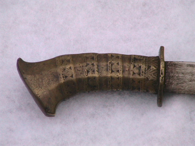

Can we get a close-up of the hilt? I've never seen a pira with a hilt like that before, but I have on a bangkung. Nice sword! Did you get this in the Philippines?

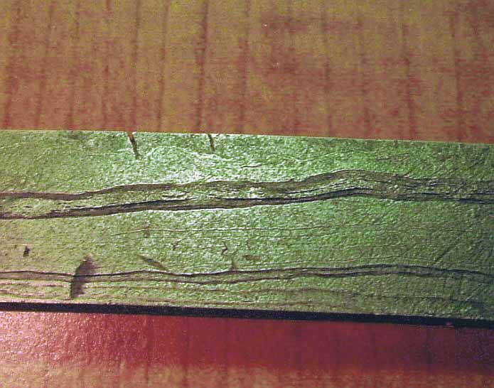

Maybe Rich would know ; I have heard these cracks referred to as 'tired steel' by a nihonto collector .

Really? Tired steel in my experience more commonly refers to a Japanese blade that has been repolished beyond the top skin steel, allowing lower regions that weren't meant to show to do so.

More edge cracking :

here's a close up of the hilt. b'laan, i believe. btw, yes, this was from my last trip...

So this is a non-Moro hilt, yes? An animist hilt, yes?

yes. lumad tribe...

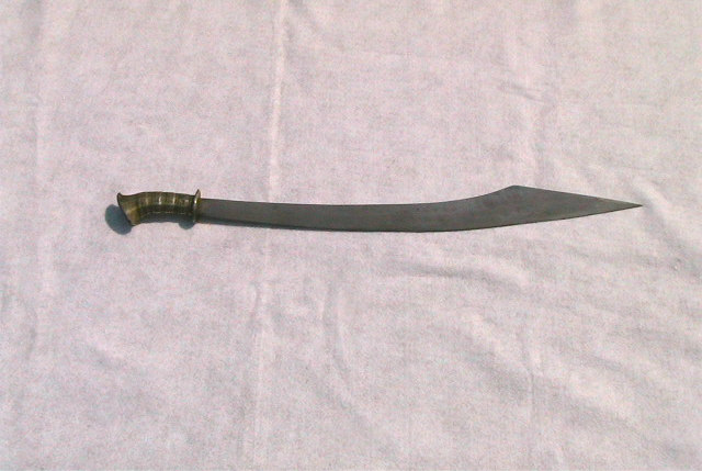

i tried to etch the blade this past weekend; not much, hopefully this'll give you folks more clue...
