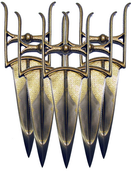

The katar on the picture is from Tanjore. What makes me wonder is, when the Indians exported so many ingots from south India, why were these blades not made of wootz?
Could it be, that the steel was wootz, but was heated so the pattern disappeared, or did they use another kind of steel?
If yes, why when they had plenty of wootz?

Hi Jens. Normally, I would suggest that non-wootz was cheaper to produce. However, this katar exhibits exceptional workmanship, so cost seems an unlikely reason.
Is this an isolated instance, or are weapons from Tanjore typically not wootz?

I have found that with Katars they often would leave the wootz pattern in the fullering but the edges were often polished bright. In your example, I would not be surprised if the steel within the fullering turned out to be wootz and then the edges were polished bright. Since the deep fullers are a hard area to clean when the Katar receives a cleaning or polishing, I can see the wootz over a long period of time "fading" away.

Hi Andrew. You are probably right, that non-wootz blades was cheaper to make, but like you also write, that with the work put into making the katar, it does not make any sense to save a bit on the blade.
I cannot remember, ever to have seen one of these south Indian blades, with a lot of fullers having a wootz pattern.

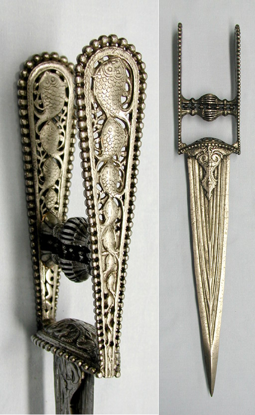

RSword, what you describe is the katars with fever fullers, if any at all, often seen more to the north, where the middle of the blade is etched but the edges polished.
The type you describe is like the ones on the picture.
Gene, I think the failing wootz pattern is due to the many fullers. You probably will not be able to see the wootz pattern very well, if at all if it is grey, with all the fullers, maybe it would even make the blade look strange.
I don’t know why it is so, but it is worth looking into, to se if there is a ‘pattern’.
As you can see, the side guards are decorated in steel ‘pearls’ and fish, which had a special symbolic meaning to them, the funny think is, that the fish have eyes on both the inner and outer side. Between the two cross guards you can see seven small wheels, and in each of the cross guards a steel ball is rolling. When you get ‘Hindu Arms and Ritual’ by Robert Elgood, have a look on page 161 and read about the fish on page 134-5.

Actually I was referring to the S Indian ones. I will have to dig up a picture of a Tanjore example that I had with similar fullering as your example but the wootz was quite vivid in the fullers and the edges were polished bright. I suspected the hand guard was also wootz but no pattern was visible there either. Let me dig around and find that and share a pic.
