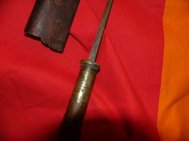

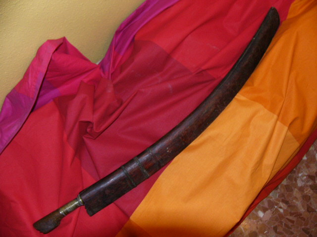

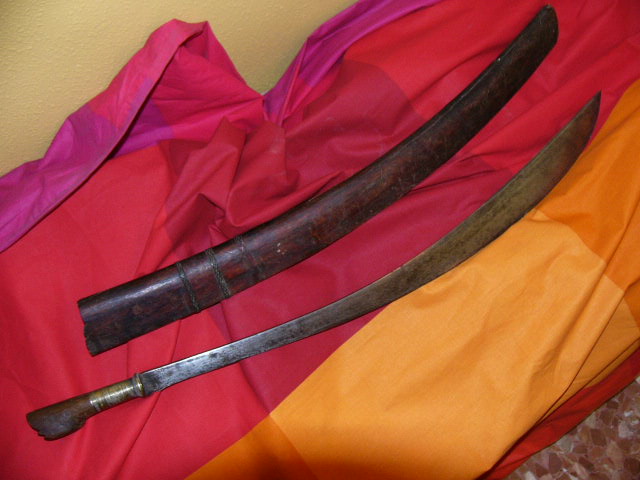

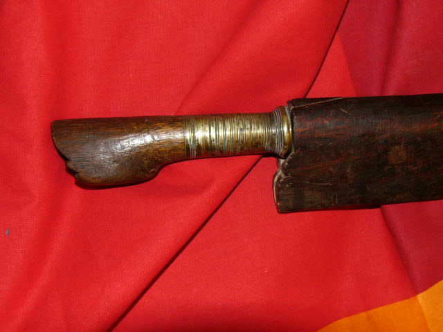

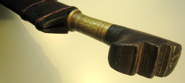

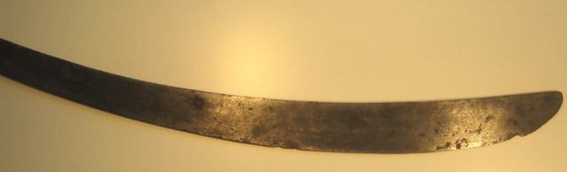

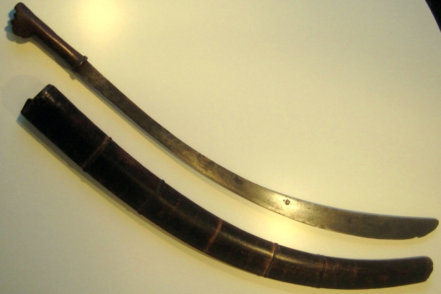

THIS IS MY LAST ADQUISITION, A VERY STRONG SWORD, I THINH IS FROM BORNEO, LENGHT OF THE BLADE, 28,5 INC, SCABBARD IS A VERY LIGHT WOOD AND THE BLADE IS VERY THICK, O.4 INCH.
THANKS!!
CARLOS

It's an old Parang Pedang. The hilt shows a lot of wear but the rest seems
to be in good shape.

An nice parang from North Borneo
Ben

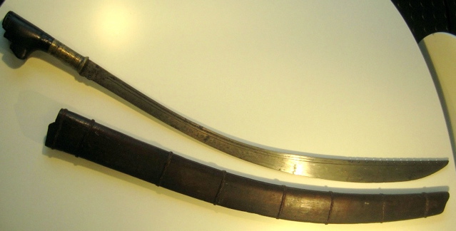

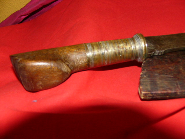

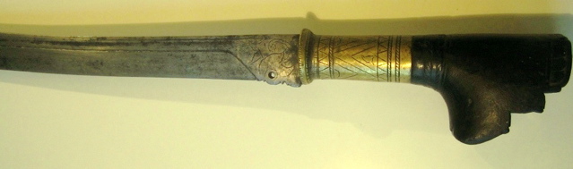

Below are two of mine.
The first one (maybe mid 19th C) looks more like it could be Iban?

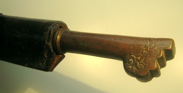

The second, and probably oldest (maybe late 18th C?) is unique in that it has a brass hilt.

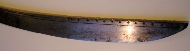

I have often wondered about the significance of the linear dots along the blade back, has there been any consensus on if any particular meaning is applied? Also it seems some are filled with brass, while some remain simply open dots.
Thanks again,
All the best,

There are several explanations of the dots - all of them talismanic and/or magic depending on which tribe and culture.

Hi Michael that one with the bronze handle looks like Iban it looks a lot like the it was before the parang niabor and this one does surprise me if it was not end 1700
the other one has same brass collar as we see on the murut swords
so that one maybe used by muruts aera
I see some mandau handle s in bronze
Ben
