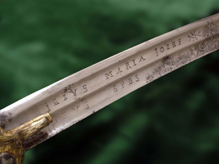

Question Blades and horseshoes??!!
Dear Friends!
Some of you have a real great mettalurgical and mettalography knowledge so I hope you'll coment this thread.
I just have read an excerpt of new "Guide for collectors" just printed in Poland, with chapter on weapons written by one famous person, whose name I would like to keep in secret for a while (I have my reasons, sorry).
In section devoted to Polish sabres the Author wrote something like this (my translation):
"Hussars sabre (...) has excellent blade of average curvature, with fullers and often with devotion inscriptions like IEZVS MARIA IOZEF. As a material used for this blades were often horseshoes, which were forged in "natural way" during the horse run".
This is new to me!
Have you heard of using horseshoe for a blade.
and what about "natural forging" on the horses hoof?
Below hussars sabre blade with inscription IEZVS MARIA IOZEF
Regards!

Wolviex, please, what is the translation of the inscription IEZVS MARIA IOZEF?

The full inscription on the blade is IEZVS MARIA IOZEF DEVS SPES MEA where "V" is made as "U" - it is easier to engrave or stamp, and "I" as "J". It means in English "JESUS MARY JOSEPH, GOD IS MY HOPE".

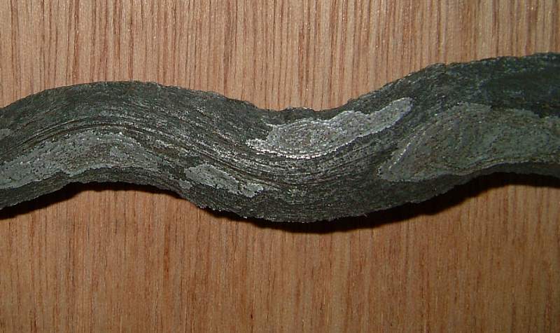

Possibly this picture of a section of an ancient keris blade may illustrate this wrought iron stranding phenomenon.
