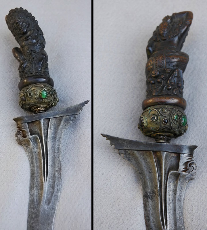

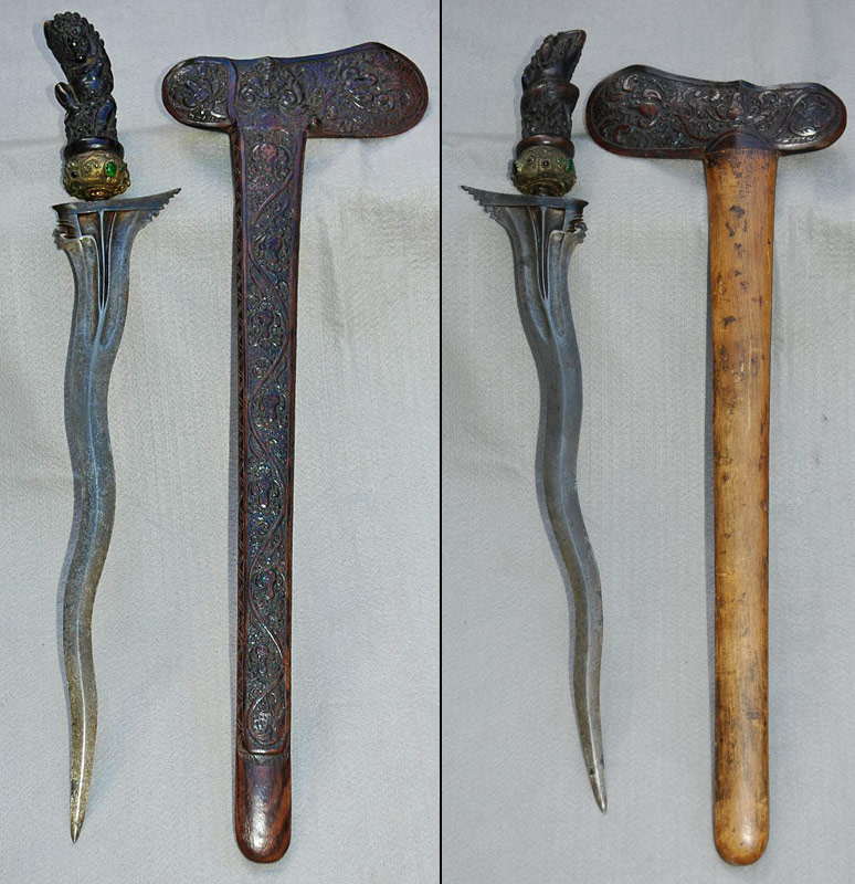

Hi, I'm new to the forum. Am a long time knife collector, but a novice with ethnographic blades.
My grandfather lived and traveled in Indonesia back in the 50's and brought this back as a souvenir. I remember sneaking into his den and playing with it when I was a boy. When he died I inherited it.
I posted some photos on another knife collecting forum and was told that it was a Balinese kris, that the mounting was modern, but the blade may be older. (How much 'older' was not indicated). That's pretty much all I know about the sword.
I would be happy to get any additional info as to when or where it might have been made, if it is of any particular style, and any info as to who the little figure depicts. I don't plan to ever sell the sword as it has personal value, but I'd like to know if this is a poor example of the type or a good one.
I would also like to know if it would be recommended to clean or treat the blade as is the custom. I can see a limited amount of the pamor, but it is certainly not bold as many of the blades I have been seeing. With most knife collecting, I have learned to leave it as is, but it appears that refinishing the blade is accepted practice with the keris. I'd like to know what the experts would do with a keris like this.
Thanks for your help. DD

Hello Daniel, welcome to the forum.
This does look like a Bali keris, I can't really tell the dapur (shape)besides that it has 7 luk and a nice prabot (chiselled details) which looks very nice and well done. I've been wanting to get one for a long time, I think they're magnificent.
It would be nice to get a high-contrast pamor out of this keris, but the cleaning is quite an involved process, and unless you're ready to dabble with chemistry and use some arsenic-based warangan solution, it'd be nice to find someone who can do it for you. I've tried contacting some chemistry professors at my university for assistance, but no luck yet.
The hilt figure is a Raksasa demon I believe, and it sort of looks like many of the new ones on ebay. The scabbard also looks much too busily decorated to me, but that's just an opinion based on very little contact with keris.
You'll get lots of much better info soon from those who know

Hmmm, I count only 5 waves .
I wonder if the entire suite might be mid-20th C.

Ah here's a similar one: http://old.blades.free.fr/keris/coll...bali/kba07.htm very much like yours...and the scabbard could be authentic it seems.
Oops, right Rick, I looked at the wrong picture and didn't see which side I was looking at
How worn do old Balinese blades get? Do they get the jagged edges of old Javanese blades after many cleanings?

Welcome Daniel. Sorry to counter you Manolo, but this is a 5 luk(curve) keris, not 7. The number is reached by counting the inside of the curve and alternating from one side to the other. It is, indeed, Balinese and i would agree that the blade is older than the dress. The dress was probably contempory to the time your granddad picked this keris up. It is not very high end, but i think it is a step above the "tourist" dress being made today. Edward Frey identifies this type of dress as being for a barong dance keris, but they seem to also be common for sale to tourists. I don't believe the figure is meant to be a raksasa, but may be a form of a rice deity whose name alludes me at the moment. Someone here will no doubt know. Note that he holds a sheath of rice over his shoulder. The blade is much nicer than the dress, though it is hard to say how much nicer since it is "out of stain" and it is hard to judge the pamor(pattern) work. Age is always difficult to determine, but i would put this one in the 19th century and it may be as old around the middle of that century.
I don't know if there is anyone in your area that can do this work, but it would be really nice to see this keris cleaned and restained. Re-staining would be what i would do with it since you have asked and you are correct that it is the tradition to do so. Old Bali keris are getting very hard to find so i would say this one is a keeper.

To me the blade doesn't look like it has been forged just before being picked up. I believe the workmanship on the prabot details is average at most for Balinese standards - it's a nice blade though! (I yet have to come across a genuine keris Bali blade which I don't like... )
My best guess would be first half of the 20th century (19th c. seems also possible). I'd be interested to hear wether this piece shows any details which would specifically indicate 19th c. or otherwise.
Anyway, congrats Daniel - that's a really nice start for a keris collection!
This is a good question Kai, and it is not something which has been written up very much AFAIK. My reasoning for dating this one a little bit earlier might be completely off-base. I have noticed that pretty much all of my Bali keris tend to rise up in a slight curve at the tail end of the gonjo towards the body of the blade. This angle often follows though into forming part of the greneng. This gonjo, however, goes straight across. I have one older Bali keris that does this (could be early - mid 19thC), but i haven't seen it this way on 20thC Bali keris. Could be i just haven't seen enough. Of course, this gonjo is meatier than the one on my older keris, which seems more the style as we move towards the 20thC. Frankly not enough serious work has been done on how to date these keris. Maybe Alan has some ideas.
Kai, i agree that this keris is standard for Bali quality. There is nothing particularly extrordinary about it. But as you say, i love any genuine Bali blade and this one is certainly nice enough to hold on to.

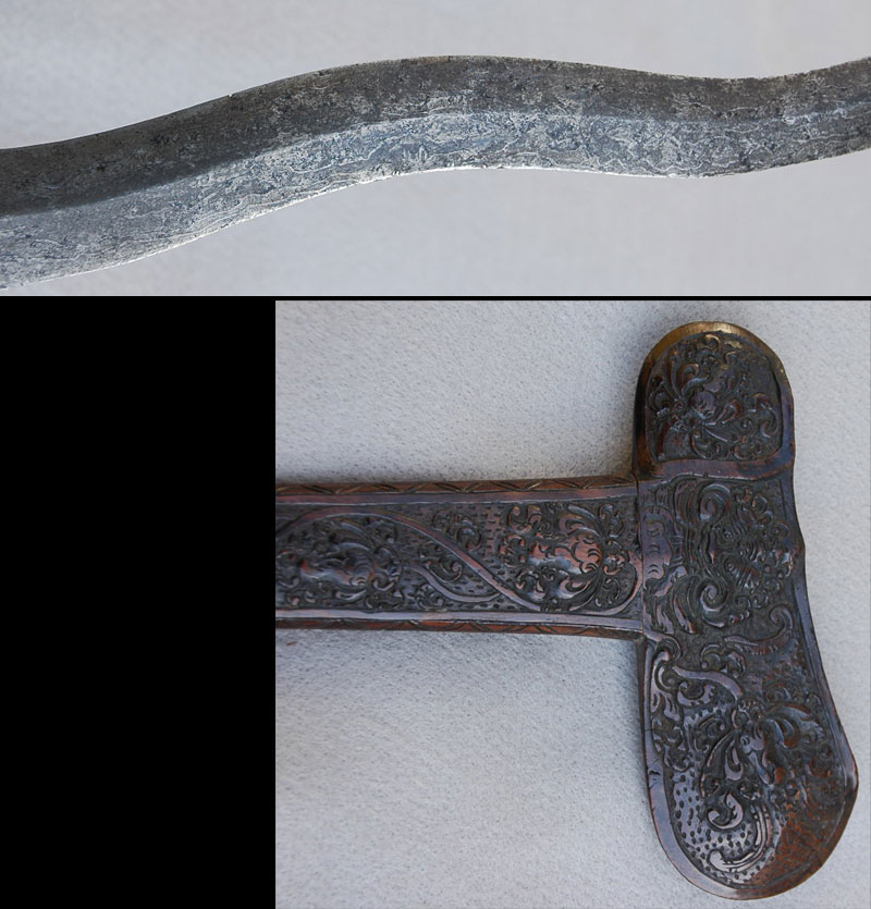

I guess it's a gut feeling; the garap seems a bit hurried and uneven; also the pamor (what I can see of it) looks like pamors found on 20thC examples.

Stylistically this keris is Bali, there is no doubt of that, but as Rick points out the pamor does not really look much like the pamor we associate with Bali.The workmanship is a little on the rough side for Bali,but we should remember that not everybody could afford the work of a top maker. I suspect that the gonjo might be a replacement---not because of the different material, that is not unusual, but because of the variation in the greneng and the lack of flow under the sirah cecak.I believe it would pre-date WWII, because to the best of my knowledge no keris were made in Bali from at least the time of the Japanese occupation, perhaps earlier, until recent times.

Thanks Alan. You and Rick have better eyes than i do for the possible pamor pattern on this keris. Maybe that "gut feeling" of yours is working well. Your theory that the gonjo might be a replacement was something i hadn't thought about and might explain why it fits differently than most 20thC Bali keris. Still i wonder why a keris that is only 70-80 yrs. old would be in need of a replacement gonjo.
