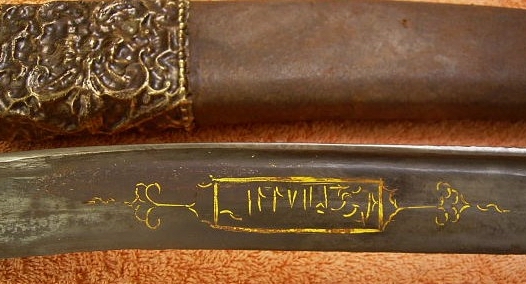

Hi, first I would like to thank this forum, its a very informative place that I just happened to find and I am very pleased. I have this yataghan but I do not know what its origin is, the date is stamped on it but it might be a reproduction, but I do not know. It does have the scabbard which is of leather and the total length of the sword is 31 inches roughly with the blade being 25 and the handle 5 inche. overall its in really good condition, and the hilt is also of a dark horn. any and all help in this yataghan would be appreciated, thanks again.

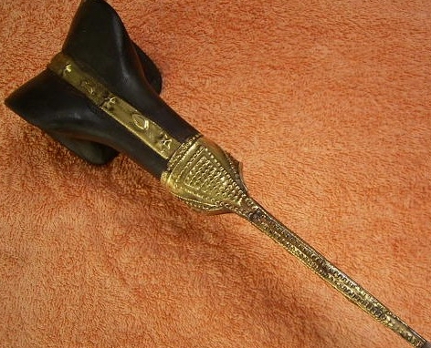

here are some additional pictures. thanks

I think that the blade and the brass parts are real. The date (1227) corresponds to 1812 Gregorian. The brass parts seem to be of Balkan tradition, but this is debatable. Would be interesting to know whether the inscription makes much sense.
I am quite uncomfortable with the horn handle: it is very peculiar in form, crude in execution and generally the ugliest I've ever seen. I think it is a newly-made replacement executed by a person with no great knowledge of traditional Yataghan handles. The scabbard seems to be a replacement, although brass throat might have been recycled.
Of interest,the same seller just sold another one with the same date executed in a very similar style/handwriting and with similar scabbard. A more "military" model. I am puzzled by the similarities between the two examples: they look like coming from the same "shop".

Don't assume that this means you have a "reproduction". This could be a reasonably old blade that has been modified with various "enhancements" over time. It could be that the original scabbard rotted and was replaced, and that the grips were broken from use. This is very common and a part of a weapon's story. Take heart, man.
-d

I am sorry to say this, but there are quite a few modern reproductions of yataghans made nowadays in Bulgaria, which have similar black horn hilts and brass fittings. Often the bladesmiths who produce them create them according to their own taste without much regard to authentic styles. As the seller is one who sells antiques dug in Bulgaria, there is a possibility that you have an authentic blade that has been given to one of those contemporary bladesmiths, who rehilted it and created a scabbard for it. Here are pictures of a modern yataghan/sheppard's knife I have, in order to show you some similarities:
Of course, I can be wrong, and even if I am right, this does not mean that you need to be unhappy with this yataghan. After all, the blade appears to be authentic and quite nice, and if you do not like the hilt and the scabbard, you can easily get it rehilted in a more traditional manner. Actually, I would be more than happy to have this yataghan for its blade, and if you acquired it because you liked it for one reason or another, then the question about value is irrelevant.

The blade is real, no doubt at all. Many truly old swords had their parts fixed, modified, replaced etc in the course of their rather eventful lives.
The main drift of my note was to draw attention to a rather new (for me, at least!) phenomenon: a possible existence of a Bulgarian "antique fixing shops". Apparently, it was a known fact....
Overall, you did not overpay much (if at all), and should be very content with your acquisition. Even if you got screwed by an unscrupulous seller.... well... I do not think there is a single Forumite here who never had this miserable experience.

I have to agree about the not being much overpriced, if at all and the fact that it's a newer hilt and scabbard, as there's a good chance that the old ones were completely or nearly so rotted away, or else they'd have simply left it as it was.
It IS unfortunate that they weren't redone in an authentic style though, with so many patterns from that region available and likewise I see the point about the date being suspicious, but even here it looks to be somewhere in the general area and not several hyndred years off as I would expect if they were trying to make a killing.

well, i received the sword finally, and it is a quite bad reproduction as you can get. people be warry of this ebay seller "vegas and germany", the sheath has been distressed with a chemical so that the "new stained" wood and leather would look old. and the inscription on the blade is painted on with yellow paint, looked a lot better in pictures. the blade also looks new and not a true original. the brass work is also quite poor and a novice job. i guess this one wont be hung up on my wall with pride. ahaha. just a warning out to others to be carefull.

Thanks for warning us, it appears that this seller, unfortunatelly, is as a complete a crook as one can get. I am really sorry about what happened to you. The worst part of all is that this particular seller is still selling forgeries on eBay, usually for a very high price (he sold a similar yataghan just a few days ago for over $300). I do not think that even if we notify eBay, they will do anything, as they make their profits from the sellers (that is why the Chinese are still there and nobody does anything to stop auctions starting at $.99 with S&H of $100). It is just too bad.
