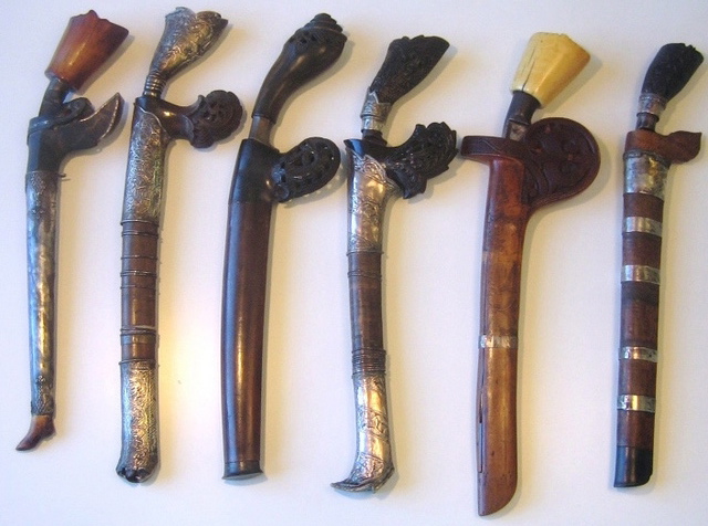

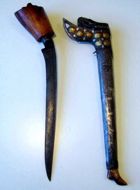

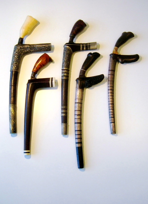

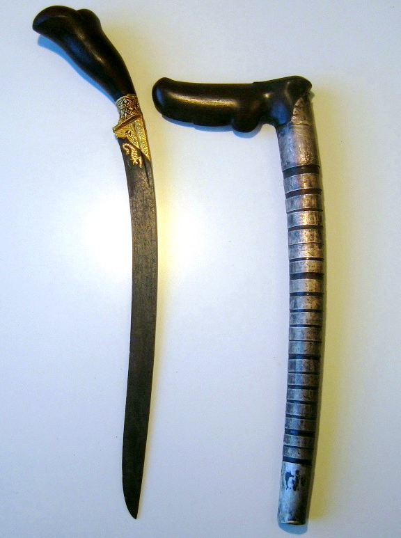

Hi all,
I have just uploaded my Tumbok Lada collection at Kampungnet.
The two Gayo versions are obvious but do you recognise where the other variations come from?
Detail pictures at http://www.kampungnet.com.sg/modules...view_album.php

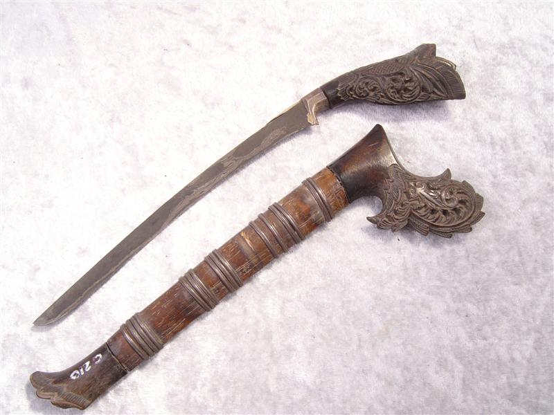

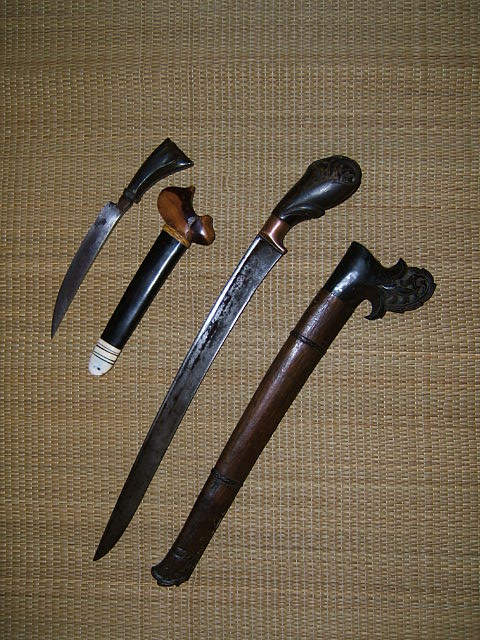

I wish someone had more information to offer on this weapon form; I have a very odd example which I'm not even positive is a Tumbak Lada.

I think your knife is made in the Palembang area, mid 20th C.
It resembles in style and material a knife I traded to CharlesS about 1 1/2 years ago (don't know if he still has it to show?).
I still regret that I let it go.

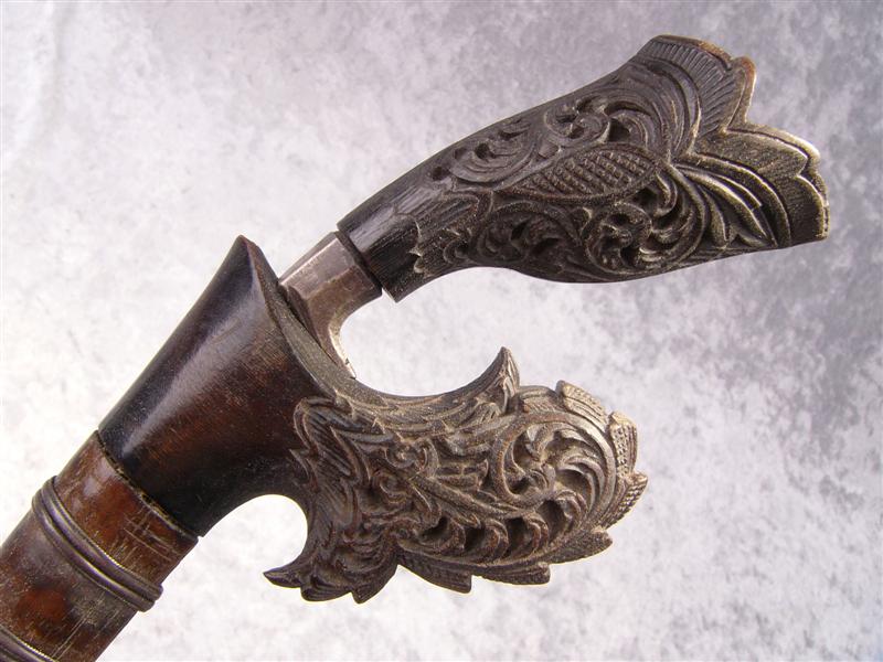

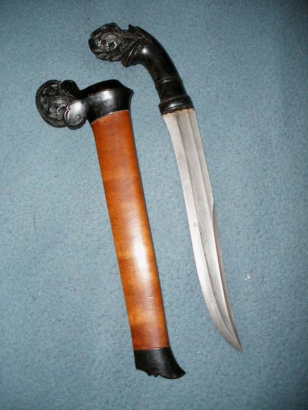

As I understand it a Tumok Lada has a distinctive squared off handle.
The name tumbok meaning "pepper" and "lada" meaning grinder. Here are some pictures of my little "Pepper Grinder."

Lew,
Your small piece, is a Siraui. While your larger piece is a Tumbuk Lada.
Bill,
Nice Tumbuk Lada you have there. Have some similarity to mine.

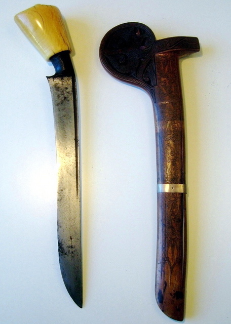

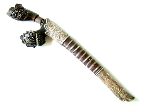

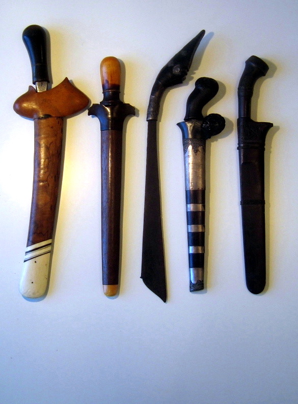

I don't think it's possible to always clearly draw the line between what is a Tumbok Lada and what is a Sewar. Also these blades show up in several regions and the reference works sometimes contradicts each other.
In van Z the blades he show as examples of a Tumbok Lada all are clearly that. But some of the blades in van Z that are examples of Sewars are "inbetween".
When I tried to classify before posting my examples I looked at three features; the upper sheath decoration (shorter and rounded vs longer and rectangular), the hilt (compressed and chubby vs longer and slimmer) and the blade (thicker and straight vs slimmer and curved).
I have enclosed two examples of what I believe is clearly a Tumbok Lada and a Sewar on this.
But what happens when a knife is 2/3 correct according to the orthodox classification?
Like my third example that clearly looks like a Tumbok Lada when in the sheath. But then the blade is more like a Sewar?
Either you can call them hybrides or you could classify them on which one of the two styles it's closest?
The problem is that very few blades I have seen do fit the strict classification. So if a knife has all the Tumbok Lada characteristics except the blade I think it's a Tumbok Lada, like f.i. Shahrial's example.
It seems as if the Tumbok Lada vs Sewar is more a collector's classification dilemma than locally used terms based on the contradictions in the original reference works?
Like the Tenegre, Binangon, Sundang, Pinuti, Bolo discussions going on within this forum on the Visayan weapons.

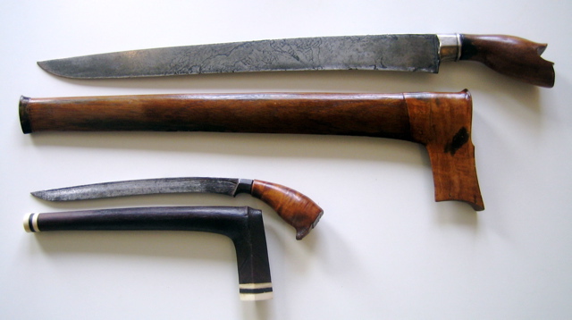

Hi Drdavid,
I think it's hard to say what your blade is?
It has the lenght of a small Golok but I would hesitate to call it that because of the blade's shape?
Goloks, as I understand it, are made primarily for cutting and yours looks like it's made primarily for thrusting.

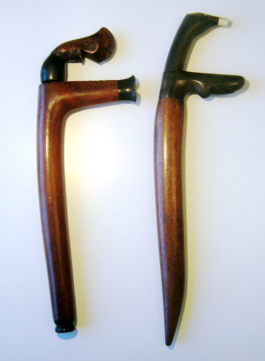

Another example is this blade.
It's 54 cm overall with a blade of 40 cm that could be used both for cutting and thrusting. Feels primarily like a slashing blade.
I haven't found out yet what it is?
Maybe a Golok Rembau (see Hill and van Z)?

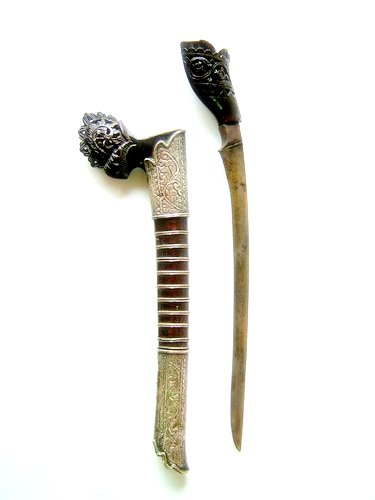

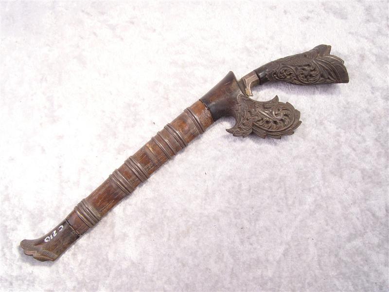

An example of a Karih from Sumatra. Note: shorter curled hilt.
A close-up of the blade.
A close-up of the hilt and upper-sheath, made of buffalo horn.

Posts: 6,441
Now this piece looks similar to the example showed in post #2.
What d'you think Alam Shah ?
Shahrial,
Isn't that my Karih in your post?
Or do you have its twin?

Rick,
Your blade does have its similarities, especially the profile of the blade.
Blade-design suggests that it might be a Karih, after all.

Originally Posted by VVV
Shahrial,
Isn't that my Karih in your post? Or do you have its twin?
Yes! it is, after a closer look. (Sorry I didn't know it was yours). Pictures are linked from Persada Pusaka auction gallery in KampungNet.
So you're the lucky owner of this fine Karih. Congratulation!
