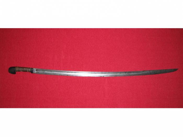

Here is an Afghani/Uzbeki Shashka that just ended.
We have seen them before , but here is just another example: Repetitio mater studiorum est ( repetition is a mother of learning)
http://cgi.ebay.com/ws/eBayISAPI.dll...MEWA:IT&ih=018

I saw this sword a while ago in a turkish auction site. The seller was claiming that this was not a shashka but a janissary sword. And saying that the grip still had the waxed ribbon which was used to prevent the slipping of the weapon from user's hand. Any opinions?

Default looks like a shaskha to me...

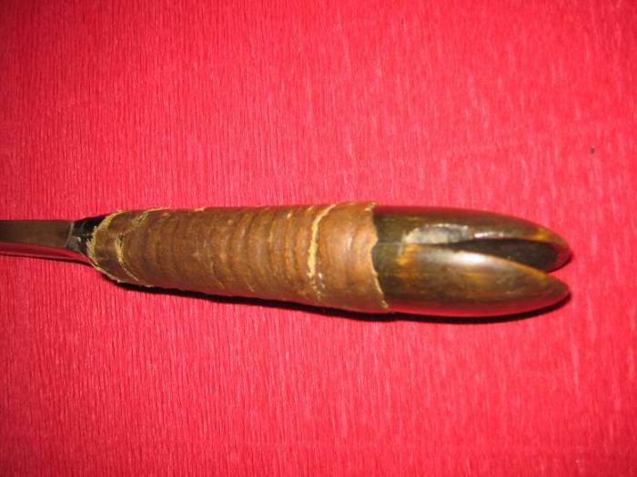

No, I don't think this is a "janissary sword". The hilt form is a classic Caucasian-style shashka. The plain horn is a simple type used by the commoners, not the chieftains. Also, this style of plain horn grip was officially adopted by the Russians on their "Caucasian pattern" enlisted man's shashka, Model 1904 (see Eugene Mollo, RUSSIAN MILITARY SWORDS 1801-1917, London: Historical Research Unit 1969, p. 39, also see A. N. Kulinsky, RUSSKOYE KHOLODNOYE ORUZHIYE: VOENNYKH, MORSKICH, I GRAZHDANSKICH CHINOV, 1800-1917g, St Petersburg, Magik Press 1994, pp 88-89).
However, the blade on this example doesn't match the 1904 regulation. It appears to be a military saber blade of common type from some Western country. Without dimensions and notes on markings, it's difficult to place it in terms of country or unit. From its style it looks 19th cent, thru early 20th. The slender profile, broad fuller, and prominent ricasso are key identifying characteristics as European/British/American, factory made of common military style.

Philip, thank you for the comments. Unfortunately I forgot to note down the measurements of the sword when I saved these pictures. His claim for it being a 'janissary' sword did not convince me, but you may never know. So I wanted to take some expert opinion. I have not seen the waxed ribbon thing before, which specifically attacted my attention to this piece.

Default waxed ribbon
Zifir,
This ribbon seems to be one of many similar solutions to the problem of the handle slipping in a sweaty or bloody hand. The braided cord winding on the handles of Chinese, Tibetan, and Japanese sabers, a similar thing on the hilts of the Burmese "dha", and various types of leather or rawhide winding on the handles of medieval European swords are all related to this.
I have a heavy Turkish chopping knife used by butchers or farmers, the handle is forged like a tubular extension of the blade itself. It is wrapped with a ribbon to improve the grip, and in this case, the material appears to be raw hide.
