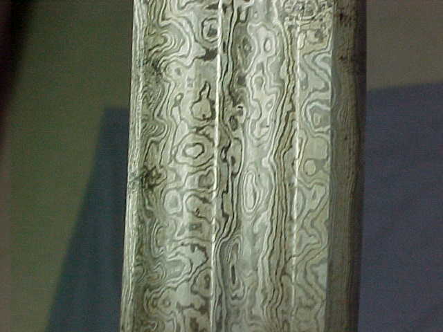

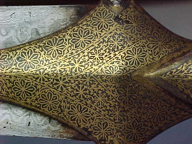

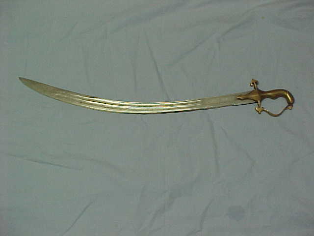

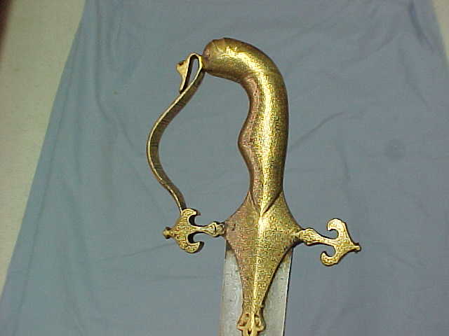

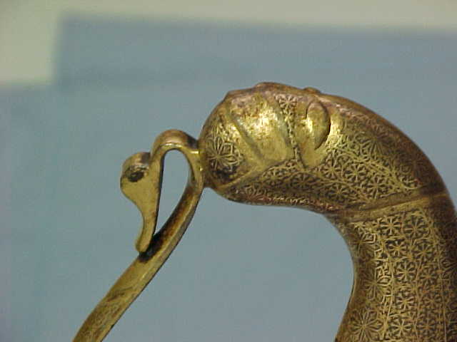

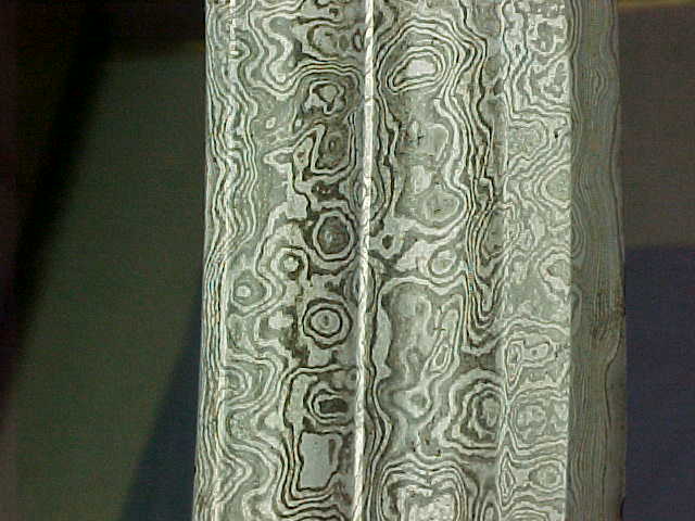

This is a very interesting Indian sword that I would love to get more feedback. The hilt is unlike any other Indian sword and has some interesting features to it. First is the swell in the grip. This seems very much like a Persian influence. The spatulate endings to the guard are interesting and seem common to Mughal period swords. The most interesting feature is the pommel on this sword. It is rather abstract but it seems to be "Tiger'esque". Also, the terminal ending to the knucklebow is an interesting "duckbill". I note two similar "duckbills" pictured in Elgoods new book on a cloth helmet owned by Tipu. Look at the top of the nasal protector and you have two of the exact same "duckbills" curved back down the slide. I have not seen this particular decor before so I have no pretensions that the "duckbill" is an exclusive decoration to Tipu related items nor do I have any pretenses that my sword has any association with Tipu however there are some interesting features worth discussion. Also, it has a big pattern welded kilij style blade with one of the boldest patterns I have ever seen. So, has anyone ran across similar hilts before? Look forward to the discussion.

Hi Rick,
Very nice saber. In the photos it looks as if the quillions and guard are welded on. They also don't seem to follow the flow of the rest of the hilt. perhaps they are a later add on? Could you post a closer picture of the quillion and guard?

If you have Egerton, in his section of arms of North-Western India Plate XIII item 653 is a similar hilt which is what I suspect your hilt started as. The guard is also similar. it will be nice to hear other opinions.

Ordinarily, each quillon has a sort of tang, and these are welded or soldered in between the two halves of the hilt.

One thing I cannot find corespondent are the unusual tholia (quillions) but our coleagues have seem to manage finding something similar even though without much data info, we see it is not an isolated case. I am fascinated by their beauty as I`ve not seen them before and I would avoid categorise them as a variation of the down-pointed quillions of the pulwar (puloar) swords.

This is outstanding discourse on this beautiful sabre, and excellent work with all the references cited and noted! It's always great to see observations supported with references as the 'mystery' unfolds. While I can't add much to what has been already clearly determined, I agree with the consensus of this being a southern form of weapon, and with Tipu-esque characteristics. The trefoil or fluer-de-lis form quillon terminals are interesting, and I would offer may be associated with Tipu and his father's close associations with the French and their influences militarily. From another perspective, I cannot help but notice the similarity of these fluerets to the upper part of the hilt of the 'anthropomorphic ' form of the chilanum ( Elgood "Hindu Arms & Ritual", p.175, #16.28 ) which is from Deccani sultanate early 17th c. possibly earlier.
Another question concerning the interesting material on the 'duckbill' form on the curled back knuckleguard. In a discussion with a collector some time ago, we were discussing this distinct feature as often occurs on Central Asian edged weapons, such as certain Afghan and other examples. These extremely stylized forms often seemed to resemble either nagan or dragon type figures, at that point not considering the 'duck' possibility, and he suggested these were something he called 'ice bird' but could not distinguish further.
Could anyone elaborate on what type bird this might be and significance on weapons there?
Radu: just noticed your post citing the swan, could this be what the reference to ice-bird might be?

Brian, if you look at the example of Tipu's helmet on p. 60, the nasal protector at the very top which extends above the top of the padding, you see the terminal ending which is a tiger. If you look at the downcurving projections from that tiger, they are elongated "duckbills". If you turn the book sideways when looking at this downcurving projection from the tiger head, I believe you will see what I am talking about.

And Jim, yes, I incline thats the case with ,,ice-bird,, definition (swan-neck is kind of personal definition, not to be confused with any scholar denomination, it just seem to me as the natural name, therefore I used it). Mughal gardens were home to gracefull, exotic large birds with opulent forms and plumage, peacock being absolute king but that was a male symbol, and in order to counterbalance the yin-yang in this sabre the knuckleguard swan (female and smaller in size and importance but nevertheless gracious) vs the pommel tiger/lion ( to put an end to RSWORDS dilema India is home even now but in the past even more to both lions and tigers ) as male symbol, larger in size. What is in red colour is my pure supossition without solid suport.
