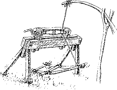

I'm wondering whether the original handles were 'turned' on a primative lathe.... you would only need something like this ... a pole lathe....easily made from local timber and cordage.... these were in common use in medievel Europe and Asia. The cord is wrapped around the 'working' piece, as the pedal is pushed down, the cord 'spins' the wood one way, The branch attached to the other end of the cord is pulled down (putting it under tension) By releasing pressure on the pedal, the branch 'springs' back pulling the cord and 'spins' the 'worked piece' in the opposite direction......then the operation is continually repeated. As the wood is spun it can be worked with a knife of chisel.....as on a 'normal' lathe.

Good point (like the one on top of my head ) Katana. There is nothing like a good lathe.

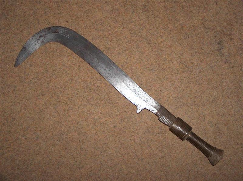

I finally found some time to finish this piece. Have a look :

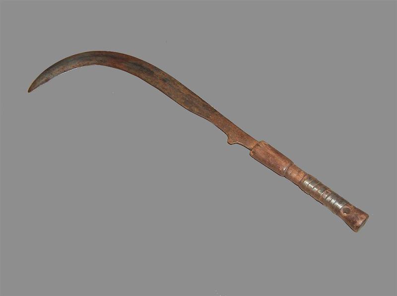

Freddy,this type of knife has a different handle than the Mangbetu ones.

pic forgotten,sorry

I think, you're right. Perhaps, when I have some more time, I will make another (more slender) one.

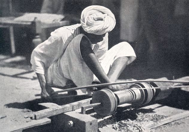

Here is a pic of a Sudanese lathe and craftsman.
