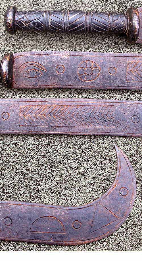

Mike:
Here are pictures I took today of the one I have. Dimensions are similar to the one that is the subject of this topic. Note that the talismanic symbols are partly different. The symbols on the other side of teh blade are the same. Cutting edge is at the bottom of the blade in each picture.
Ian.

Posts: 371
Thanks for posting the photos, Ian....I was hoping that you would.
The amount of variation in hand made weapons never ceases to amaze me, with the diversity in some so great that similarity is almost non-existant.
A couple of questions on yours, if you don't mind...1) does the black patina look artificial, as in some chinese pieces or natural, and 2) does the sharp edge appear to be or have been as a functional piece or only nominally edged vs flat on the other side?

Posts: 4,469
Mike:
The brass hilt has been intentionally blackened -- looks like paint, and some has rubbed off in places -- but I'm not sure about the blade. The blackening of some areas on the blade could be artificial. The sharpened edge could make the blade functional, and it may have been originally, but in its prsent state this one is unlikely to sever a head in a single blow.
