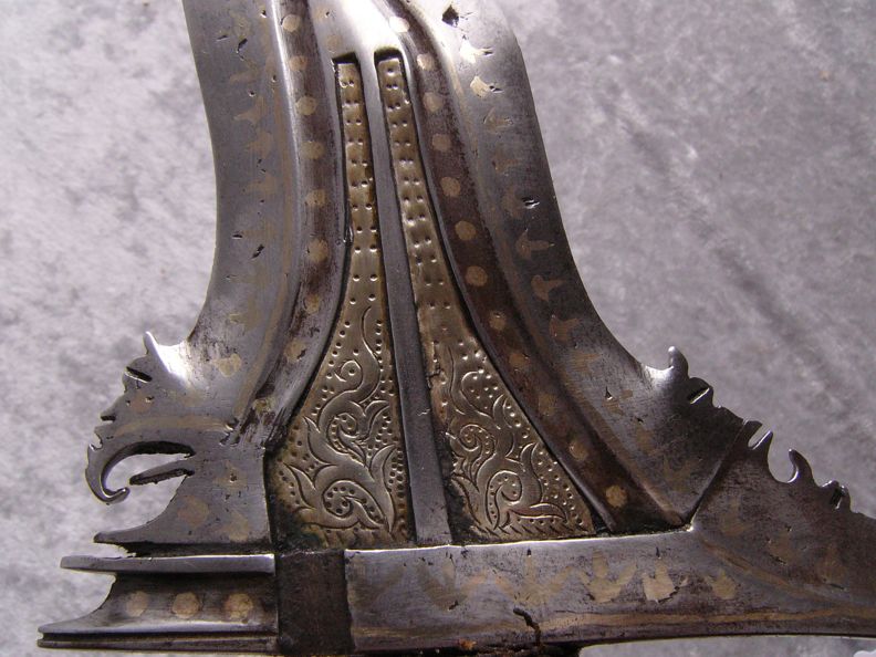

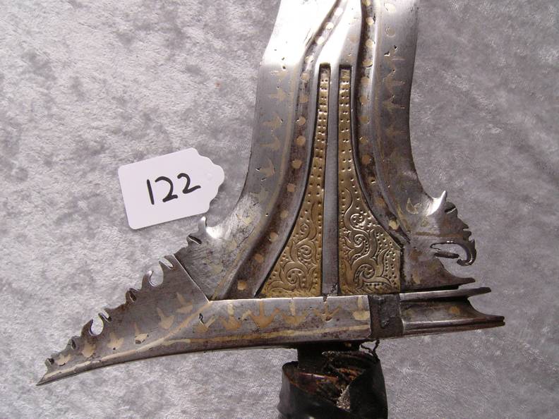

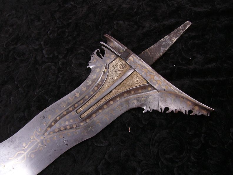

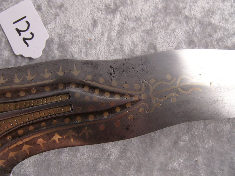

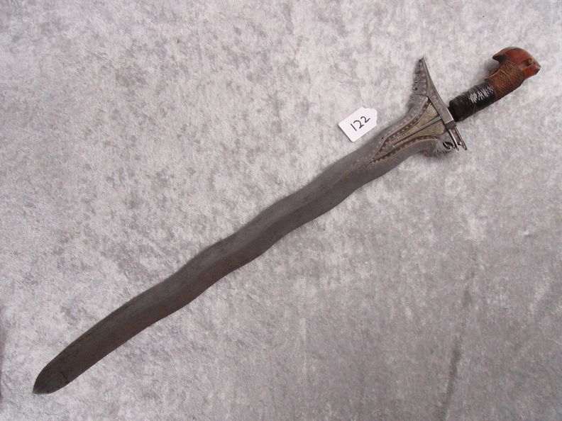

An eBay purchase. Seller says he found this in his attic when renovating a house that was built in the 1800s.
When I got it, the blade had a heavy coat of yellowish shellac, the handle was loose and the grip windings had come apart. I temporarily taped the winding so they would not further come apart.
I was of a very mixed mind, and still am, about how much cleaning I should do. It seems original, so should I leave it at that -- untouched?
However, I have begun and taken it as far as I currently feel like going.

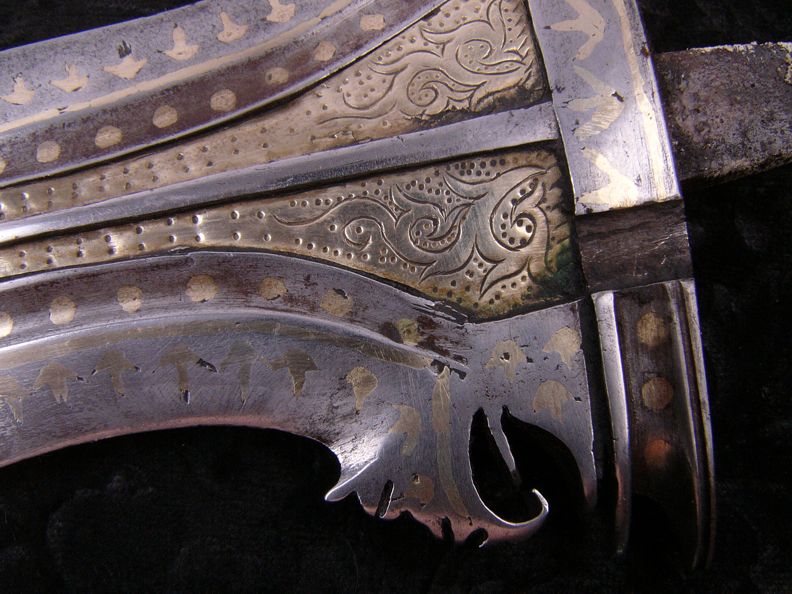

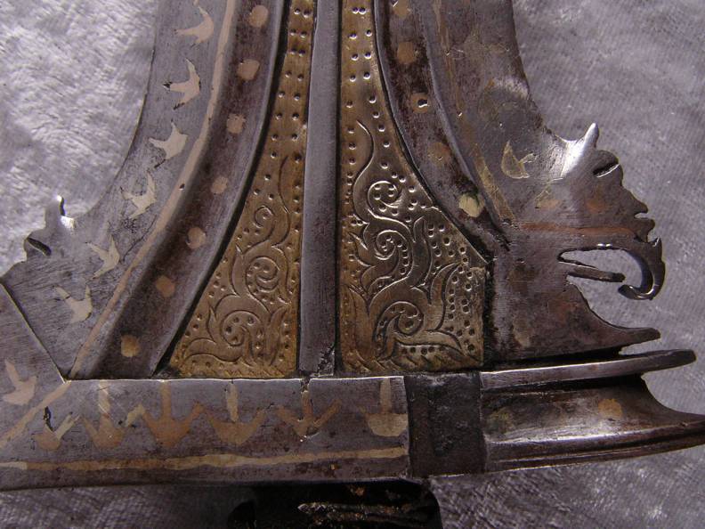

I like the inlay and it is some of the best I have seen on a Moro blade. I am getting it tested to see if it is a gold alloy. As I clean away the shellac residue, the more it looks like gold.
The handle is more plain than a sword like this should have, but I think it is original.
Your comments appreciated.

Bill, beautiful piece. The blade is definitely a datu piece with all of the silver. The grip I do question, although it is possibley that it is original with all of the fittings sold off. Thank you for sharing. I'll be the baka-baka was okired silver as well. Oh yeah, one other note, the hilt is on backwards.

Bill, beautiful piece. The blade is definitely a datu piece with all of the silver. The grip I do question, although it is possibley that it is original with all of the fittings sold off. Thank you for sharing. I'll bet the baka-baka was okired silver as well. Oh yeah, one other note, the hilt is on backwards.
Oops about the hilt. Just stuck it on for the pictures. Will reverse it. Was in a hurry.
BTW the light makes it look like silver, but the inlays are all a golden color.
The baca-baca that came with it is steel and has been here since the hilt was installed. Either the original owner fell on hard times and rehilted it a very long time ago, or he put all his money into getting the blade like he wanted it.
I like to think it was the last. As I understand it, these datu level pieces were very tailored to the customer from a smorgasboard of parts that then would be crafted into the finished piece.
Sometimes a customer could only afford some super high quality pieces. If it were up to me, I'd put my bucks in the blade.

Great that the blade was coated; saves you a lot of work Bill; but that's no guarantee the blade wasn't polished to another's taste before it was treated .
I have a really hard time believing the hilt is original though .

Are the inlays in the sogokan and pecetan cut panels/sheets fitted in ?

Bill,
Very nice, you have an excellent eye. I can see what you were saying about the inlays. I have to agree, the handle looks out-of-place. As I understand the Moro's, the handle and scabbard where the outward signs of rank. Many of the pictures in Cato's book bear that out. Which is why I was hoping the other thread with the inlay discussion would have went somewhere. The inlays and the twisted core blades seem to throw some cold water on the handle and scabbard being the signifiers of rank. Obviously some Moro's did go all out on the blades. It seems the inlay and twisted core would be a intresting area of study.
Congrats, Bill, that's really a nice kris!

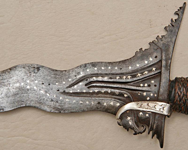

Does anyone recognize that special inlay motif with the 3 streaks?
I got a Datu blade of Maranao origin with the same motif (shown below) and would love to know their meaning!
Please let us know what it turns out to be. To me it does look a bit weird for coin silver; however, Battara has much more experience and stained silver can look quite golden (e.g. http://www.vikingsword.com/vb/showthread.php?t=1243)...
The kris shown below also came with an understated hilt which I believe to be a probable replacement.

Bill, I think it is possible that the steel clamp and hilt are a later replacement as a set. They may have been sold off when hard times hit. The blade would be where the soul of the piece resided and so that would be more important to keep.

Kai, the greneng on your sword look very Indonesian .
Old 26th September 2006, 10:38 PM   #11
Yes, this "back to the roots" style is probably one of the reasons why I like this blade so much; actually, all the scroll work is of high quality IMHO. However, I'm confident that it really is Maranao: 1. the inlay and also the scroll work seems very Moro to me; 2. it's a 17 luk blade (something unlikely to see from a Malayan blacksmith AFAIK); 3. origin.
Yes, appear to be.
Really look like gold, but it may just be wishful thinking on my part!
Need to take it to a jeweler and have him test the gold-colored material.
