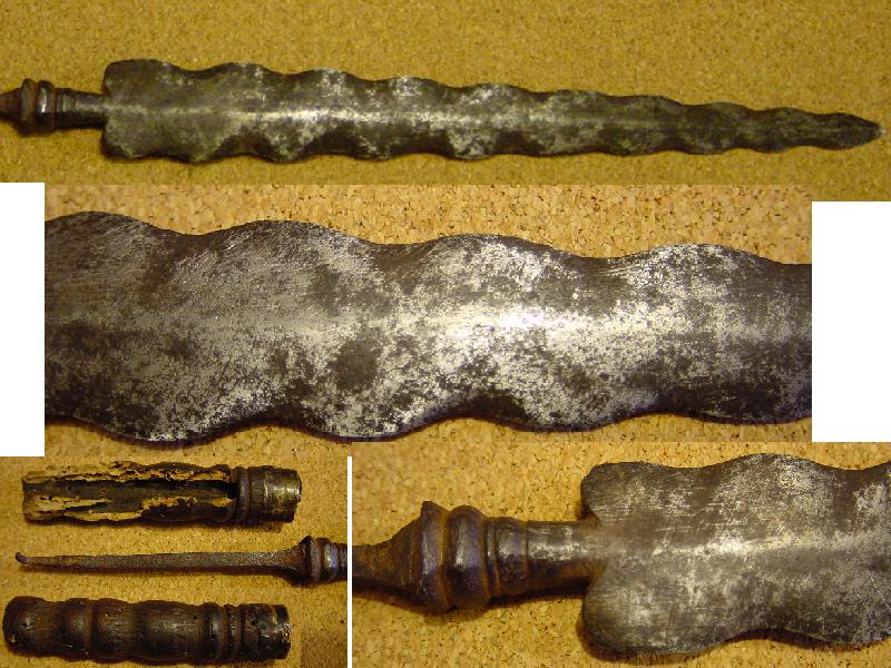

I have already shown this piece in the Forum. A Moro spearhead fitted with a dagger handle. Most probably adapted rather long ago, judging by the aspect of the brass collar and the hand turned wood grip, having just now come apart, destroyed by worms.
Could i say this is a 19th century blade ? and probably also the handle ?
My other and basic question is that i couldn't get it cleaner than what can be seen in the pictures, after enduring some tryals with WD-40 and steel wool.
Should i try and remove the remaining hard dark crust, still abundant at the edge concavities ? and should it be just a derusting or will it call for an etching ? any forging activity possible to show up in this type of blades ? is the vinegar treatment equal for either purposes, only depending in timings and procedures ?

I will certainly have another go with WD-40.
I didn't know about liquid epoxy, there is only classic epoxy adhesive around here ... i wonder if they have it in bigger cities, at specialized shops.
But i will have to see what to do. The remaining part isn't so much eaten, and is still solid, only that it doesn't represent a reasonable area to save, except the section with the collar, which is good all around. I am considering to only save the first one inch where the collar is, and have the rest replicated, and glued to the old part, getting back the entire shape.

I guess you've got two choices ; you can just try to stabilise the surface or you can polish the blade .
Polish takes a long time and much effort .
With all respect to Double D you're not going to make any significant progress using 0000 wool and fish oil .
If you opt to polish you will lose that 'patina' and I use the term loosely in this case . To polish you'll need wet/dry sand paper starting at about 120-200 grit ; wrap it around/or glue it to a square or round piece of wood maybe one inch square and wet sand the blade only lengthwise using finer and finer grits until you get into the superfine grits (garnet paper) that auto body shops use ; a lot of work and probably a few cuts later you can final polish the blade with a wheel and rouge/tripoli if you wish.
Then you can etch it .
For the hilt; you can have a woodworker turn you an exact copy from some nice dark hardwood.

I think i will follow the polishing procedure, or as many steps i can come through.
Etching will wait for the next stage, if it will be worth doing it.
As for the handle, one of my coleagues at work has agreed to make a replica in the factory lathe. Pitty the original brass collar is not solid enough to dismount and fit onto the new grip.
Thanks again

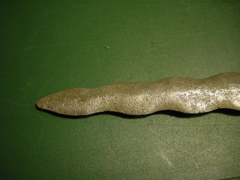

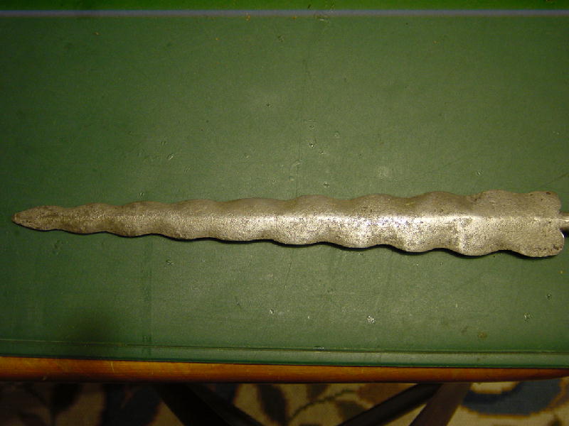

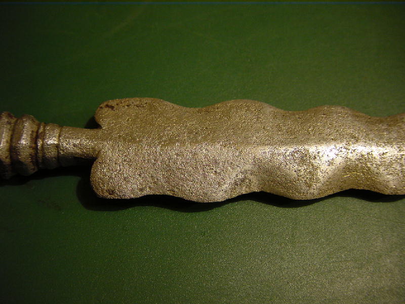

Well, i was waiting for the new handle to be made ( after tomorrow? ), to show the whole thing as it ended, but i will wait no longer.
Please don't shoot me . I dont how to call it ... if just topographic ( Rick's term well interpreted ? ), or actually excavated .
I have had e-mails from Justin, which have given me the courage to show this blade as it is now ... for i was afraid it was frightning to collectors..
Punishments are wellcome.
