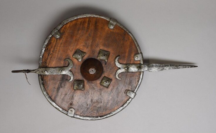

Hi all,
I picked up this shield from auction a few years back out of intense curiosity. Such an imaginative design, but is it practical?
Online research seems to place it from East India, with the people of Santal, Santhal or Sontal.
Mandarin Mansions offered up some fascinating insight into a similar shield of concave form, with some suggestion of it being a bullet stopper.
I've not found any pictures of a parry shield exactly like this one, other than past auction pics of this particular piece (it seems to have done some travelling).
I didn't have to fight hard to bag it at auction, which surprised me as although it's clearly not fancy, it's a pleasing example of combination/imaginative arms.

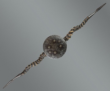

You have a nice complete, and spiked example there.
Here is mine for comparison.

Thanks for posting Battara.
Could I ask - is your example convex? Does the rim protrude out beyond the centre?

Oh yes. Would have an interesting effect on attacking swords.
These are rare, and yours is a rare variant of the rare.

This is an absolutely fascinating example! and would seem of course perhaps to be 'one off' but for Battara's example posted (Thank you Jose!). This suggests that there must have been a certain convention for shields/bucklers with these curious added features.
Notable (and seen on both examples) is the hook, which rather than being a potential 'weapon' such as the spike and knife, would be perhaps thought of to snag or grab something, i.e. a weapon? This notion , while often suggested toward weapons features for such purposes, has not as far as I know, has not been proven viably.

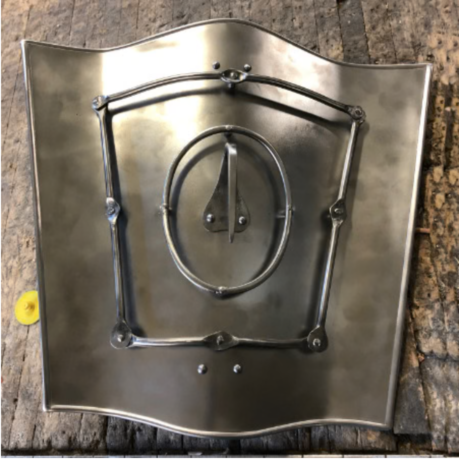

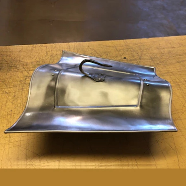

Reminds me of some of the 16th and 17th cent. spiked and hooked targes and bucklers in Western Europe.
Any examples? Not familiar with bucklers etc and the hook seems odd.

https://www.arms-n-armor.com/blogs/n...ers-and-targes

For our records:

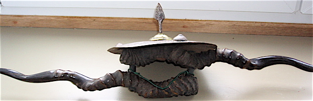

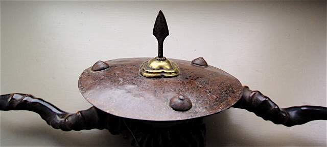

Posts: 1,657

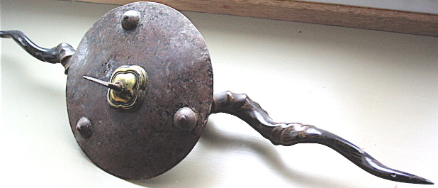

Hi,
My Madu style of buckler. Quite a basic example but on handling it I can see the usefulness of the concept of a small parrying shield with added pointy bits.
Norman.
Old 25th April 2026, 07:23 PM   #13
Posts: 10,862
EXCELLENT EXAMPLE!!!
Would this be Rajput ? or can we be that specific? I like the way these horns are sort of stacked.
Hi Jim,
Apologies for the late reply, been away for a while. I've never been successful in determining an exact answer. Needless to say Jens would be the one that might give a clue but I haven't seen or heard from him on the Forum for a while. Hope all is well with you.
My Regards,
Norman.
Old 2nd May 2026, 08:14 PM   #15
Posts: 10,862
Hi Norman,
Thank you! Yeah, I think everybody is pretty busy these days, me too!
Actually it would be hard to assign any specific provenance to group or region on most Indian stuff with all the cross diffusion, whatever the case, yours is one of the most remarkable examples I've seen. Thanks again for posting it.
