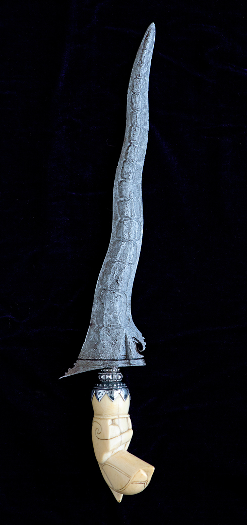

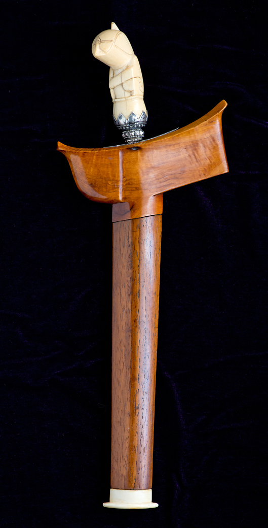

Hi All,
My wife gave me this very nice 3 luk Bugis keris with its very well carved, ivory Java demam hilt and silver selut for my birthday. I have four questions about the sheath which appears to be fairly recent. I know that I will need to make a small modification to the throat in order for the blade to seat properly but the size of the wranka appears to be proportionate to the hilt.
1) Is the sheath (which appears to be Sulawesi) appropriate for a Sumatera hilt?

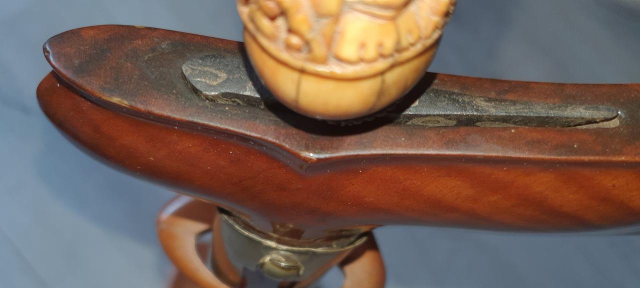

Hello Rob,
Like Gustav stated, you have a Malay keris, the handle will be from hippo ivory. And please don't shorten the gandar, it would be a great mistake. I would polish the scabbard with a good oil, it will look much better after this. And I wouldn't replace the little damaged buntut of the scabbard with bone of some sort, I would use ivory or wood instead.
Old 8th March 2026, 05:33 PM   #5
RobT
RobT's Avatar
Posts: 649
Default Requested Photos & Advice Taken to Heart

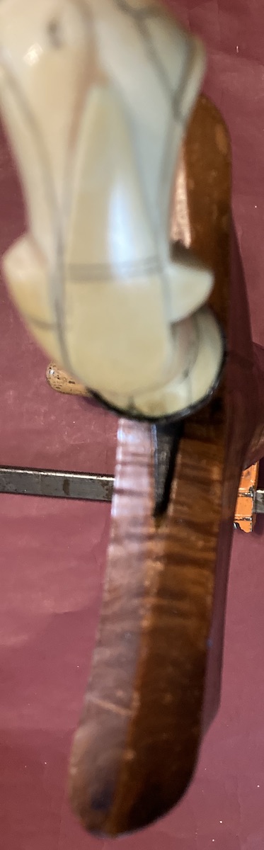

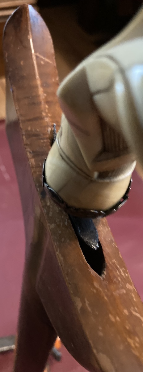

Gustav & A. G. Maisey,
Here are the pictures of the blade seated in the throat. As you can see, the aring side is an exact fit but there is a lot of room in front of the blade on the dagu side. Ordinarily, I wouldn’t be too bothered by the ganja sitting slightly proud of the wranka but in this case, the width of the of the blade just below the tang is slightly wider than the throat. This has made that area a pivot point so that the blade rocks back and forth like a teeter totter when seated. I think that widening that area by 1/64” (.0396875 mm) or less will allow the blade to seat solidly in the sheath. A light pass or two on each side of the throat with a fine cut riffler file should do the trick. I have enough woodworking experience to be confidant about doing this properly. Unfortunately, I don’t think there is anything to be done about the gap in front of the blade on the dagu side.
Sajen,
I am very happy that you and Gustav agree that the gandar should be left as is. I was very loath to cut it down in the first place and was only willing to do so if it were absolutely necessary. Since shortening the gandar is no longer needed, I think that repair of the existing buntut is preferable to replacement.
Sincerely,
RobT
Old 8th March 2026, 05:46 PM   #6
Yes, you are correct, it's not the original scabbard for the blade.

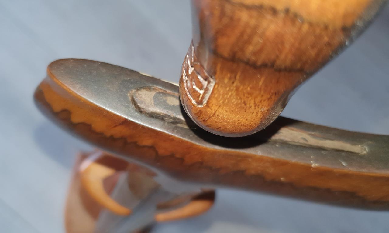

Hello Rob,
Here are two pics from a Malay keris where the scabbard isn't original to the blade and someone, I guess in Malaysia, filled the gap with resin or like David said with shellac.

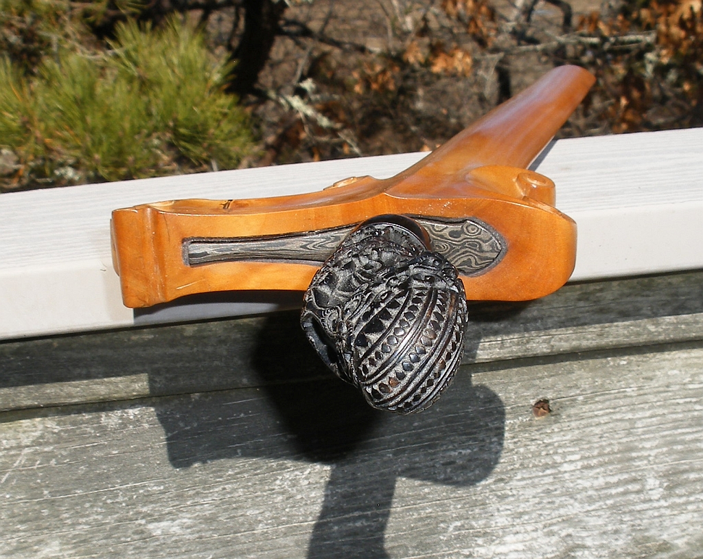

Here is an example of a small Surakarta Pasupati fitted to a normal size Surakarta ladrangan wrongko.
Perfect for dress purposes, and nobody knows what the blade is like.
Sorry for the sub-standard foto, pressed for time.

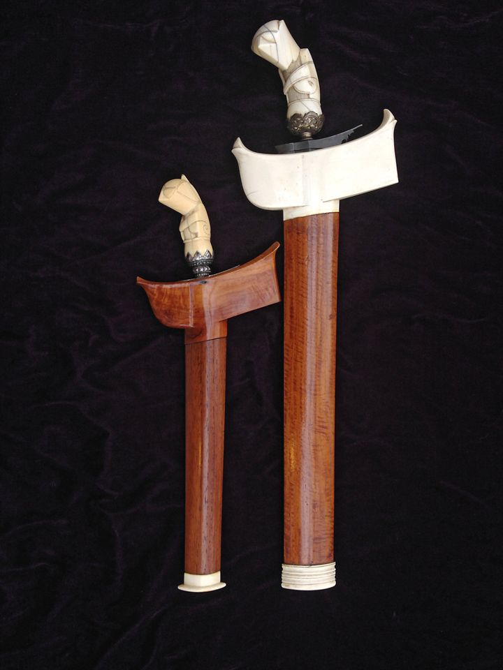

Here are two examples where the sheath was professionally adapted to a blade. By both scabbards was a gap in front.

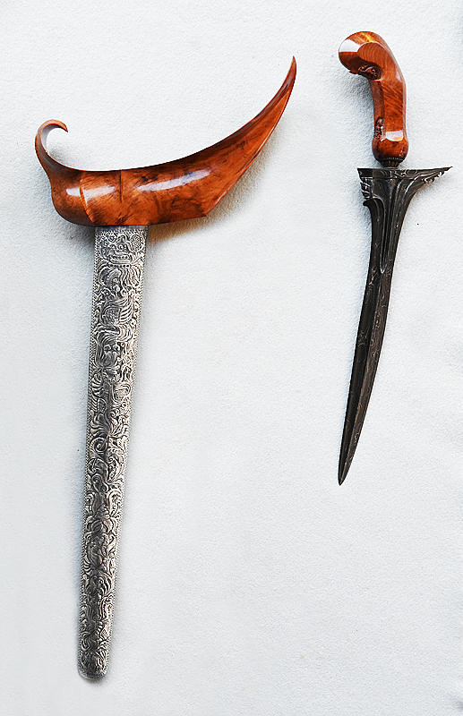

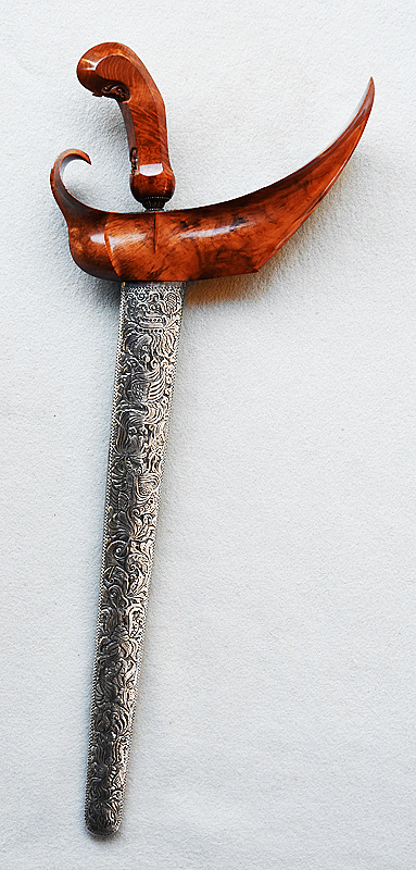

Here's an example of a keris fitted to a sarong. The gap has been lined and the blade properly fitted. In this case the filled area is dark and is not really jarring to the eye as the keris itself is a near color match.

Rick, the way in which your scabbard has been adapted for use is a style that some m'ranggis in Solo (Jawa Tengah) call "wayang" style, yours looks as it it has been done with some sort of compound, but the preferred way to do this is to enlarge the gap by about 1/8th of an inch, & then very neatly fit a wooden plug in a contrasting wood, this new wood is then inlet to take the new blade.
The end result --- when done well --- is pretty impressive.

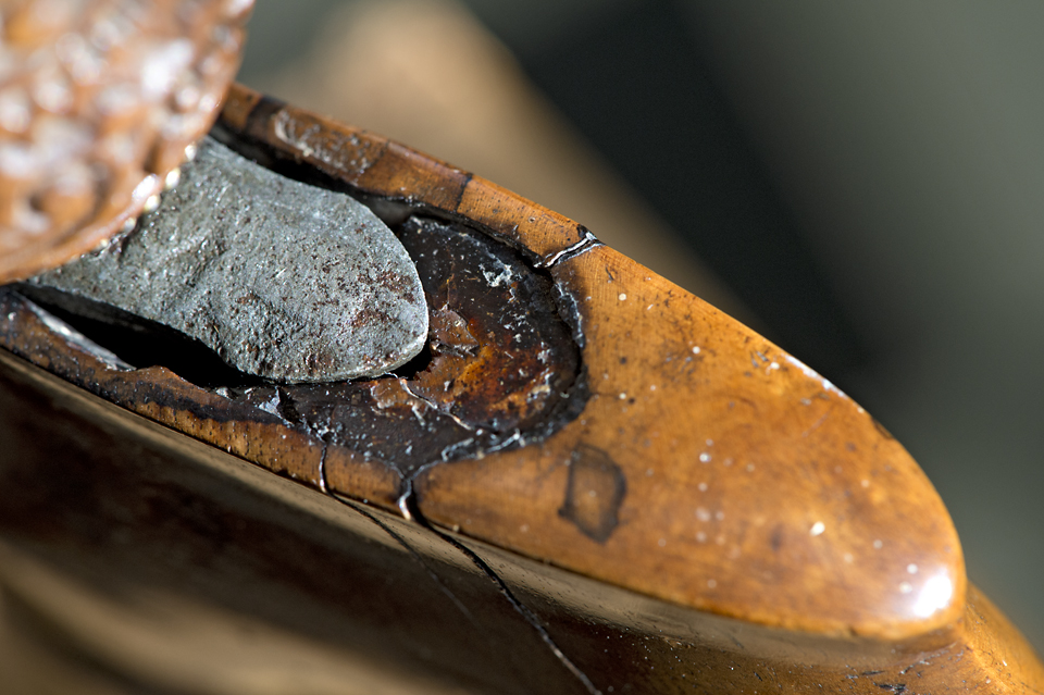

I have cut the wooden plug for the dagu side and it fits well. Now comes the really hairy part, matching the color of the plug to the sheath. This will probably take about a week as I test various agents on pieces of scrap wood and wait for them to dry fully.
The buntut has been covered with a rather opaque stain. I have examined the chip with a magnifying glass and it appears for all the world to be some sort of poplar. The bottom of the buntut (where the stain is less opaque) shows a figure like poplar also. Ideally, I would like to fit a wood piece to fill the chip but that looks like it might be tough to do. I’ll give it a shot but, if I fail, plastic wood will work.

I grew up on hand tools, not electric, & for fitting a blade to a scabbard I prefer a scraper to remove excess material. The method is to smear fine oil onto the gonjo & scrape away the material that the oil leaves a mark on.
In real life, the keris that are worn by people in Bali & Jawa are often less than perfect in their dress, they get a bit knocked around, the wood gets scuffed & bruised, pendoks get dents, ordinary keris often look less than perfect.
A chip such as the one to the buntut of your keris could most certainly be easily repaired, but my choice would be to leave as is and to make it look like old damage.
If I felt compelled to repair that little chip, I would square the irregular surface of the chip to permit a tight, straight-line joint. Then paper off the entire buntut & hit it with black japan spirit based stain. I would use tinted 5 minute Araldite as the adhesive, make the patch oversize reshape and paper back. Araldite can be tinted with artists powder colour. I would not use plastic wood. Ever.

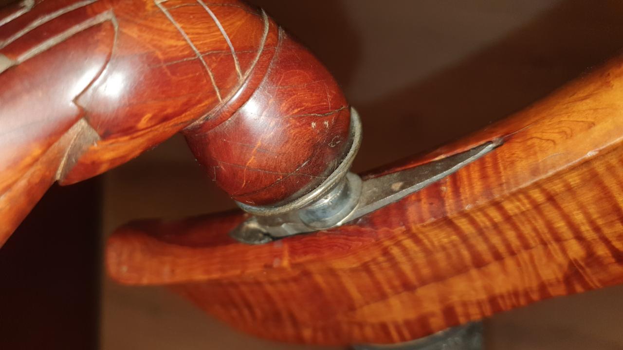

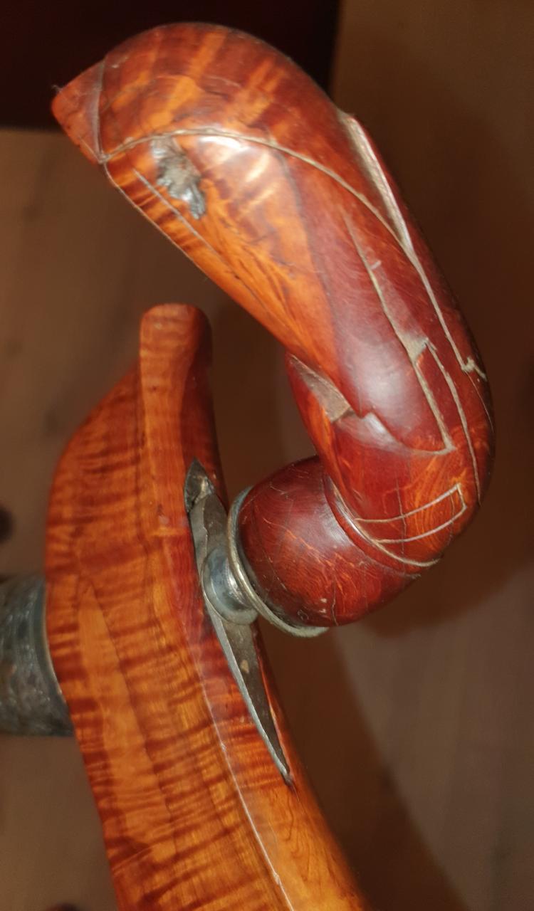

Here are photos of my efforts to modify the sheath throat and repair the buntut. Thanks to all for your advice about what and what not to do with the sheath.
Sincerely,
RobT
Old 20th March 2026, 11:31 PM   #24
Hello Rob,
Very well done! Congrats, a good repair/restoration.
Old 22nd March 2026, 02:38 PM   #25
Posts: 7,298
Nice job Rob!

Rob, for a first attempt at this sort of modification, I consider that you have done a pretty fair job.
However, if you are prepared to spend more time on the job --- as your remarks do seem to indicate --- I suggest that you have a look at Post 16 & Post 17.
If you were to completely line the mouth with a contrasting wood, this would turn the minor defect of poor fit into an enhancement.
Yes, it will take time & care, but it will look a lot better than just taking up the space in front of the gonjo with a piece of wood.
I have found that the easiest way to do this job is to fit a plug of wood into the mouth of the wrongko first, I use tinted 5 minute Araldite as the adhesive.
The mouth of the wrongko can be enlarged a bit first but be careful to follow the shape of the gonjo.
After the new wood is in place and the adhesive has cured I drill a hole in the middle of the plug and line that hole up with the tang of the blade --- you place the blade onto the wrongko so that the gandar will accept it, & the top of the gonjo is level with the top of the wrongko (gambar, atasan).
Then you just gradually enlarge to hole you have drilled to accept the gonjo, you smear light oil onto the sides of the gonjo & just scrape away where the oil shows on the new wooden plug.
I prefer a dark wood for the plug, black ebony works well, but it is not all that easy to work with.
