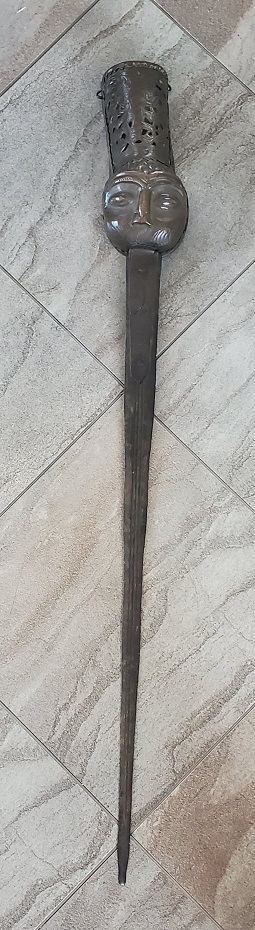

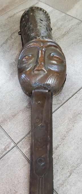

I have at least one similar, with the brass/bronze ferrule/guard and a nicely forged blade.
I'll see if I can't takes some pics soonish, but in the mean time, here's one cropped from a family photo.
Have fun,
Leif

Apparently today is "soonish"
