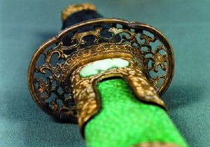

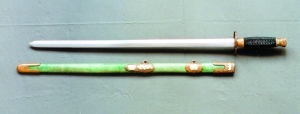

Hi all,
I was wondering if anyone had any information on this particular Jian?
It is interesting how similar the guard looks to a Japanese tsuba. Any info or better pics of this particular sword or similar would be greatly appreciated.
Cheers
Jason

Jason,
The pictures posted are from this article...which provides some information...if you need more I would email the author, Philip Tom.

Default Jian with saber-type handguards
This sword is one of a small number of jian, dating from the Ming through Qing Dynasties, with flat, discoid guards patterned after those characteristic of peidao (sabers). Many of these rare forms are sumptuously-fitted weapons, perhaps the most well known is one with gilt bronze fittings, attributed to the Qianlong Emperor, now in the Musee de l'Armee, Paris. Occasionally one encounters a heavy example of rustic manufacture, with very simple, village-made iron fittings, put together during the 19h cent., sometimes with a much earlier blade, others having a completely "home-made" appearance.

You wouldn't perchance have any close ups of the tsuba (sorry I don't have correct knowledge of Chinese swords nomenclature)

Hi, Jason
Sorry I don't have pics of this, the sword is in a private collection and I don't have access to it. Those flat plate-like guards are called "pan hushou" (plate/platter protect hand is the literal translation).

As Phillip mentioned the disk guards are slightly more common on more rustic examples. I have two, one put together in the 19th c. with an older blade. The other is likely older, and the guard was made at the same time as the blade. The 19th c. version does not have a tapering handle like most jian, but was put together like a dao with a jian blade, while the older one has a tapering handle more typical of jian.
Even among rustic weapons the disk guards are not common. I would estimate their frequency at less than one in a hundred. Interestingly, dao with jian type guards are fairly common. On some, such as the dadao, it is somewhat unusual to find a disk guard.
I suspect that the extra protection of a disk guard was not worth the pain of having it digging into the person carrying it. So we rarely see it on dadao carried on the back, rarely on jian carried around as status items, and more commonly on rustic jian that were probably not carried on a regular basis.
The disk guards are almost ubiquitous on military dao where presumably the extra protection was worth the added effort.
